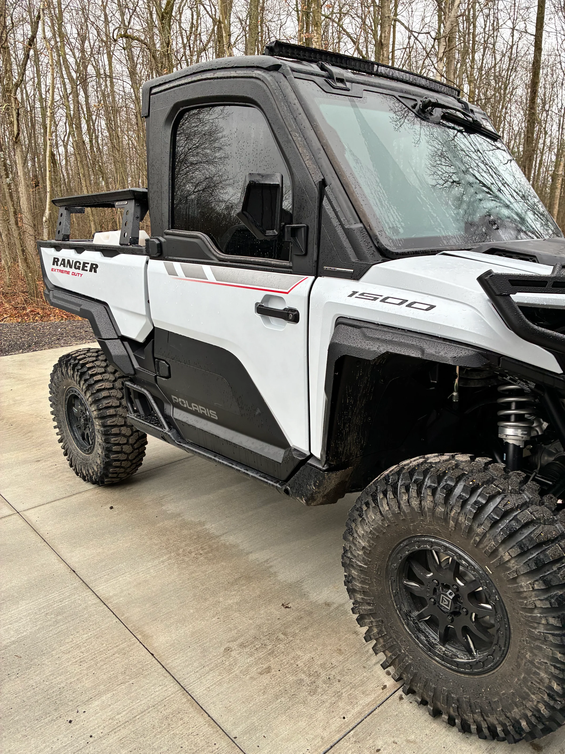

I have them on our machine it came from dealer this way . With 32s on it its 19 inches high .
Agree, it didn't look like much more than an expensive spacer to me. Since Highlifter is a respectable company, I thought maybe there was more to it than I understood.
We have them on ours came that way . I never was in one before so I cant say how they ride . All i know this rides like a dream compared to our can-am ! I do know stock height to floor is 15 inches ours is 19 inches with 32s. downside when you hit a big enough bump you hear the spacer slap from the spring compressing .
