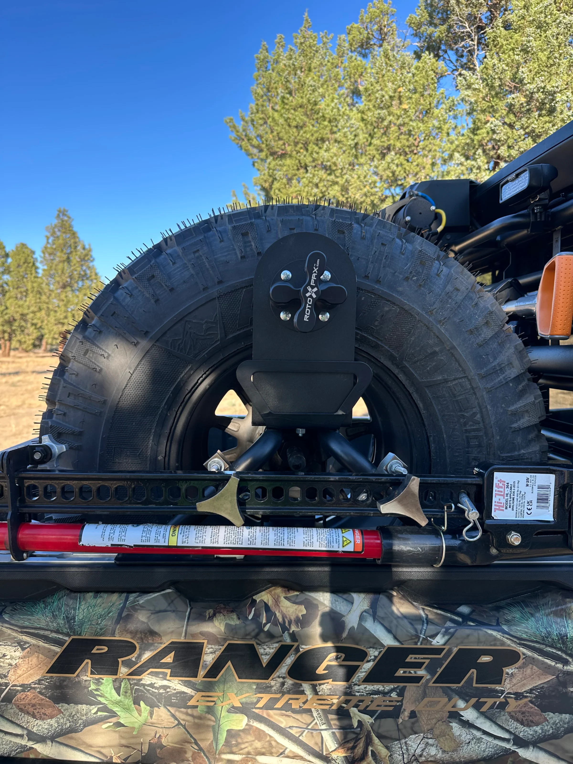

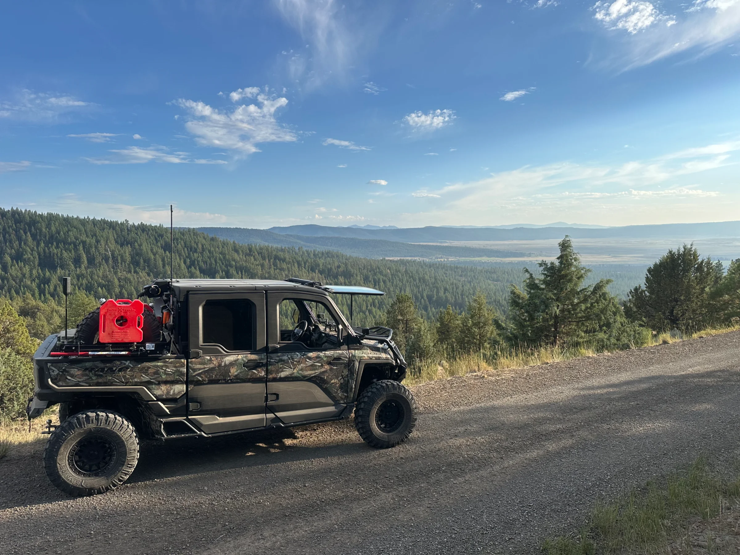

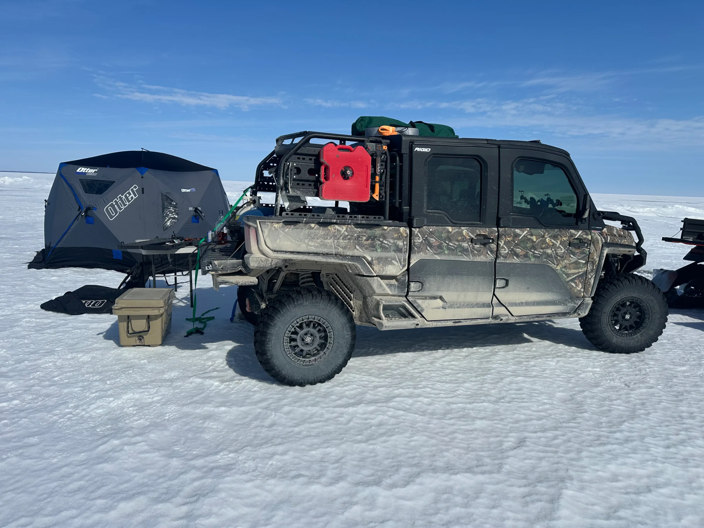

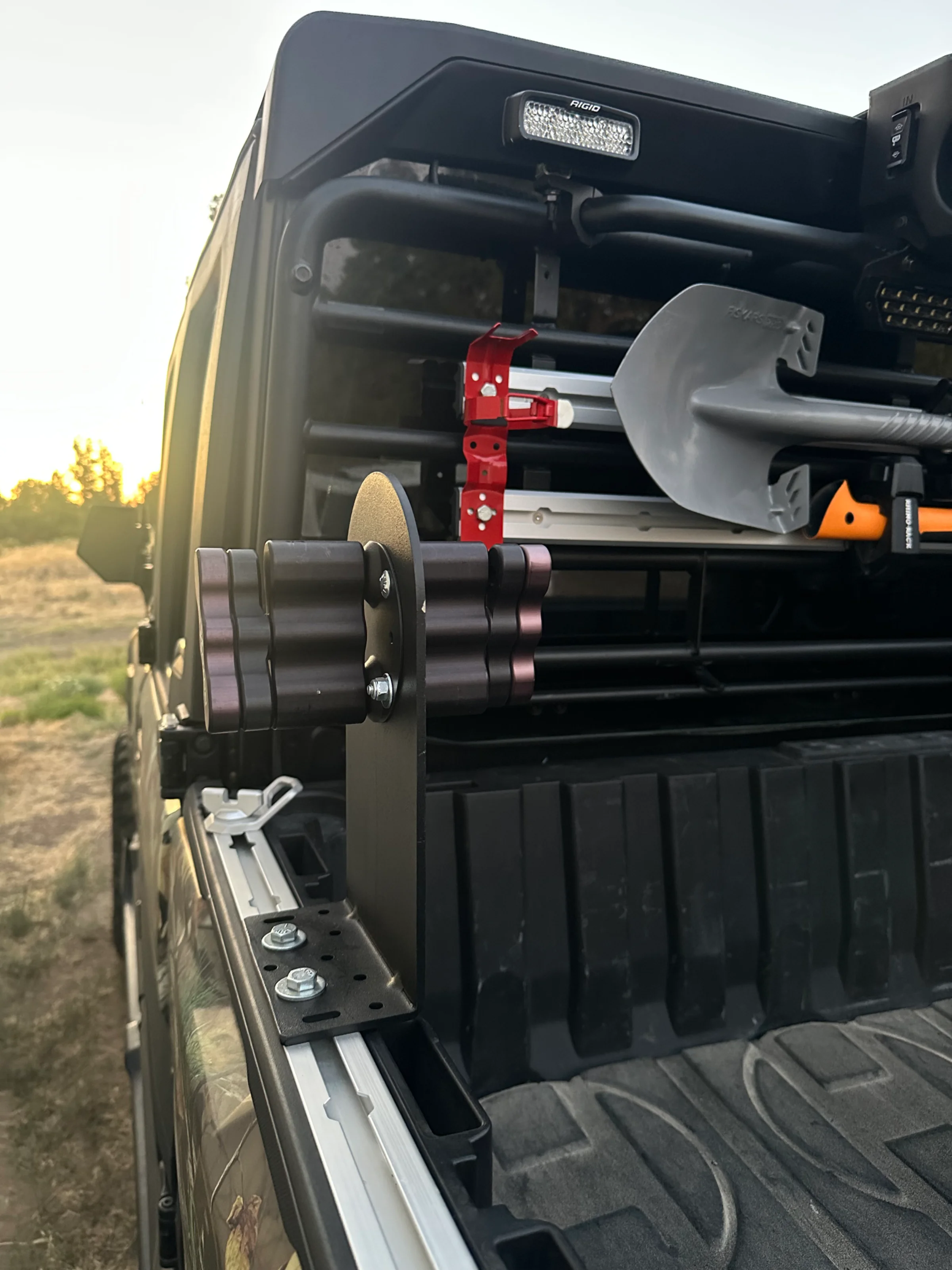

There is brackets that I’ve used, and bolted on the rotopax mounts to. I have one double and one single attached to my spare tire mount. I’ll look for photos.
Here is the link for the brackets. I drill out my own holes, and use either 1/4” or 3/8” bolts and strut nuts. I usually need to trim down the length of the bolts so they don’t bottom out in the rail. I also trimmed off the base, so it doesn’t stick out past the bed rails. I will admit that, I can only use the 2 gallon container on the outside mount on double bracket. The inside and spare tire one, I use the 3 gallon gas containers. Then I just purchase whatever mount I want to use.

How did you do your spare tire mount with the high lift jack attached?
If you’re asking me, I used the clamps that I attached a link to. They basically just clamp onto the tubes of the spare tire mount. Then the threaded rod goes through a hole of the jack and use the wing nuts to tighten and secure.
