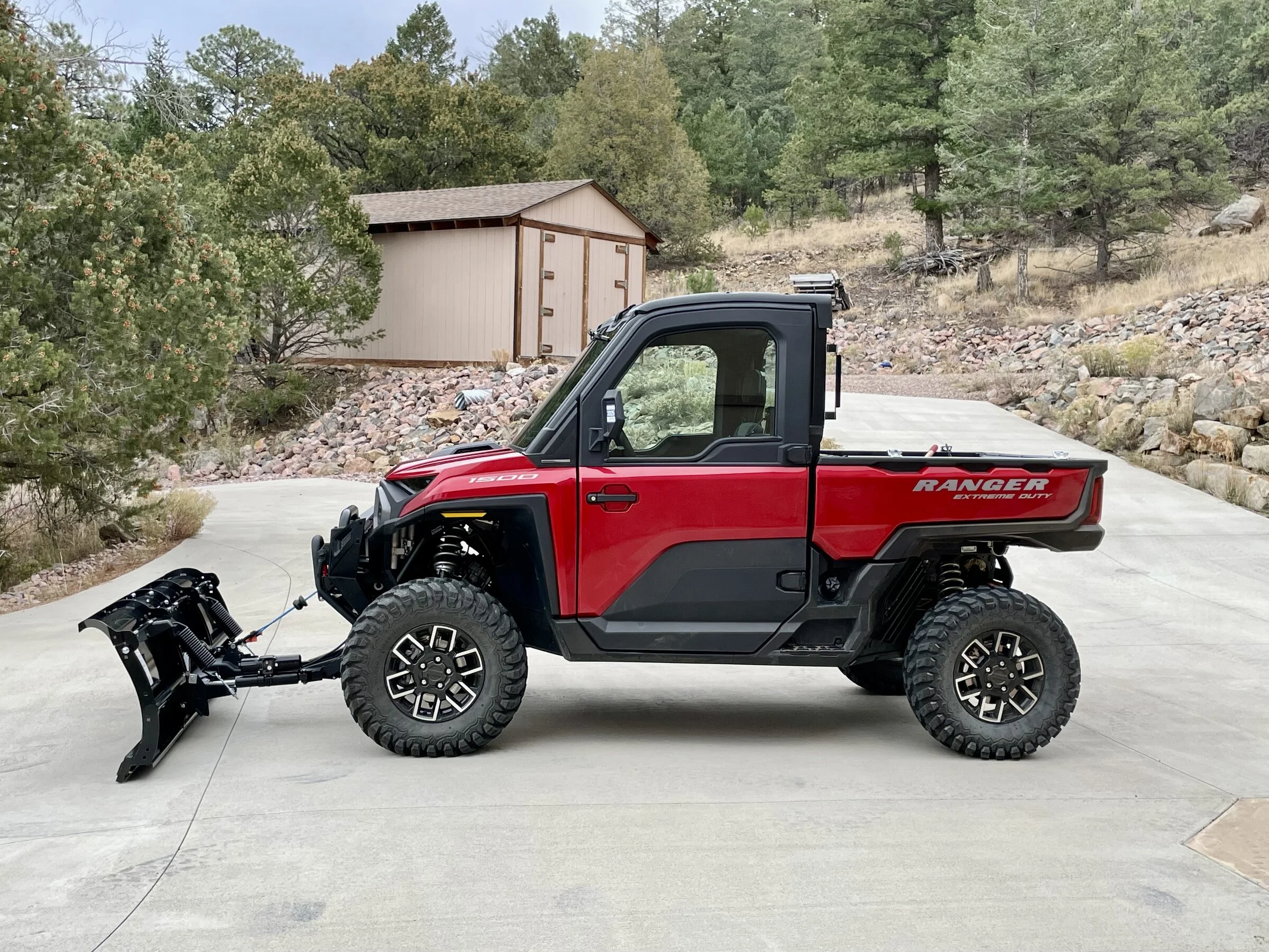

While waiting on a proper hydraulic lift, I ran the winch line through a snatch block mounted to the plow and attached the hook to a pair of looped straps around the bumper. See photo below.
You have more faith in that top bar than I do. The bolts that hold it on are just thread cutters into the bumper and doubt that bar is very thick. I could be wrong and hope I am, but it just seems the weight of the plow might be more than what the bar could support long term. That said I like the set-up, and I bet it functions great.
I want to do it this way until Polaris finally gets a beefier hydraulic lift unit available. I’m thinking the four bolts that go in nearly horizontally would have to shear for failure. Our first snow is late this year, but we’re about to get a bunch which will be a good test.

I decided to not temp fate. I can’t use the rod that came with the plow for connecting the winch hook to. It is too long and won’t allow lifting the plow high enough. So I am using a stainless D-shackle in its place. So winch line now goes straight from winch to that shackle and it raises plenty high. That also allows the auto stop feature to work.IMG_6167.webp
I decided to not temp fate. I can’t use the rod that came with the plow for connecting the winch hook to. It is too long and won’t allow lifting the plow high enough. So I am using a stainless D-shackle in its place. So winch line now goes straight from winch to that shackle and it raises plenty high. That also allows the auto stop feature to work.View attachment 1431
All though I like your Enginuity with the snatch block setup, I had the same problem with the rod being to long. I cut out several inches out of the middle and had a shop weld it back together. works grate now.
Can you post a picture of this?
So I’ve been following this thread,and I’m getting the assumption that the winch doesn’t allow it to lift high enough, the vertical hydraulics don’t have the capacity and the tilt hydraulics aren’t long enough to tilt far enough to the right? Is all this correct?

Yes I think
You’re spot on. But I can’t confirm it. We don’t have snow yet. I did add a rubber scraper to mine.
I’m picking up my blade and mount tomorrow with the 2 sales that Polaris has going on. I didn’t want to pass it up.
So I don't know about the hydraulic lift or tilt but I have no problem with the winch lifting my plow high enough. I don't know if my arm is different than some others here or if some want it to raise it above their hood. I've never measured how high it goes but I'm guessing the bottom of the plow is 16" off the ground or so which is more than enough for me.
