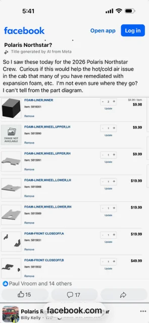

I apologize for reposting about this but i can’t find the old post. Someone mentioned a “close off “ kit they installed on the front of the 26’s to cut down on air leaks. can anyone provide a part number for this ? i asked my dealer service guy and he isn’t finding anything. Thank you
I just posted this in the other thread. I think this is what they are referring to? My 2025 has these installed but it was a late 2025 machine.
  • Polaris Ranger 1500 XD Northstar  Put together a couple more videos to show what Polaris has ...webp

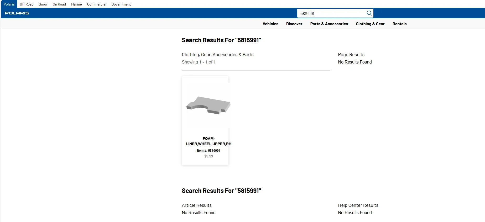

They are supposed to be the Polaris part numbers from what I researched. I put the part numbers in the Polaris parts finder and they show the part.
The original Facebook post with the parts list above was posted by me. What I would really like to find is where all this stuff attaches? I could not find any installation instructions and some of the pieces are not intuitive at all. These are all listed in the 2026 model year parts list under a section called Front Foam in the body section of the parts diagrams. This link should take you to it. https://www.polaris.com/en-us/off-road/assembly/?modelId=R26X6W1RBJ&assemblyId=593051
