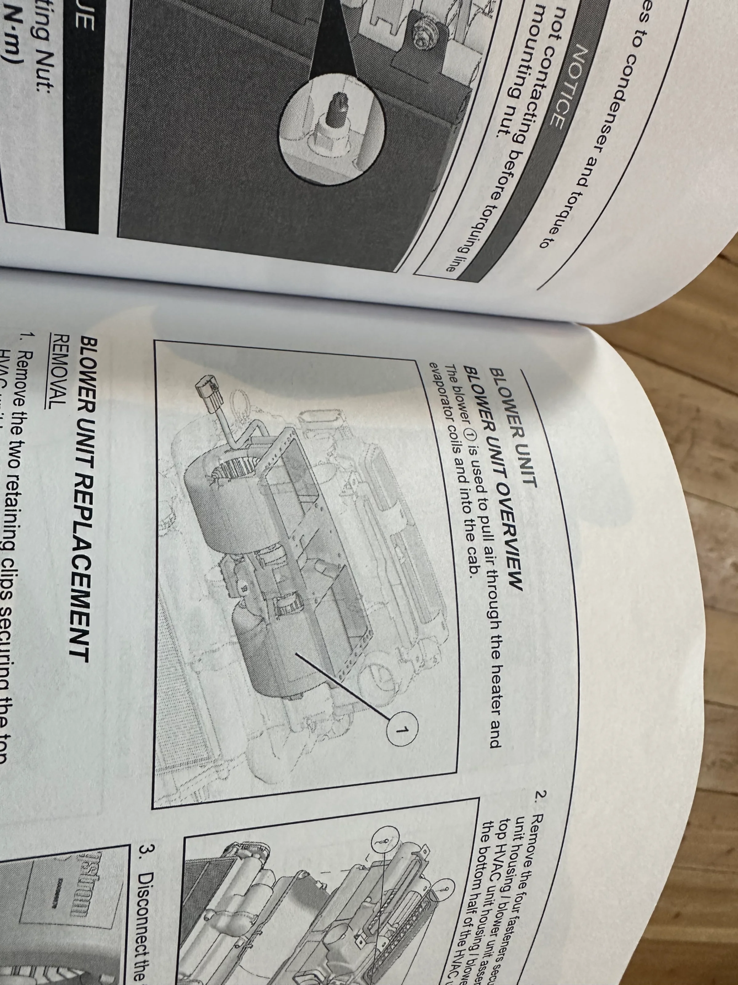

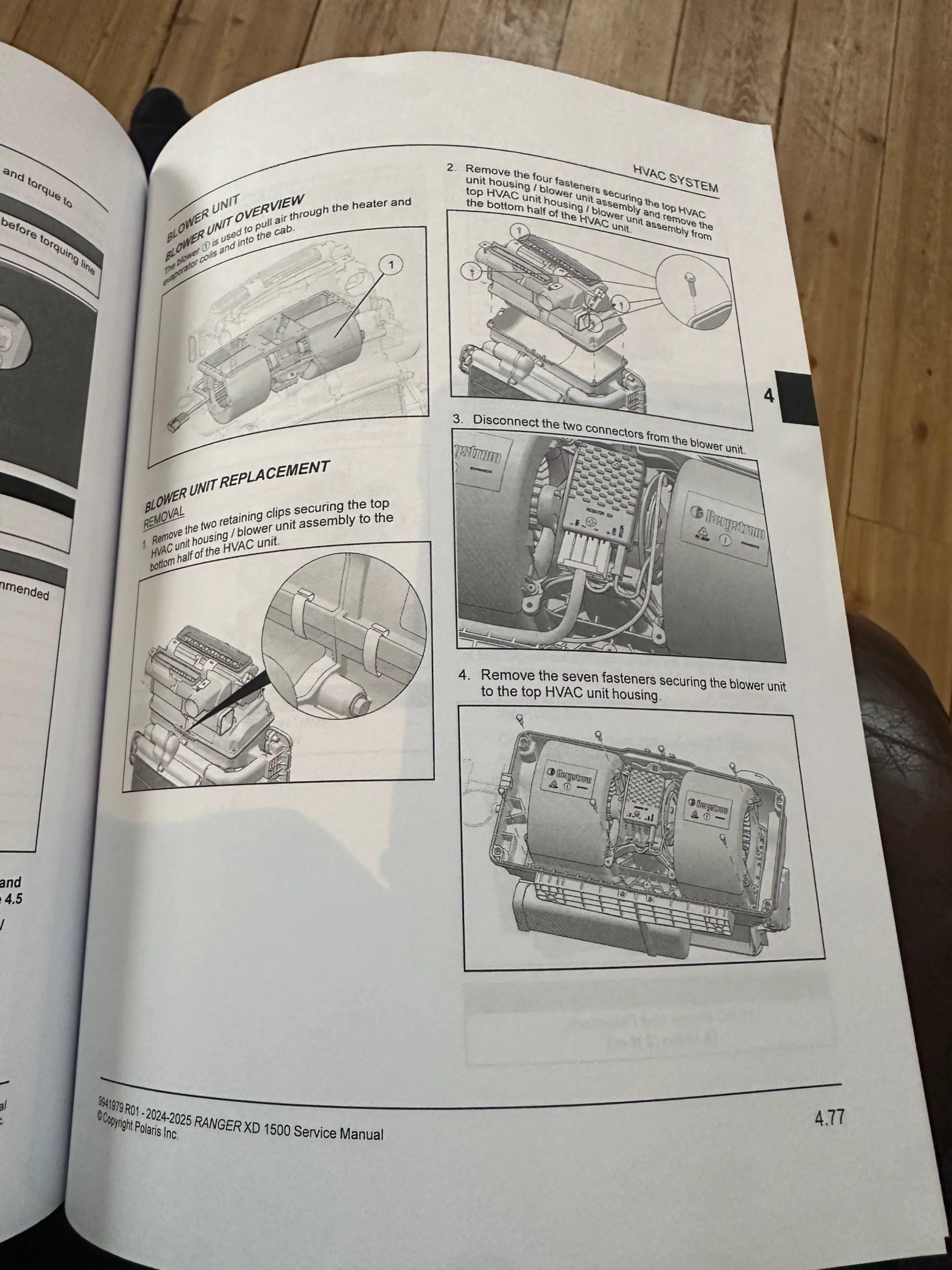

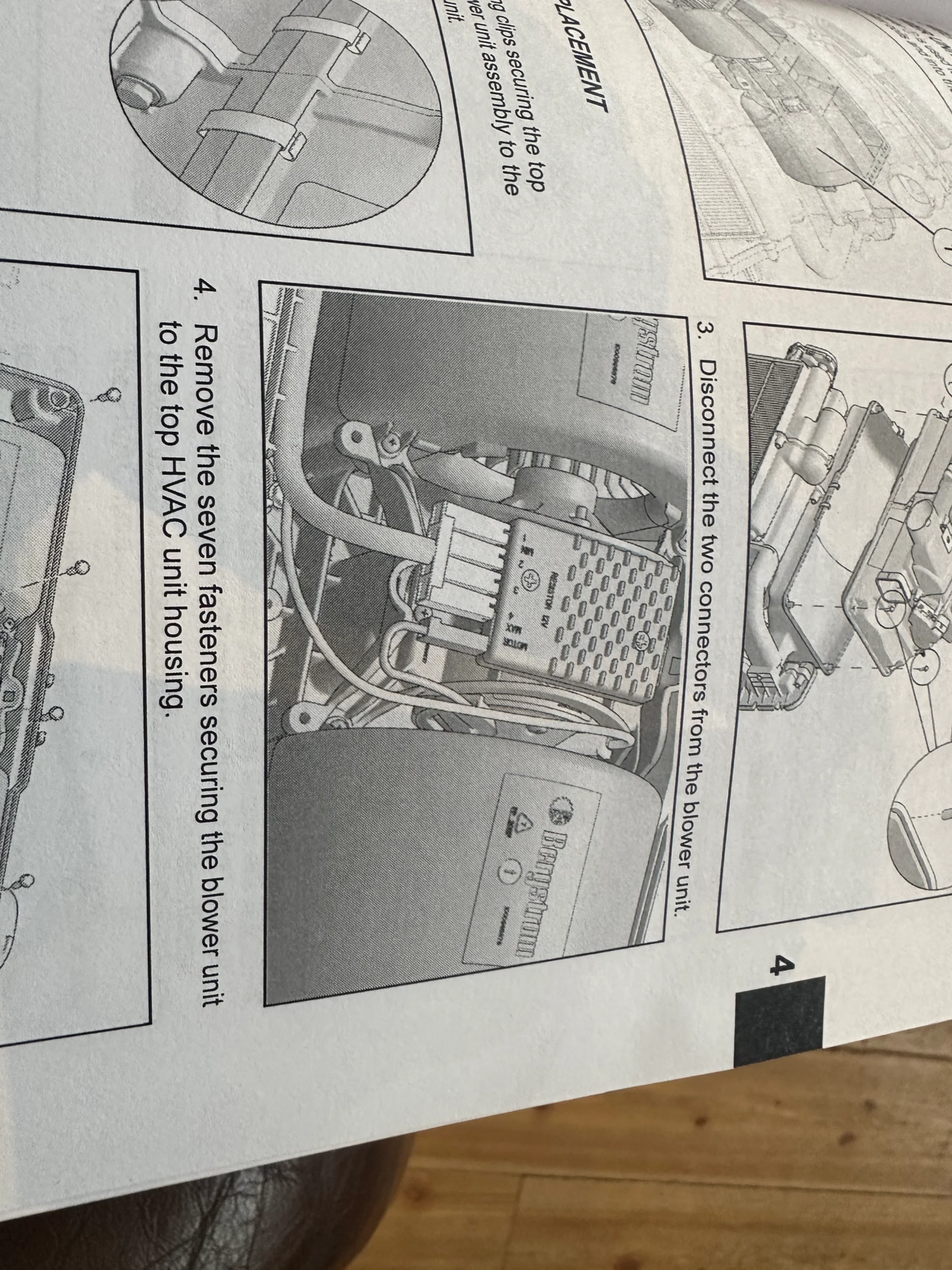

I've searched everywhere and can't find any information on how to get to the blower motor? Mine only works on high. Any help would be appreciated. Thank you
Resistor would be where to look first. It doesn’t look fun to get to though.
Thank you for the reply! Would it be possible to snap pictures of the process and text them to me?? This would help me out a bunch. I already have the new blower because Polaris doesn't sell just a resistor. Thank you, Brett
Pm me your number and remove it from here. Please. You can thank me later. lol. I’ll see if there are detailed removal instructions.
