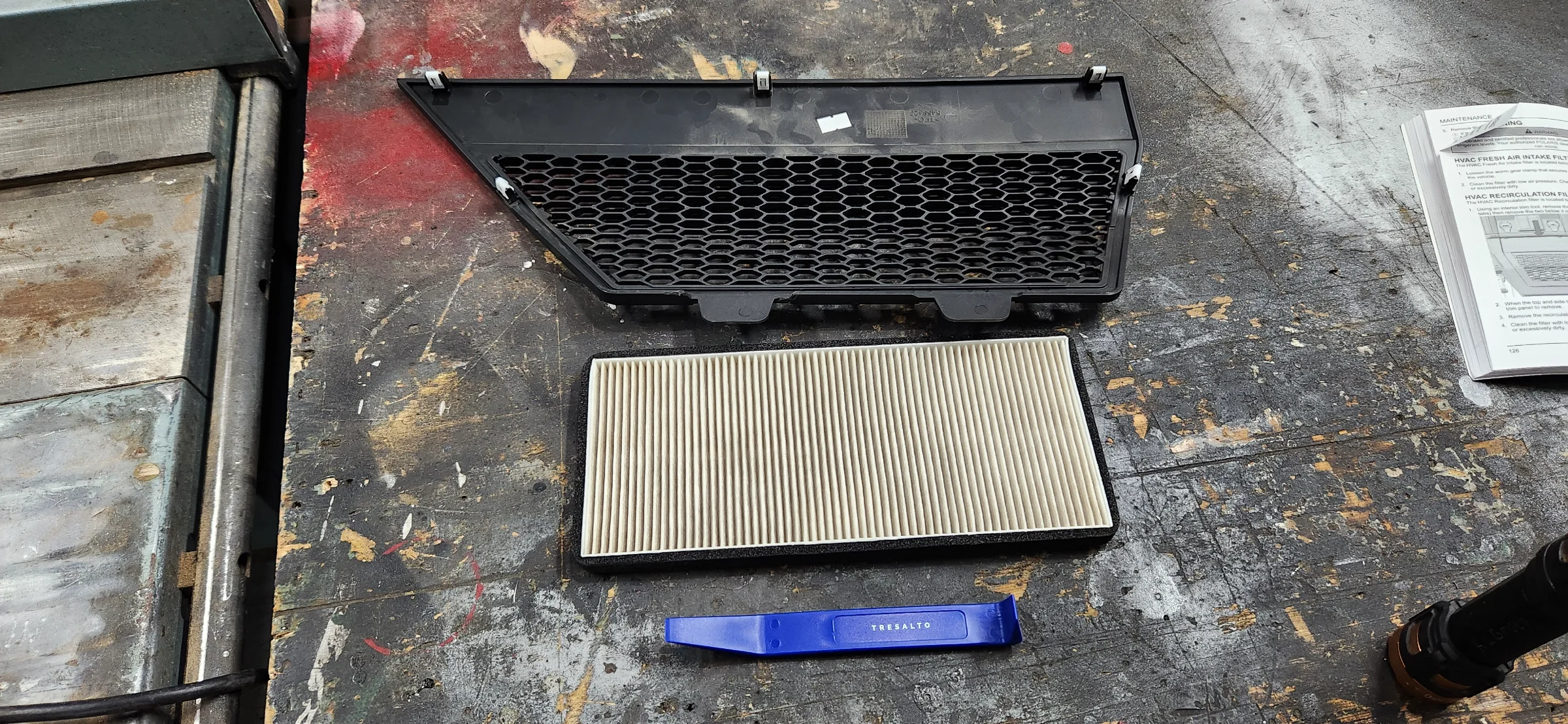

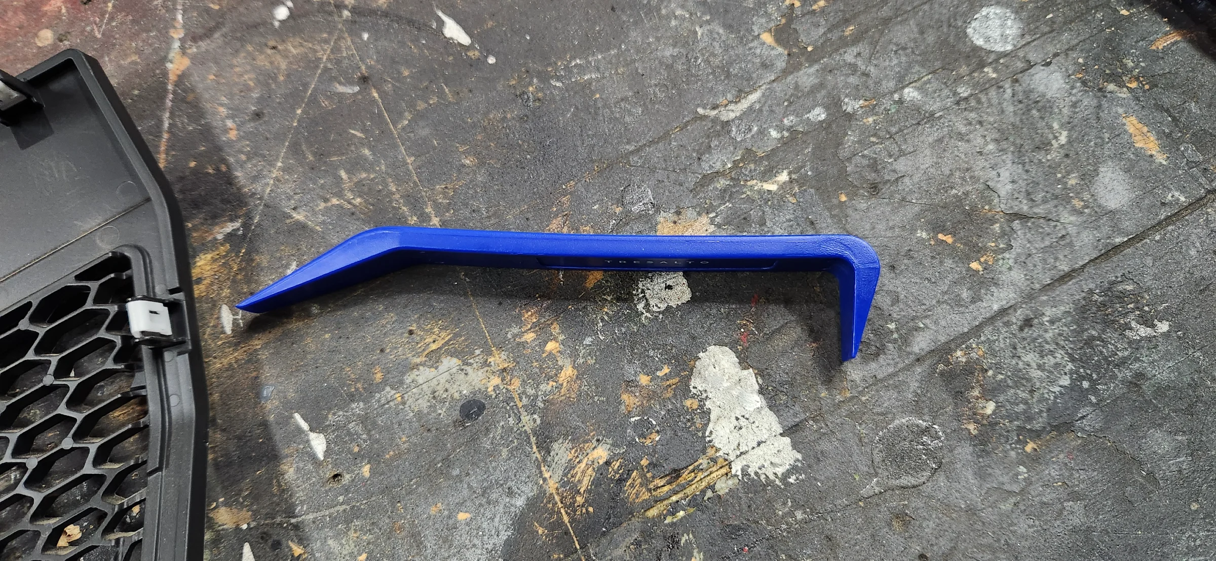

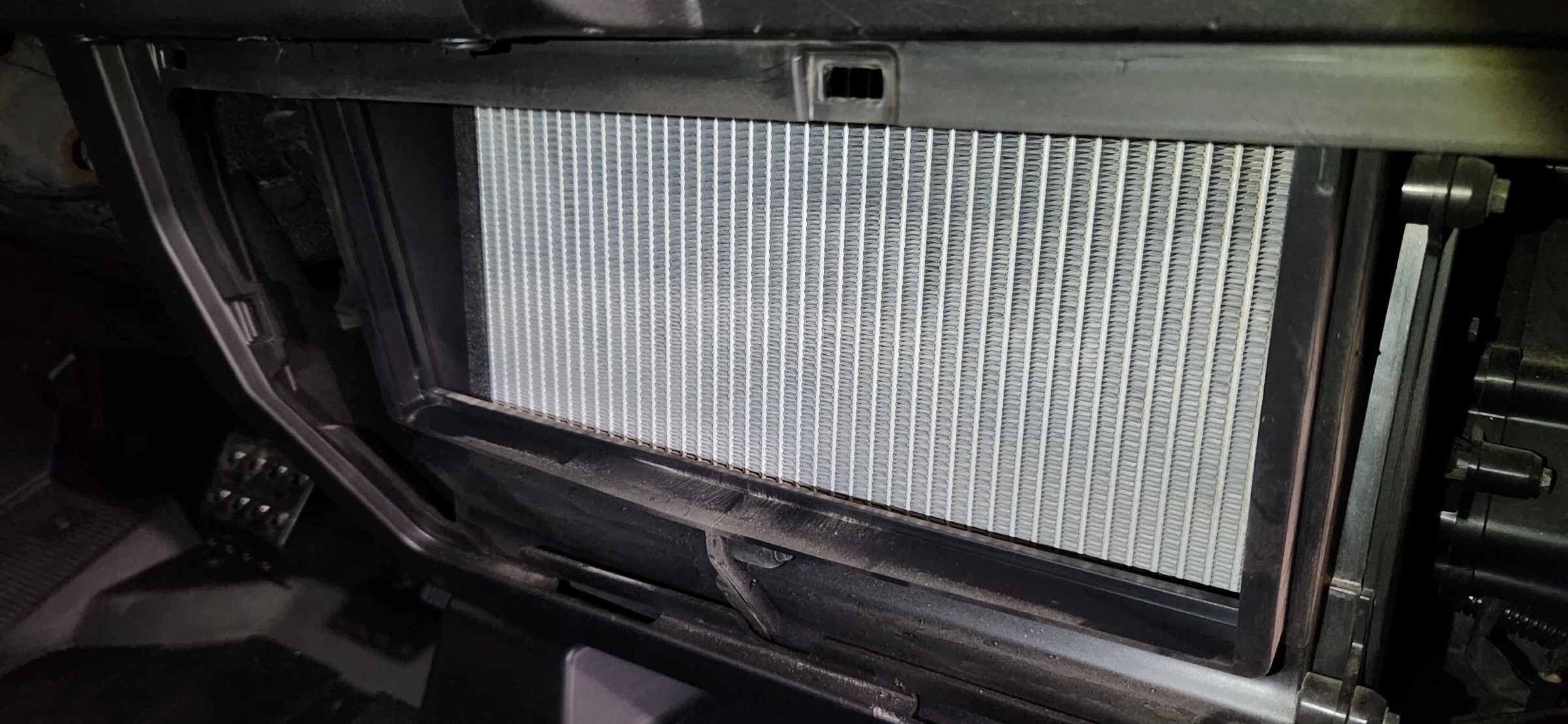

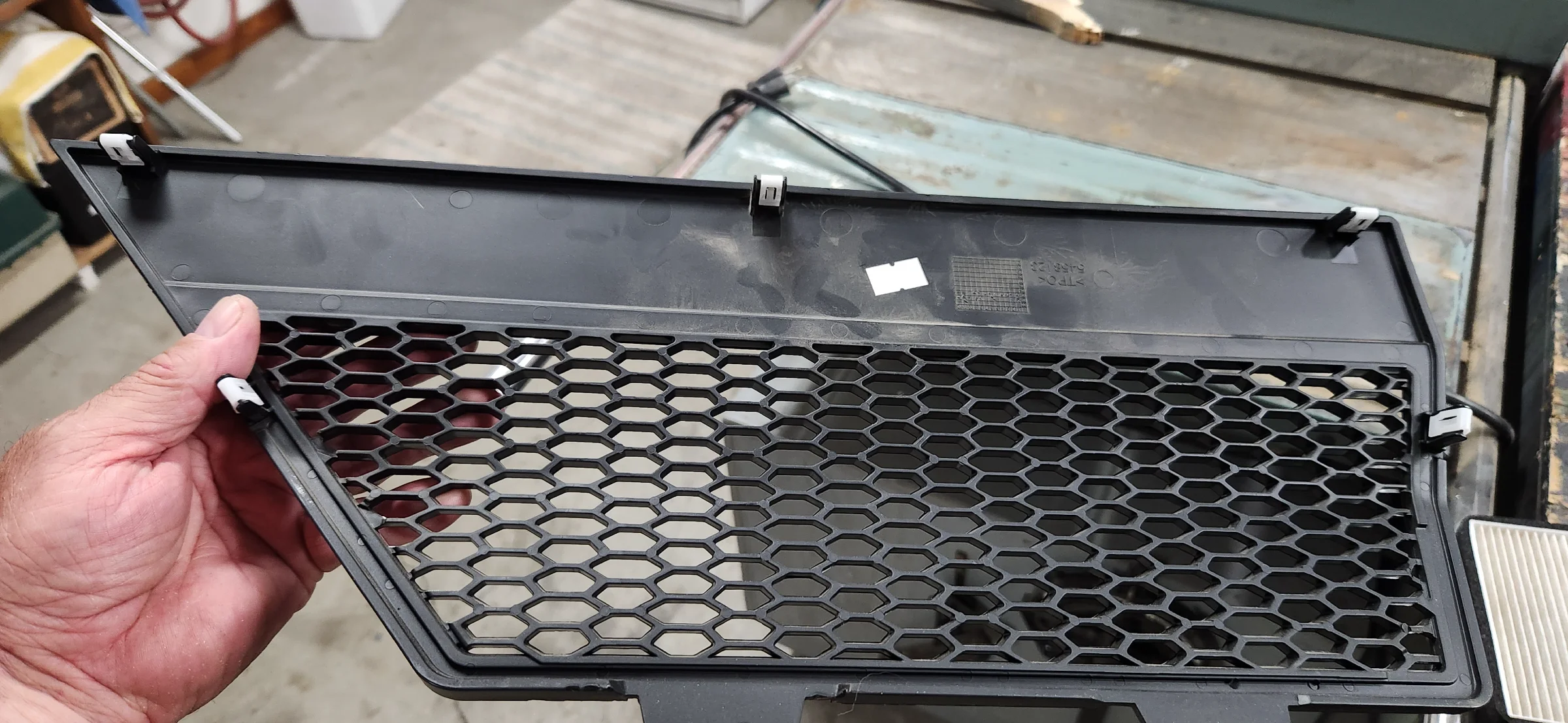

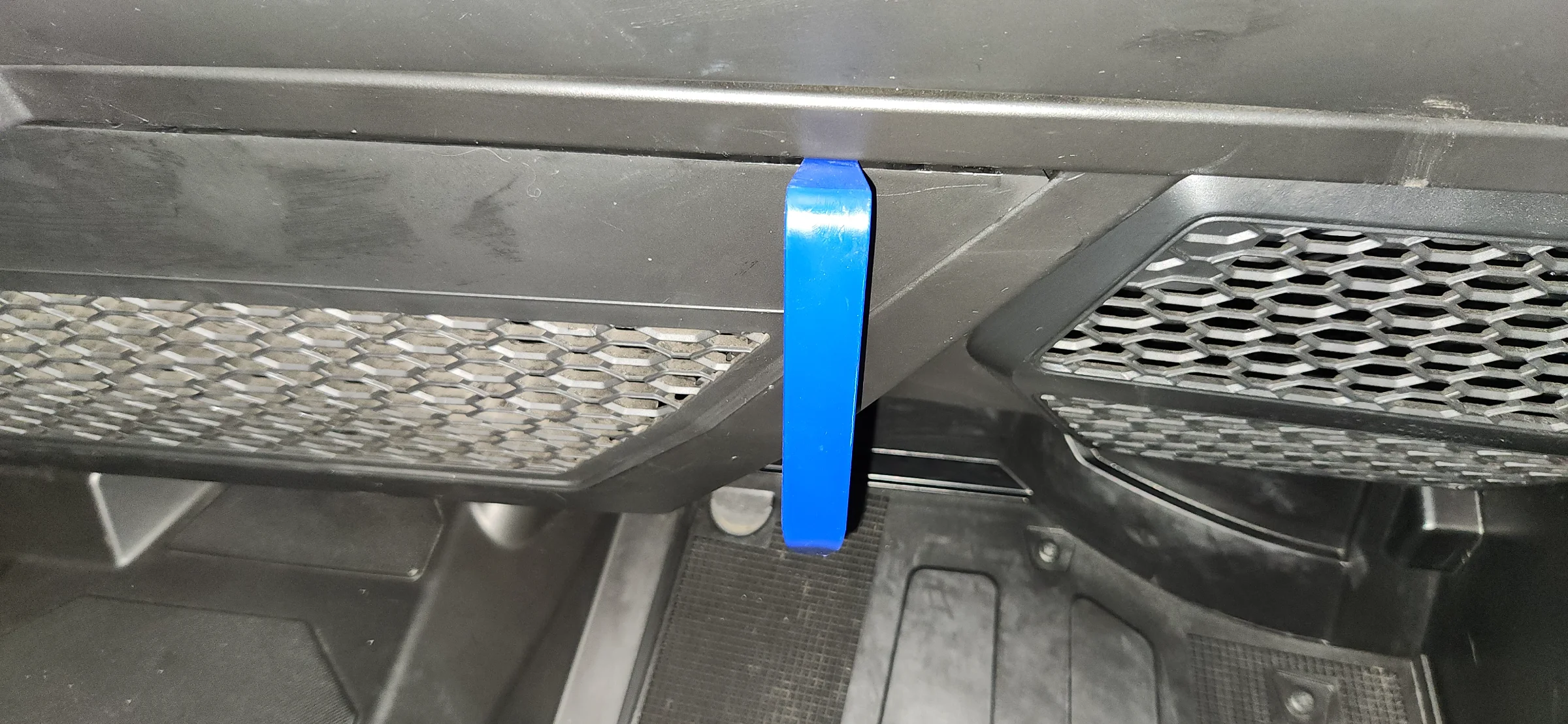

Inside your SXS look under the 12 volt outlet there behind the black plastic mess you can see the cabin filter. To remove it you need a plastic thin pry bar and the cover is held on by 5 clips. pry at the top seam there are three there and one on each side. Pull cover off and you be able to remove filter to clean or replace. Pictures attached.
