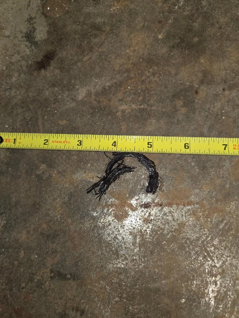

Just finished my Thumper Fab long arm kit install. Maiden run half shaft fell out, no biggie. I got machine up on rack and thought I would inspect other elements of install. Pulled back steering rack boot and found that the steering stop that TF supplied with kit was now shavings inside of rack. They are sending new stops to me, but please take 5 min if you have this kit and check on stops. Run was maybe 12 to 15 miles long.
