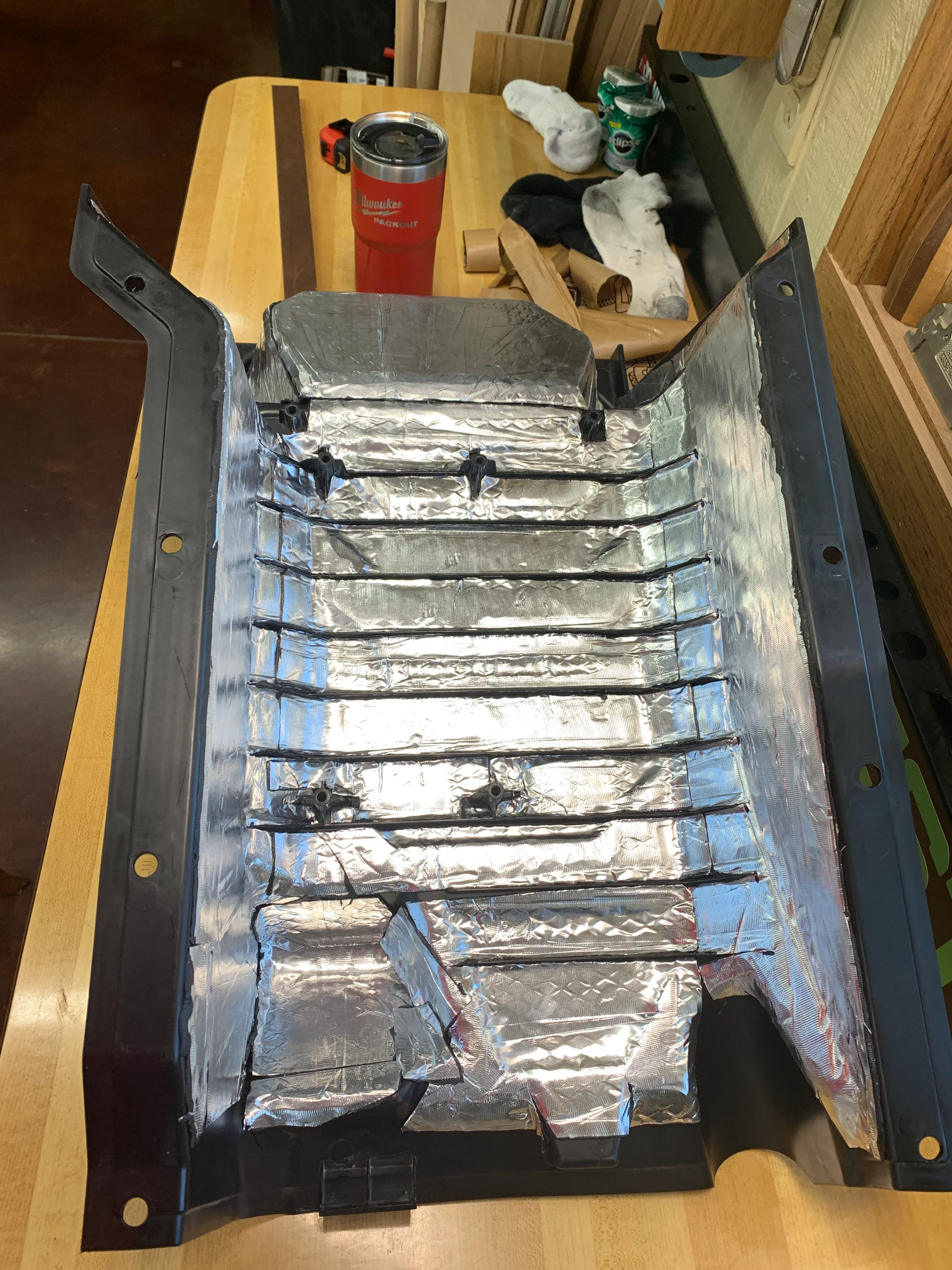

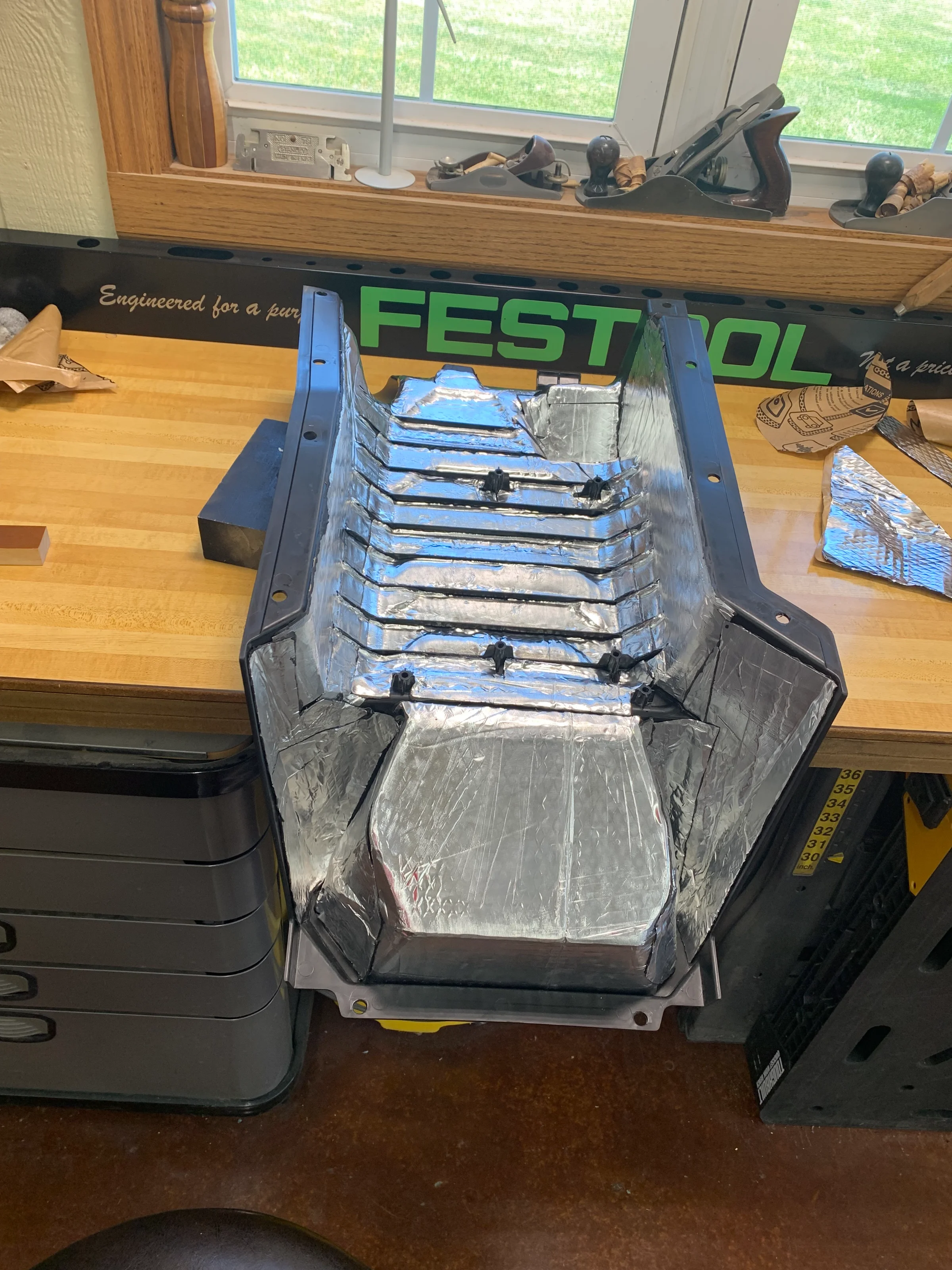

Well I have to say I was wrong about how much impact insulating the tunnel would make. I actually did the tunnel and the storage box located under the seat since it's near the engine and tranny. I did mine last Friday and it made a VERY noticeable difference. I've only had it out 2 times since then but no longer feel all the heat on my lower legs. That said it was a pain in the ass to do and if just insulating the pipes get's the same result I would go that route. Here are pics of the material I used and the tunnel. I had already reinstalled the storage box before taking a picture of it.
