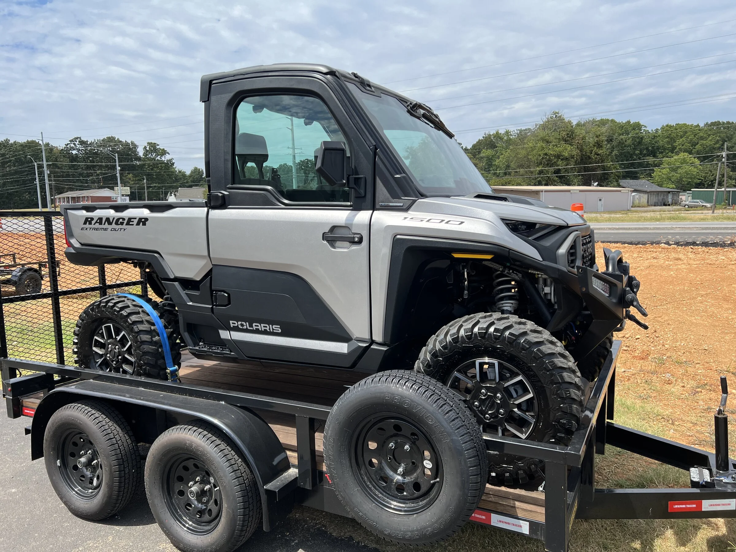

Bought a used 2024 Polaris 1500 XD Northstar Premium yesterday. Has about 1000 miles on it. A farmer bought two in March and traded them in on Ultimates because he wanted a radio and the dealer couldn’t get the radios he wanted. Worked out well for me. Still has bumper to bumper warranty left until next March and if I understand correctly there’s some power train warranty beyond that.
He had the windshield converted to flip out like the Ultimate, he added side mirrors and he had the lights added in the front bumper that come with the Ultimate.
I’ve found two issues thus far. The wrench light is on even though dealers says it was recently serviced. If I understand correctly that’s a known issue. Also, no washer fluid comes out to clean windshield. I checked the reservoir and there is some in, but not a lot. I’ll add some to see if it’s just below the pickup. I can hear the pump running so hopefully something simple.
