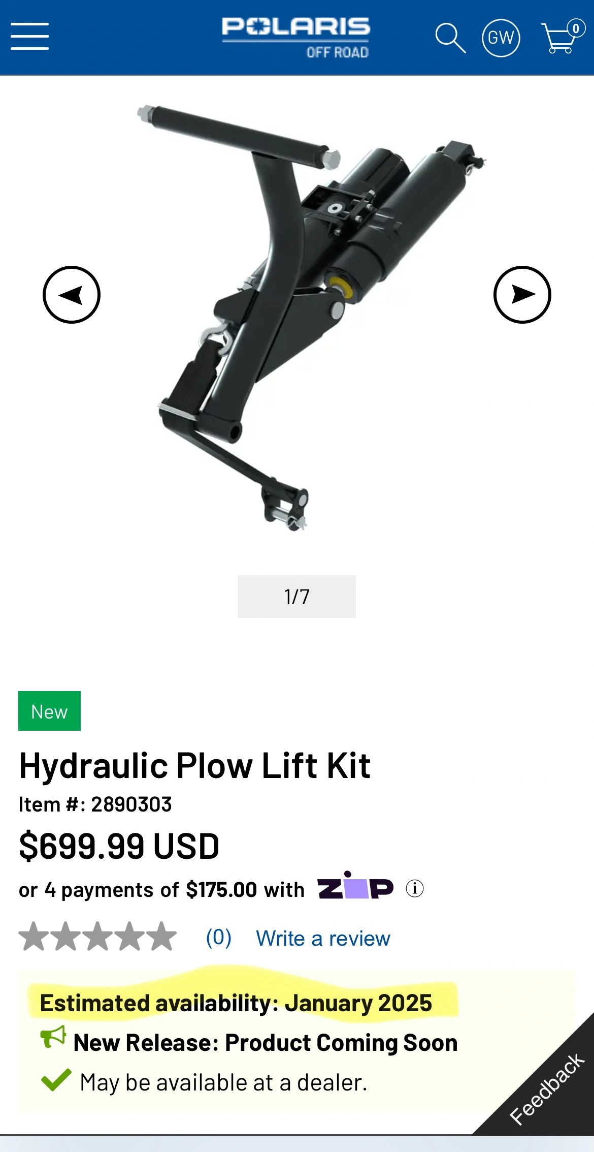

Yesterday I looked up the plow lift in the Polaris catalog. It shows that it will be available in January, 2025! This makes me wonder if they know that the first models were under engineered.

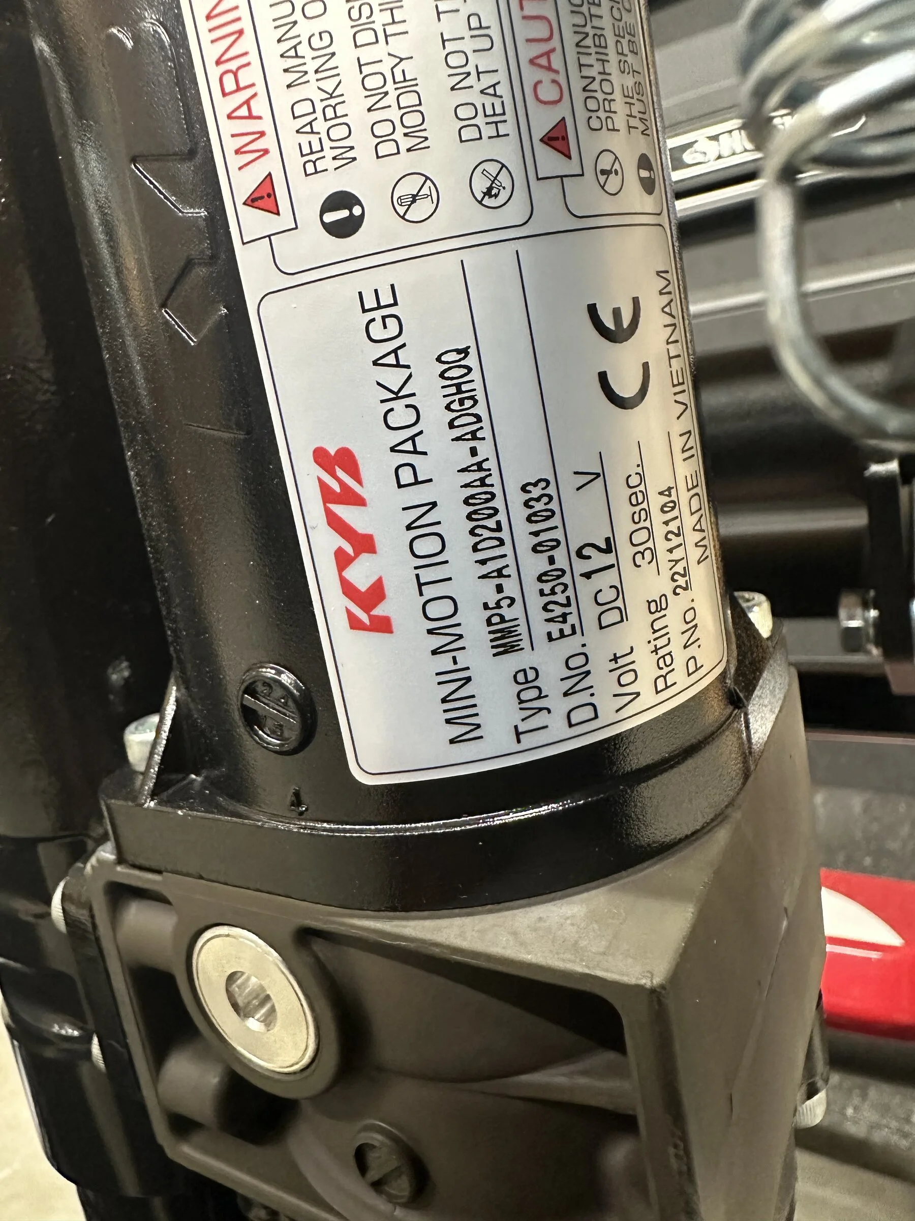

Polaris says that the wrong hydraulic units were used initially for these kits. They don’t have a timeframe for when the new cylinders will be available.
FYI — the wrong hydraulic units are KYB MMP5 models.

I would appreciate it if you would post a photo of the label on your hydraulic lift cylinder. Here’s a pic of mine:

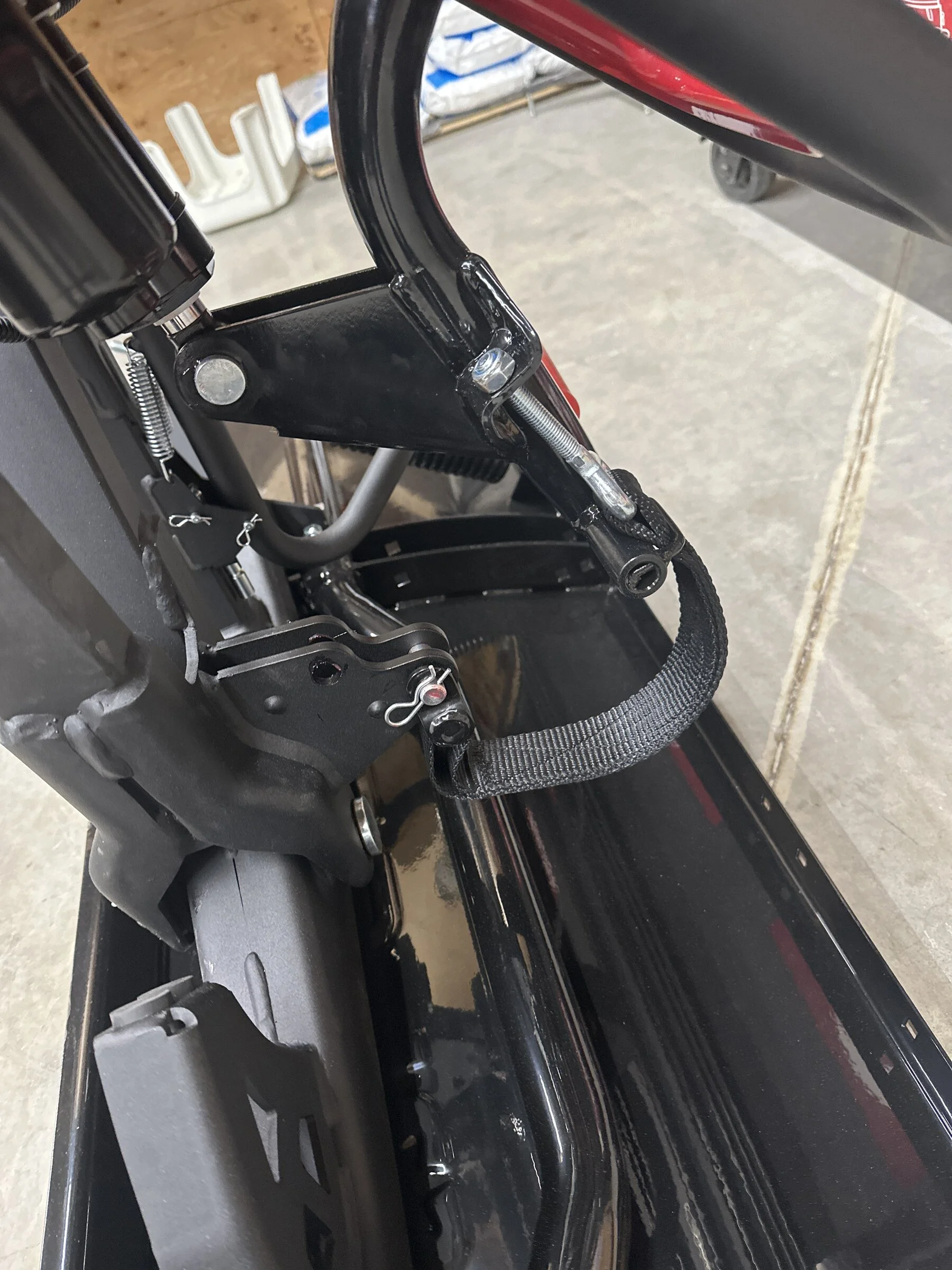

Does your plough have the two separate positions for the nylon strap to hook on? In the instructions it does not show two.

The part numbers for the actuators are not available. New actuator in the works. Not available till mid January.
