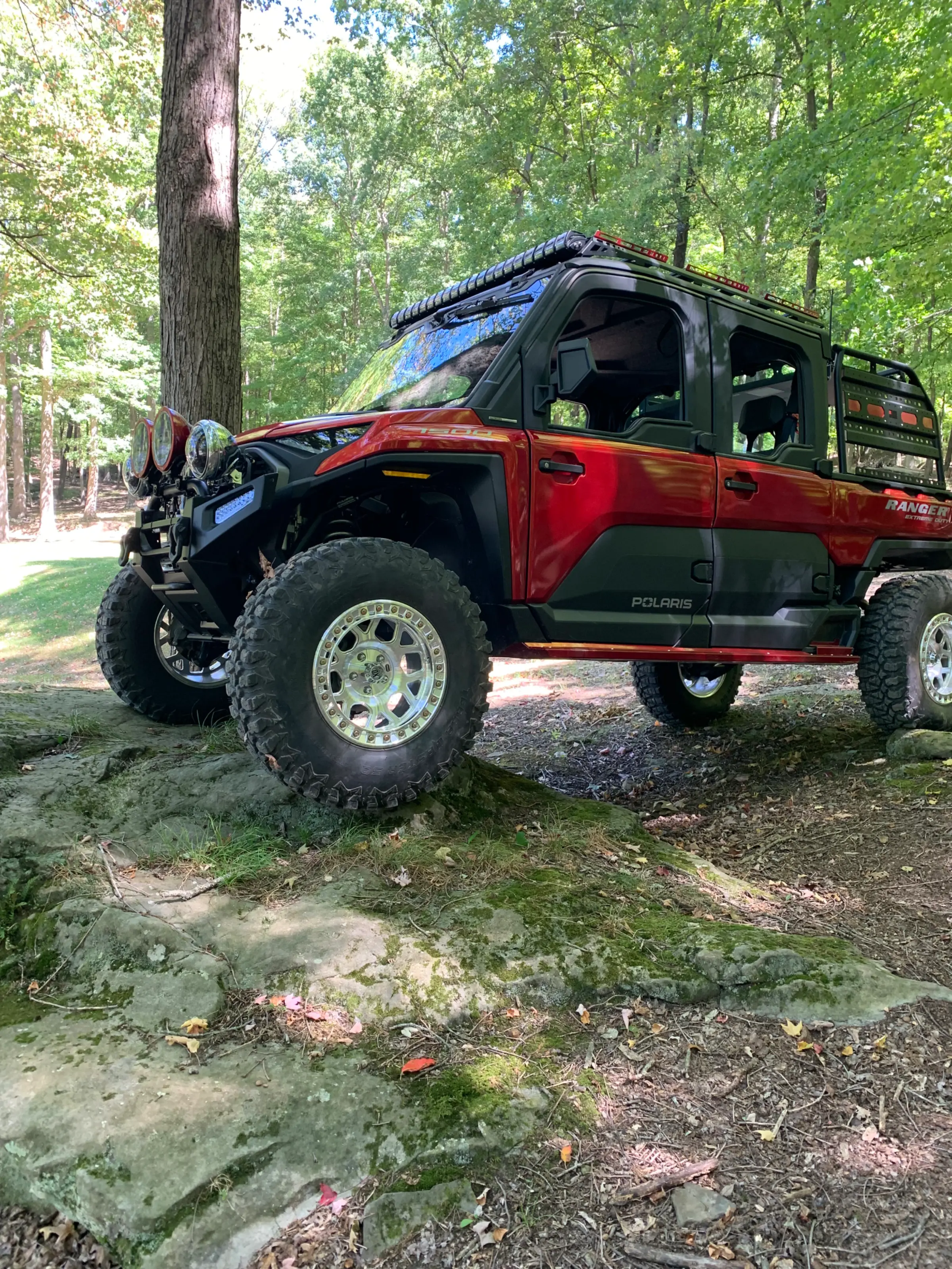

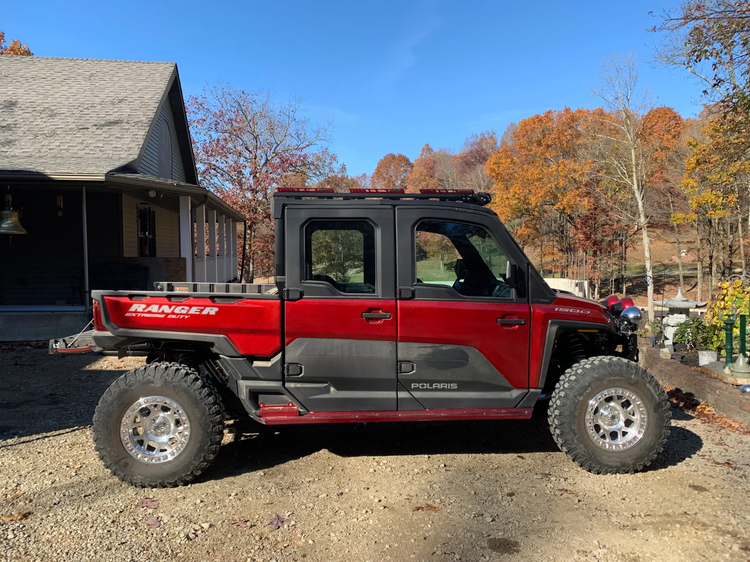

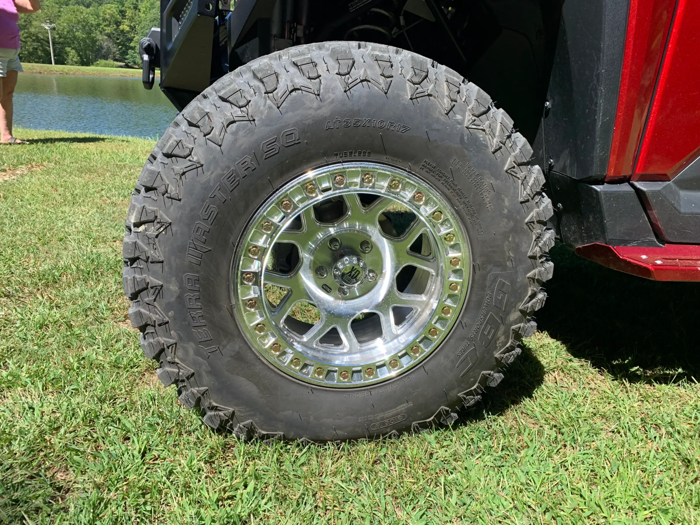

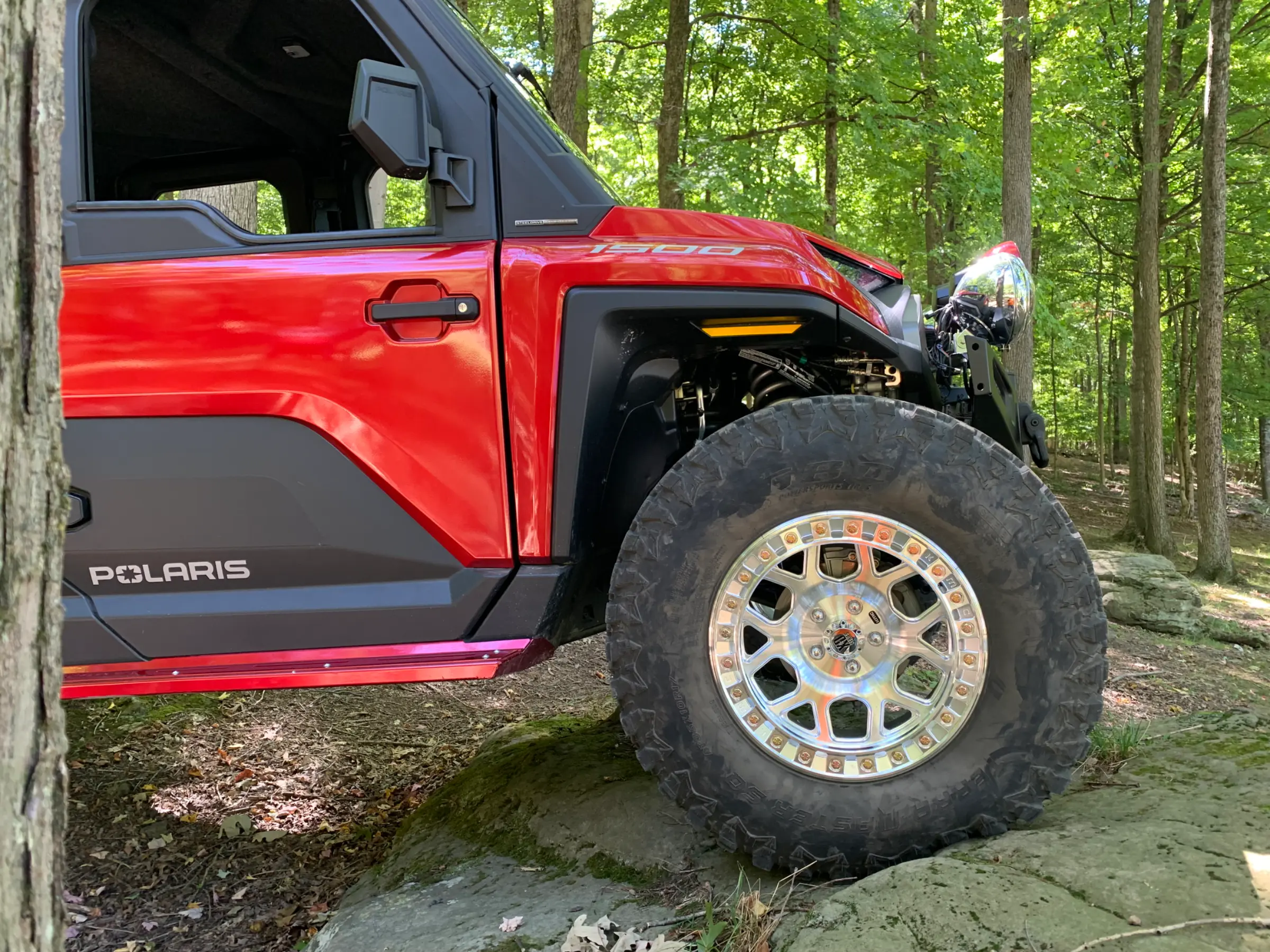

I have had these a while now but never put a write up in "Wheels and Tires ".
I am old school still attracted to plain finish aluminum slots so I decided to go 17" since the tires are tall enough to still have plenty of rubber surrounding the wheel.
The wheels are not listed as UTV wheels but our bolt pattern is the same as earlier Jeeps ( 5 x 4.5). Most wheel makers can get you in the wheel of your choice.
17" UTV tire choicesare not plentiful but there are many choices in DOT's.
Overall I am happy with the tires and thrilled with the wheels. Our land is rock everywhere and the taller tires help cushion the constant jolts.
There have been some stating their 35's don't rub or very little up front but the GBC's measure 34.5 and in one hour I knew they were going to eat my inner fenders. As mentioned above our land is rough with many obstacles causing a lot of suspension flex . Had no plans to do these but forward a-arms was a must.
Below are a few pictures.

View attachment 2262View attachment 2261View attachment 2261View attachment 2260View attachment 2259I'm old school as well and love the look of your wheels and tires. Today everyone wants dull finishes and black everything. I came from the motorcycle world and was a "chrome whore" when building my bikes. I have moved more towards the new trends but still like shiny paints and rims that are not all black. Tastefully done my friend!
