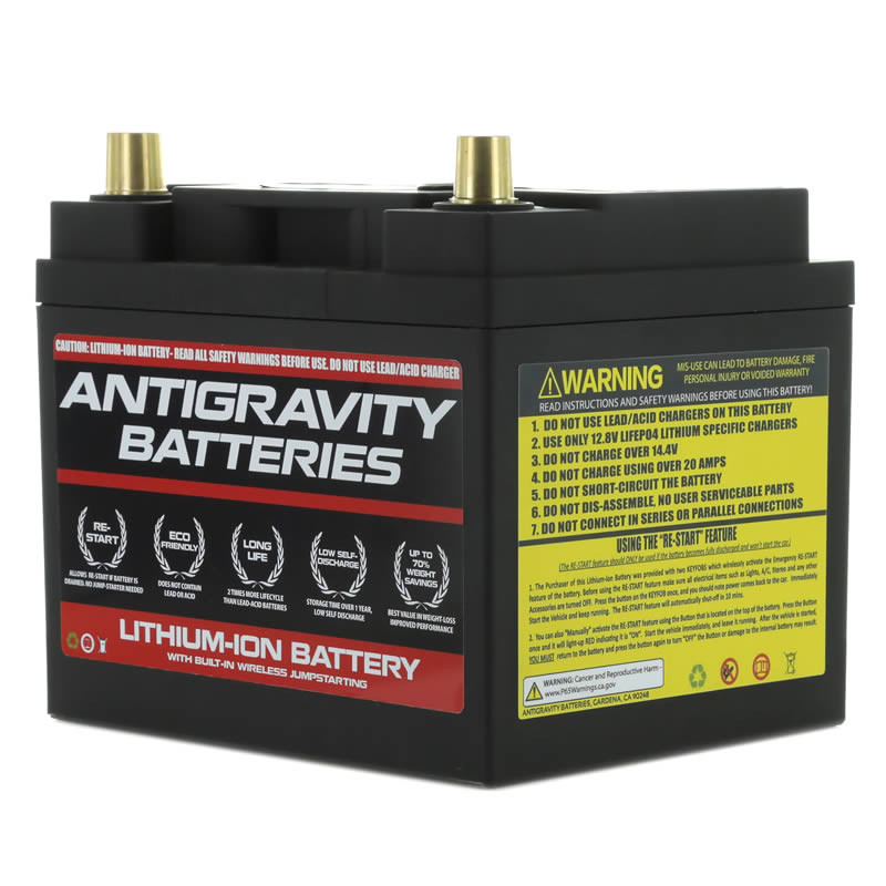

Lithium Battery Option
Hmm, I didn’t know lithium batteries were available for our machines. I just purchased the heavy duty Polaris battery recently. I haven’t got it switched out yet though. I did a google search for replacement batteries and not much came up besides Deka. Which I’m not a fan of. To many premature failures with those.
