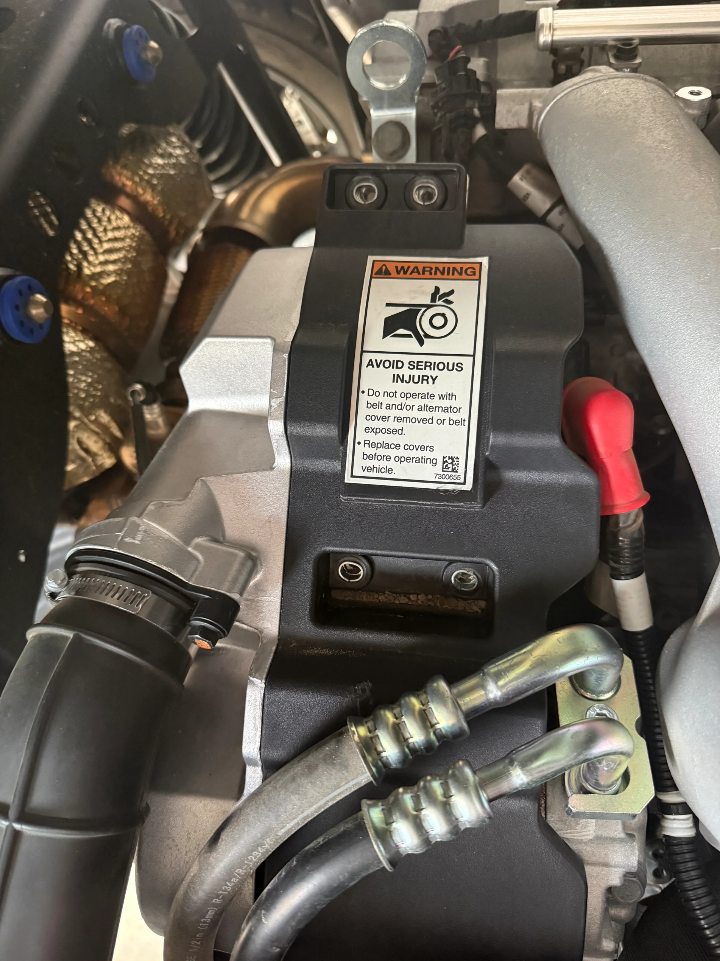

Has anyone removed the black, plastic cover over the alternator and compressor? I can push on this cover and the noise I hear around 1800 rpm’s goes away.
It appears that you need to remove the aluminum air intake shroud in order to remove the black cover. I was considering leaving the black cover off, but did not know how it would affect the air flow to the compressor and alternator.
I tried to pad the black cover per se with rubber washers but was unsuccessful at reducing the noise.

It’s too clean. Take it and get it dirty.
