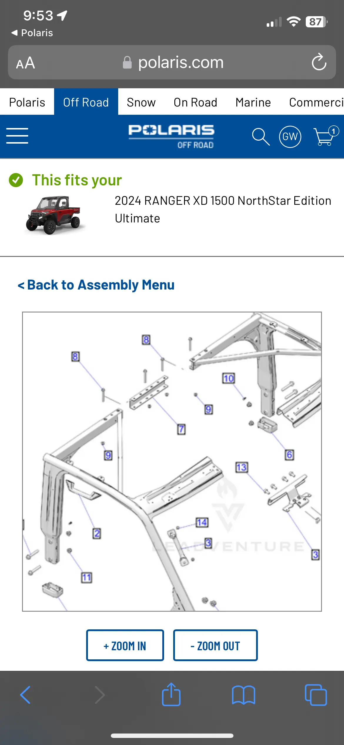

Got the Polaris OEM grab handle (part # 5465599-070) to use over the passenger door today. It did not come with bolts to attach the handle. Since the parts diagram shows no bolts for the part we assumed they came with the handle. We even spent some time searching videos online to see if our vehicle just happened to have the handle missing, especially since the holes are pre drilled. All videos showed the same lack of a grab handle.
Before sending an email to Polaris, we decided to assess the handle fitment. And now I see why no Northstars show a handle in that location. Even placed as close to the door frame as possible the bolt holes do not line up. There’s no way to bolt the handle there even though the parts diagram clearly shows one there.
So not only is it without bolts, the holes not matching up make the handle worthless.

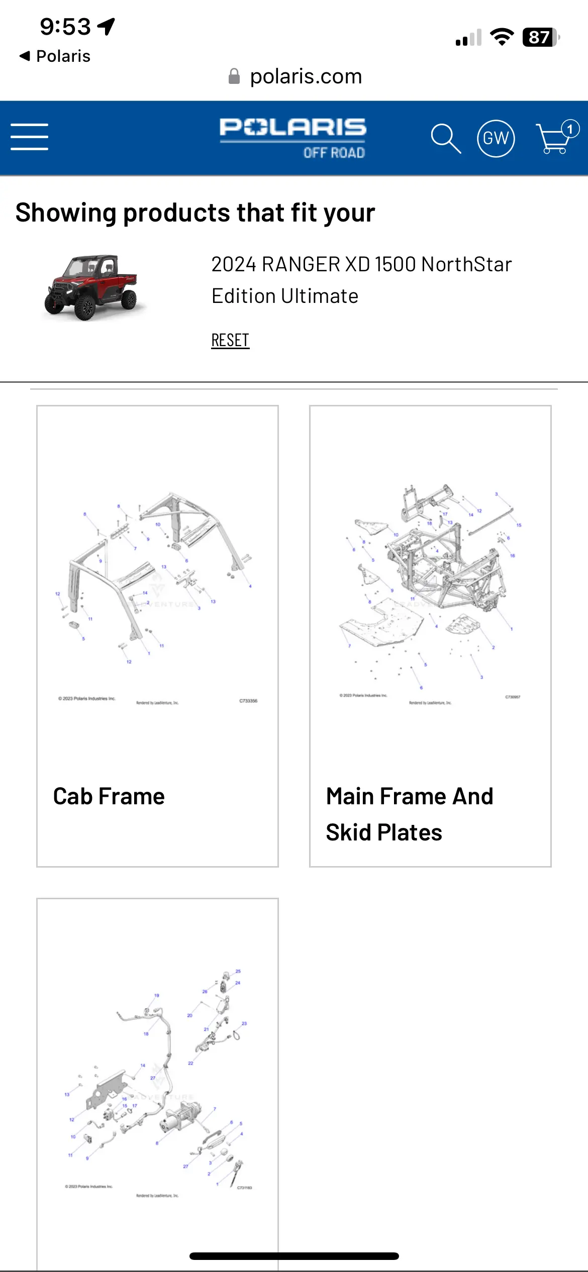

We let Polaris know about all this in their online email option. We even attempted to upload several photos and screenshots to document our complaints; however, the photos of the misaligned bolt holes are not uploading but it took screenshots from their website. We even tried to simply take a screenshot of the missing photos and the site would not accept them either. Odd. Spending more time to simply document our complaints with photos is not helping us to feel more kindly toward Polaris.

Well it's obvious your passionate about this grad handle that does not come standard on the XD 1500. Are you sure the diagram shown above is an XD and not an XP 1000? I say that because it appears to have tabs in the picture above, the XD does not have tabs only some holes in the channel. I never knew Polaris offered a grad handle for this even if it appears there are hole where one possibly be mounted.

We were very sure to put the model and trim into their parts search filter. We are absolutely certain that the diagram with the grab handle shown came up for the 1500. We looked it up more than once. If its for the 1000 then Polaris needs to fix their filters.

I see what you are saying about tabs. But here’s screenshots of their site. Note the photo part on each that says the parts are for the 1500.
