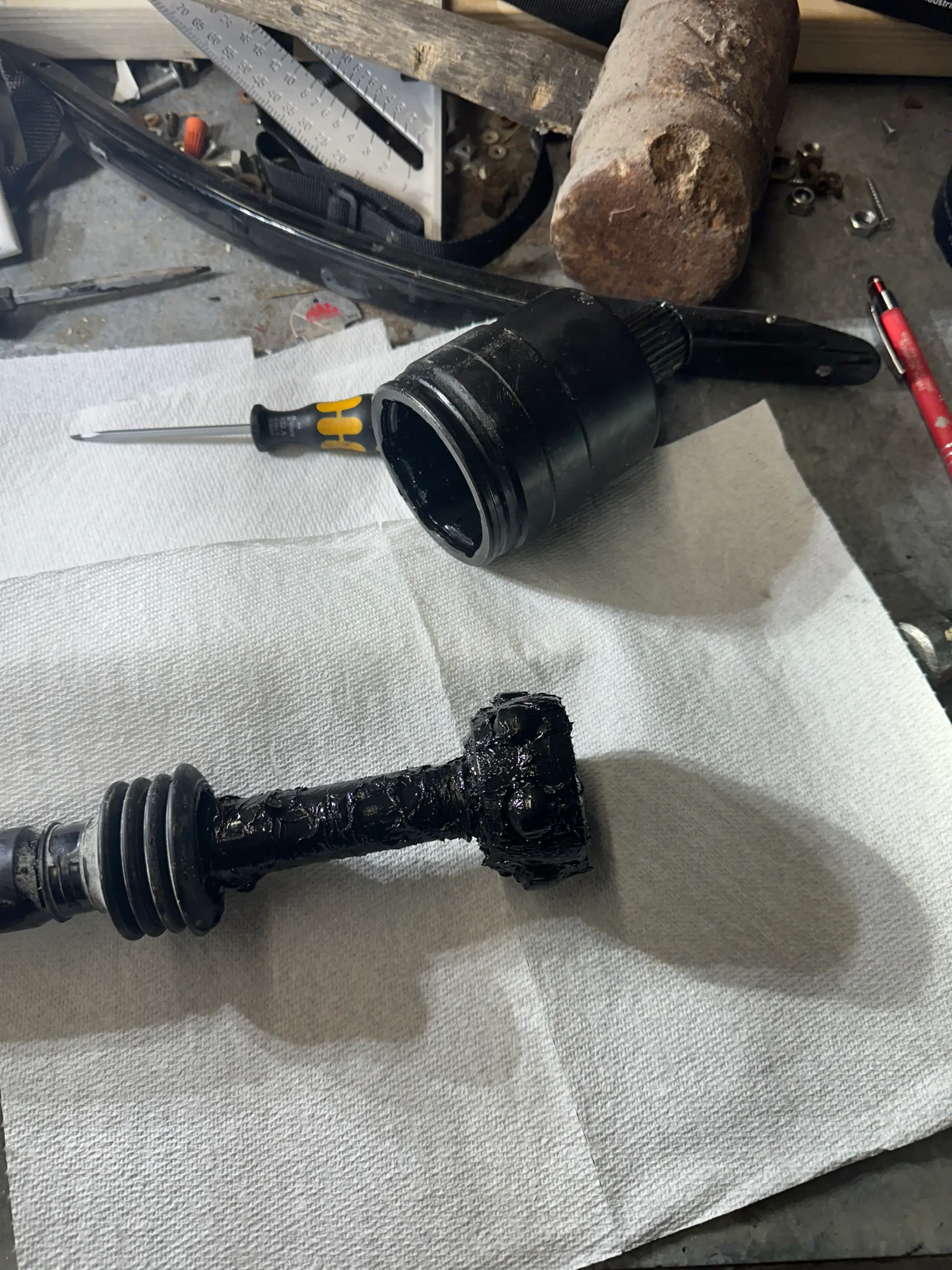

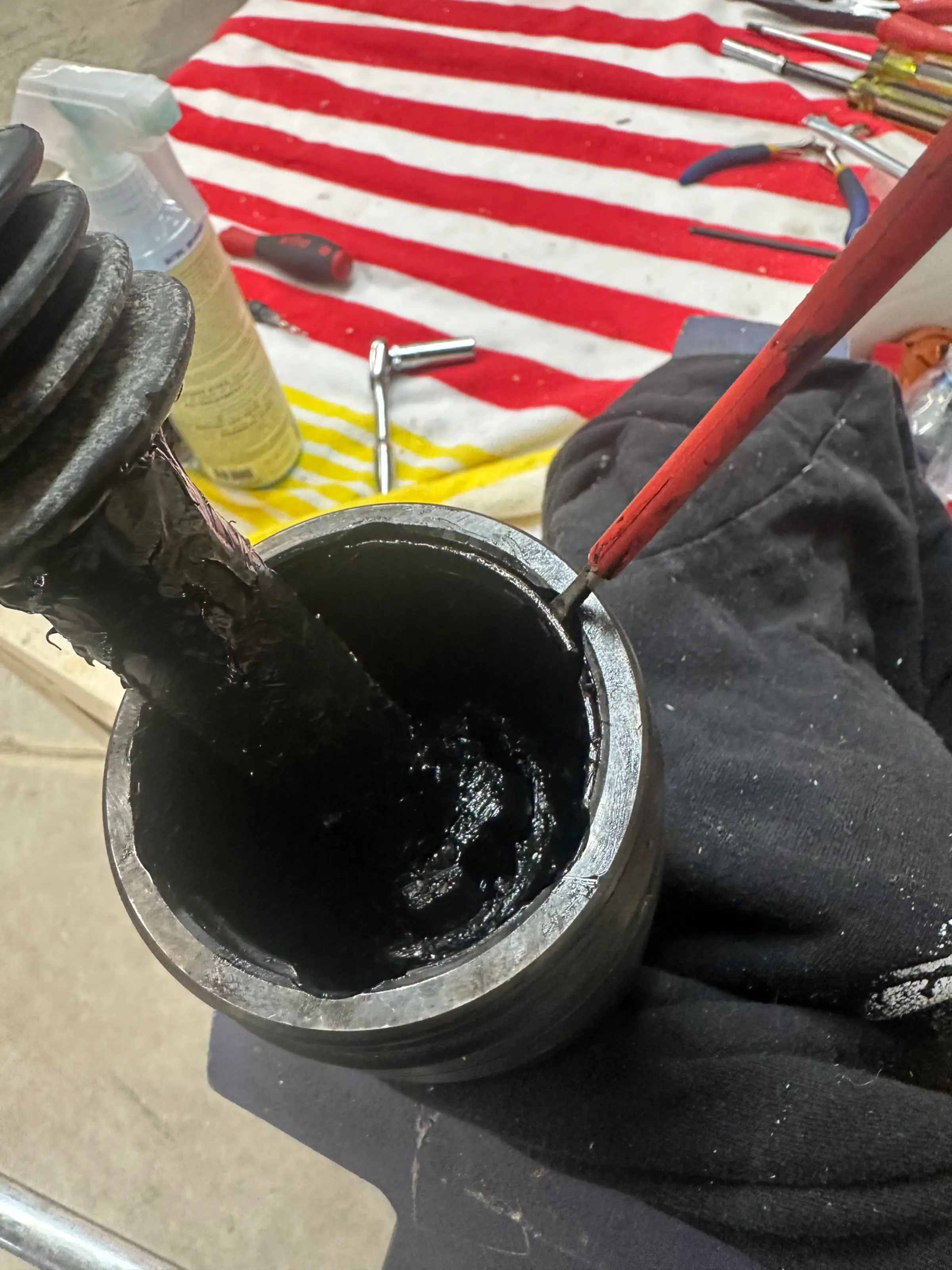

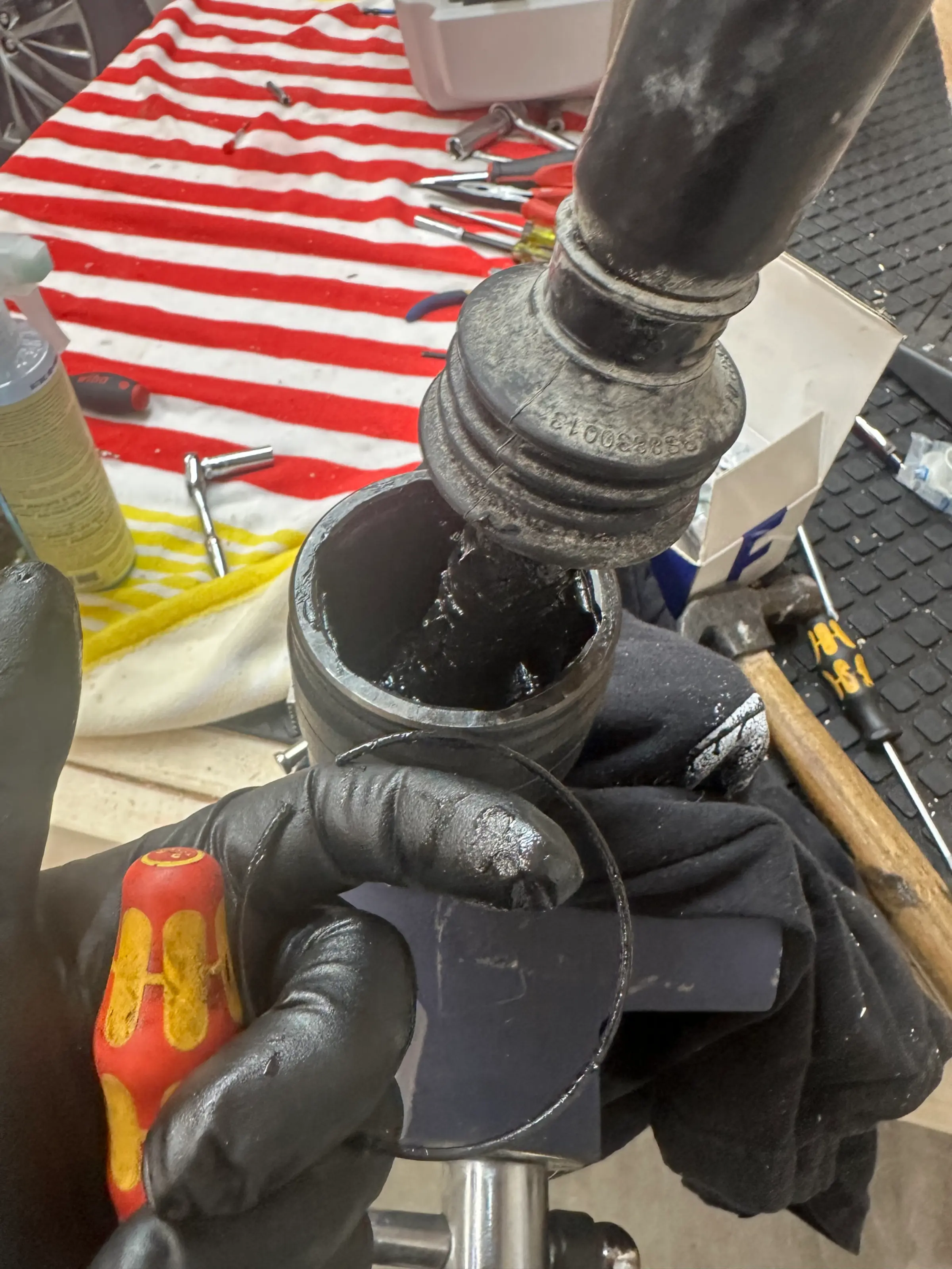

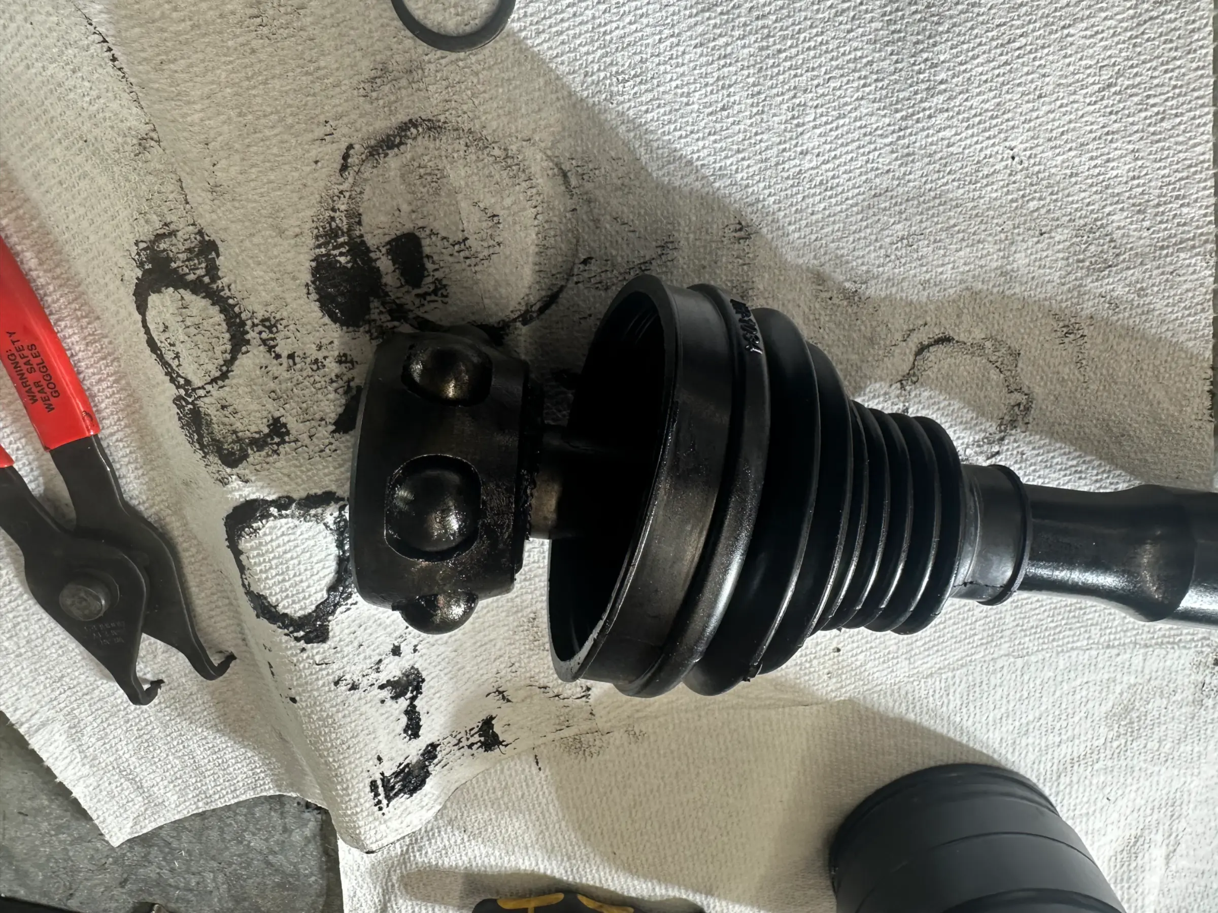

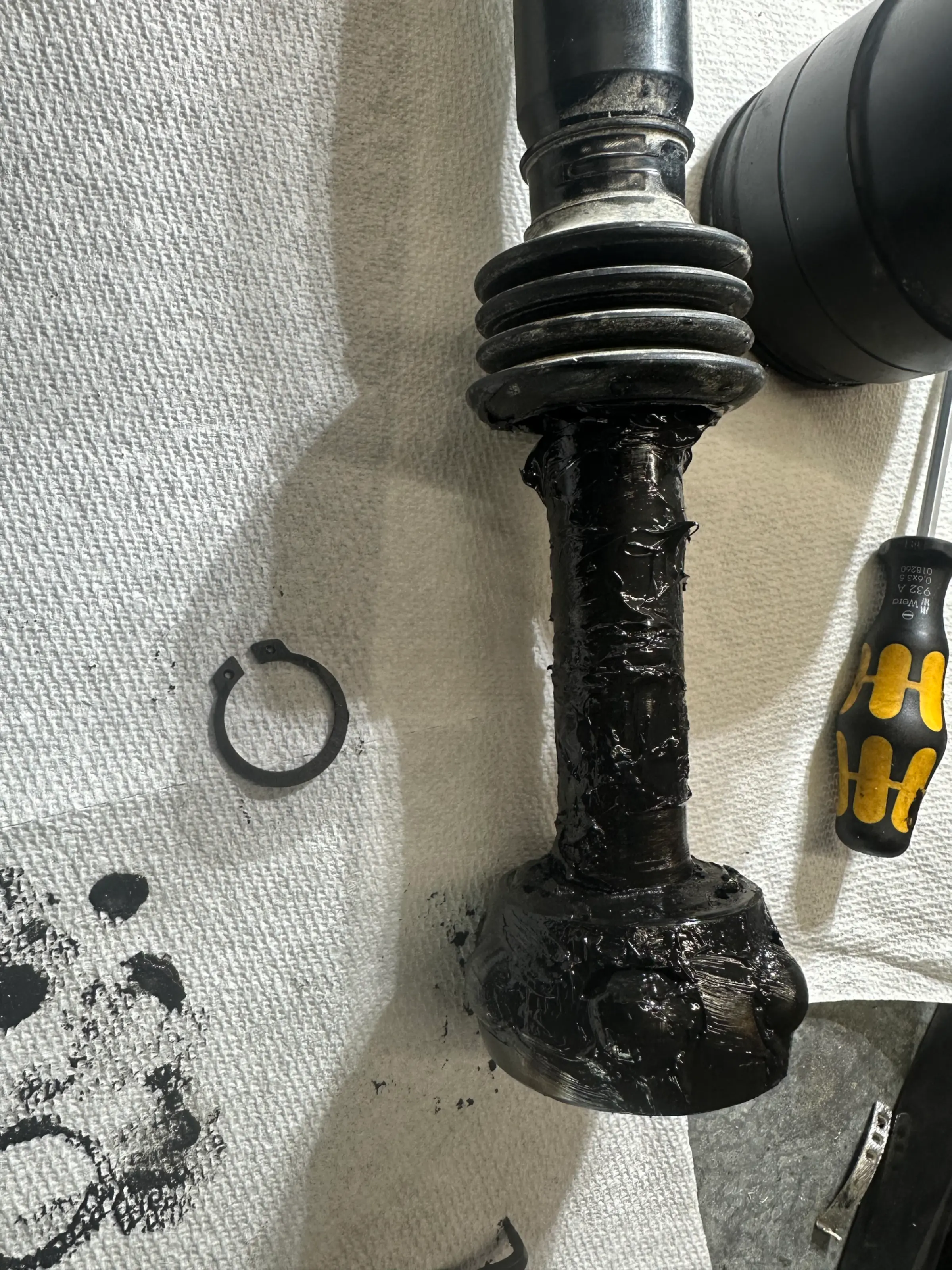

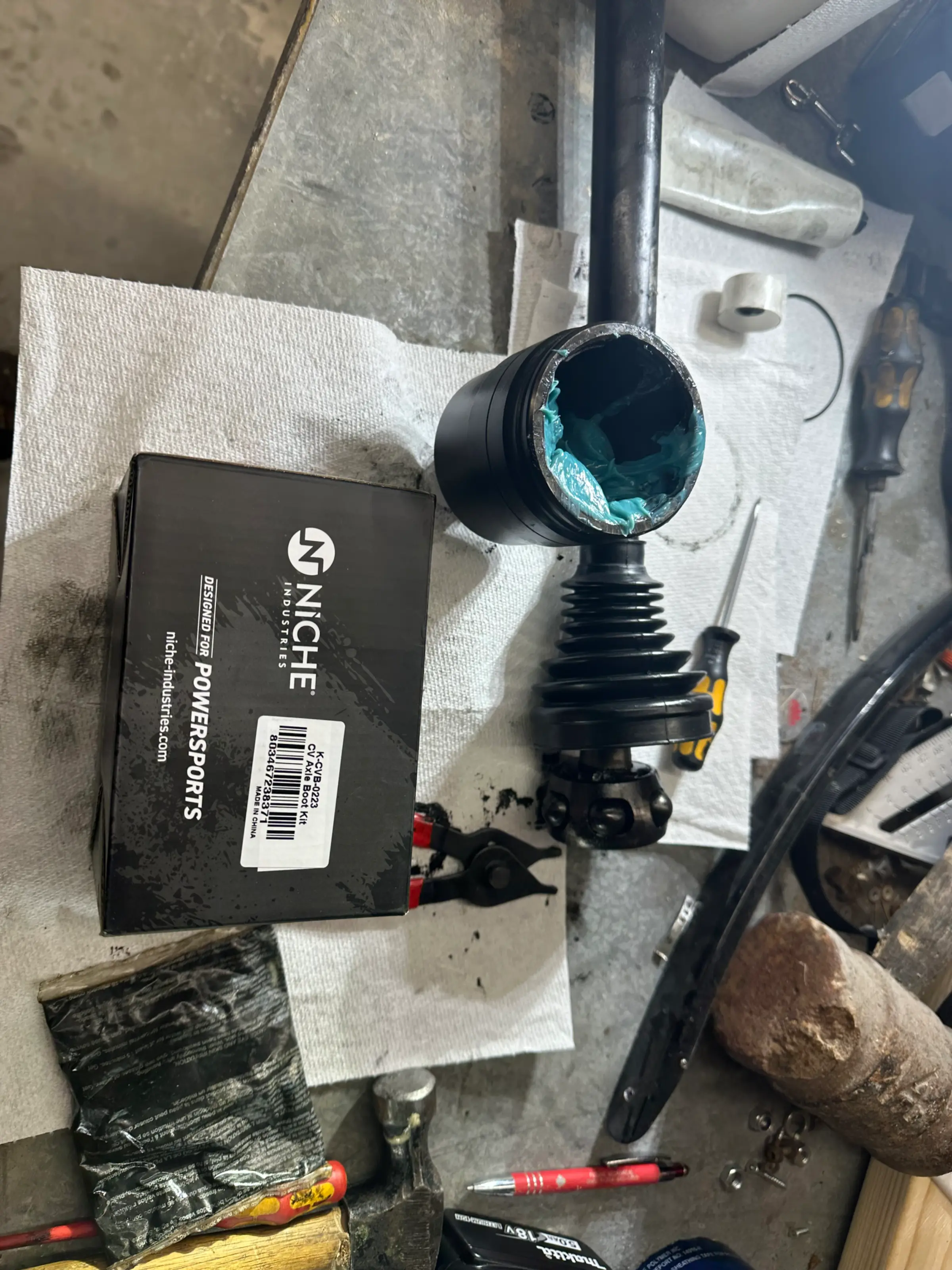

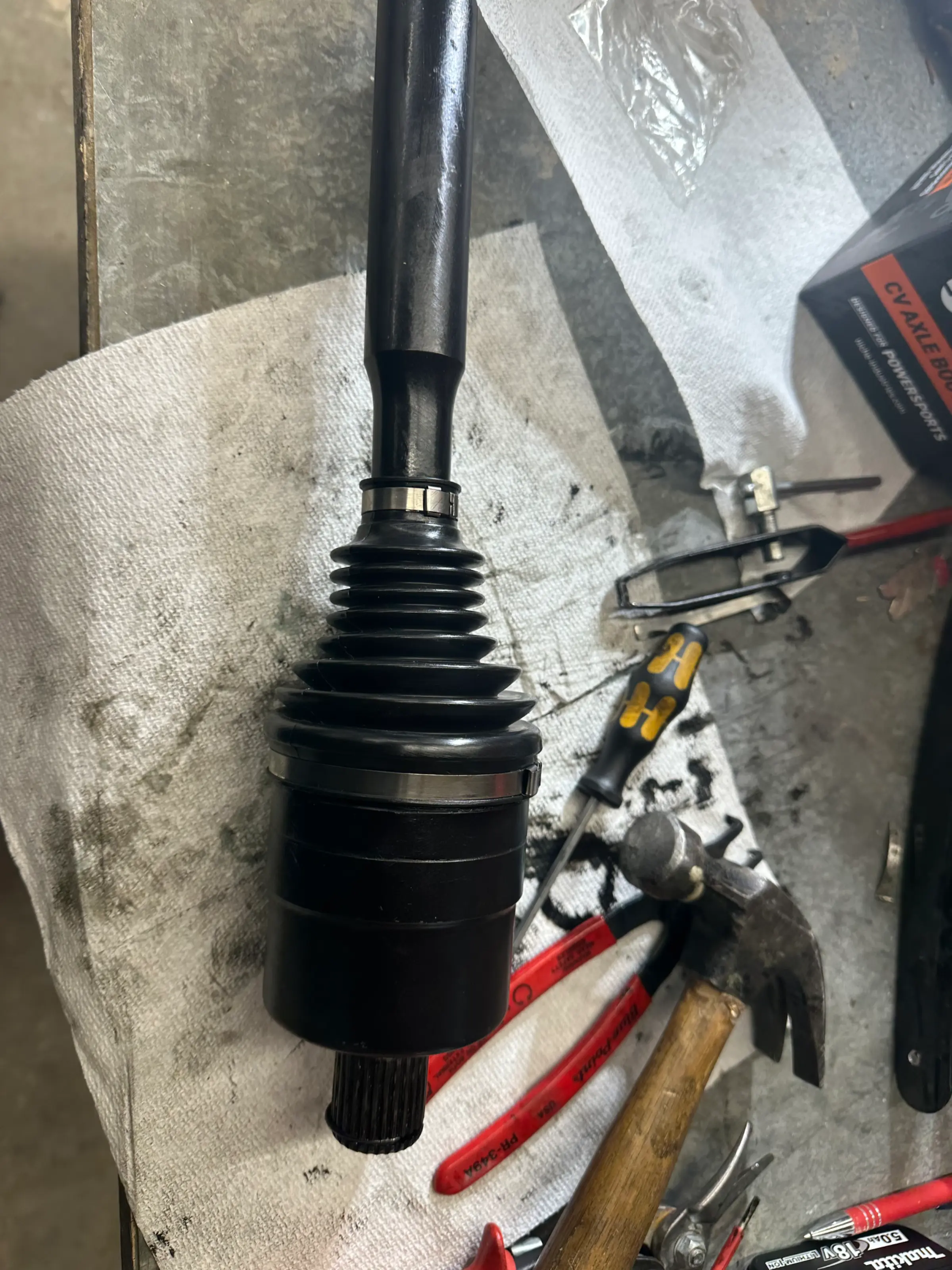

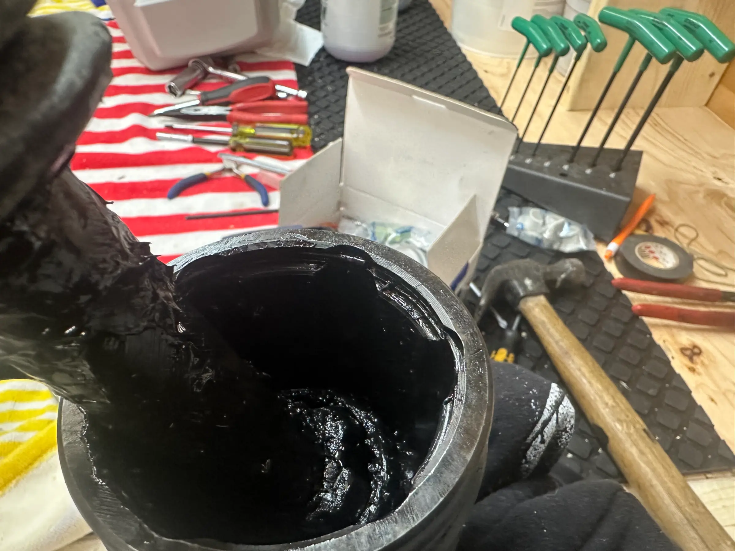

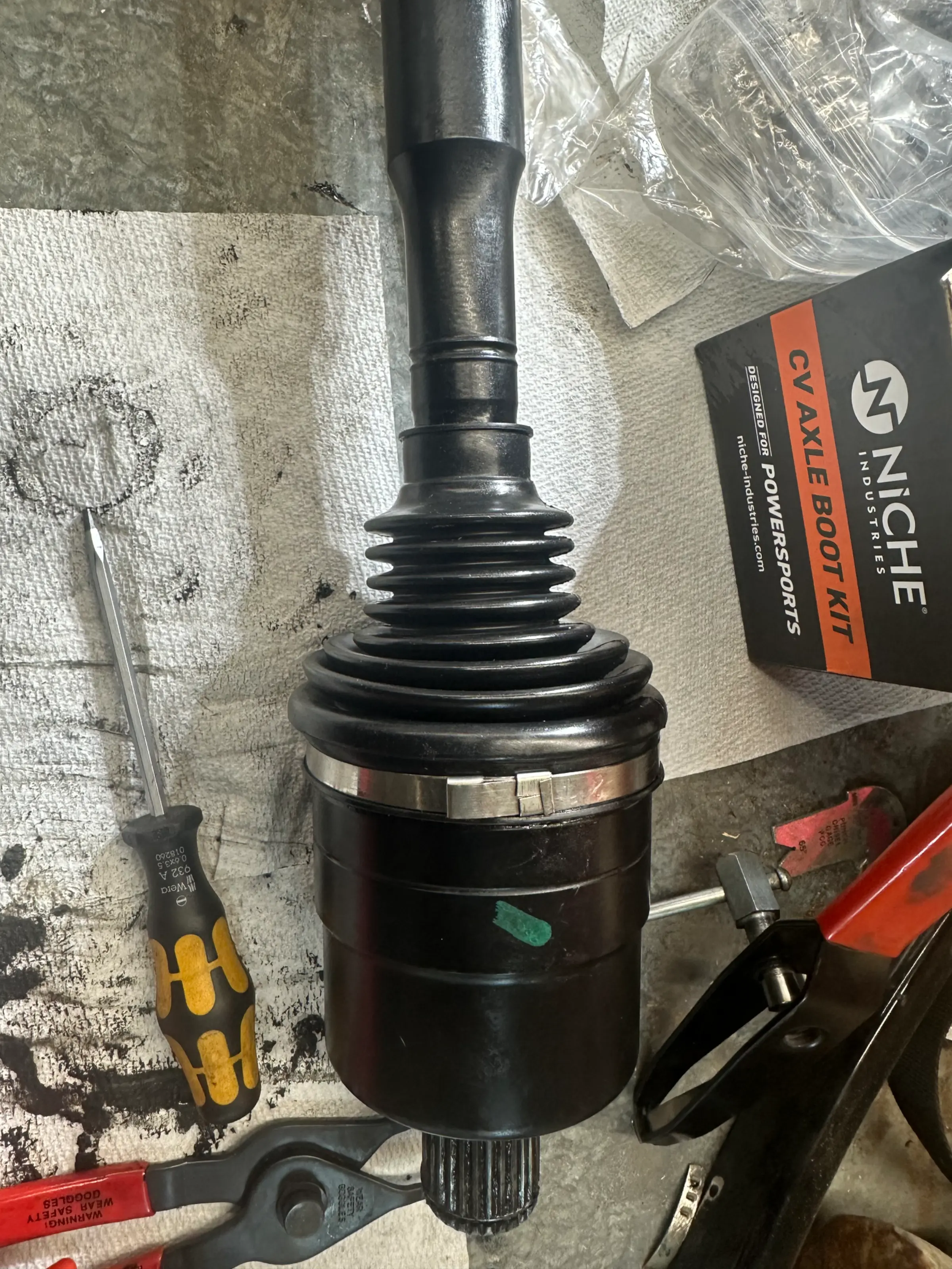

Here’s a few pictures and a little bit of information on what it takes to change a CV boot on a rear half shaft. Polaris wanted $90 for a single boot kit, I thought for $40 for two boots. I would try this, so I bought the NICHE part number K – CVB – 0223 kit. It includes two CV boots The inboard and outboard boots are the same. The niche kit also includes compression type clamps one package of grease and some external c-clips. It was about a 30 minute job to replace the boot. One thing to note that on the inside of the inner plunge joint, there is a spring clip that needs to be removed so the whole assembly comes apart. Once the assembly is part, the inner Starr can be removed with snapping pliers. I hope this helps somebody save them some money. It’s a fairly easy job.
Important note. This was not my first CV boot replacement. If you are new to this wear rubber gloves, you’ll thank me later.

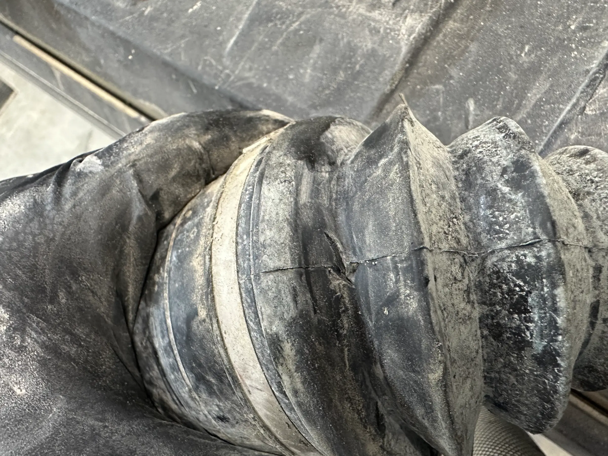

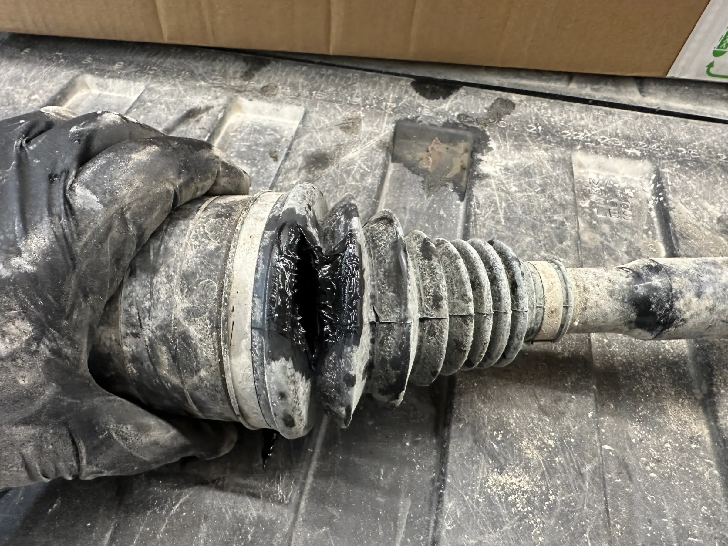

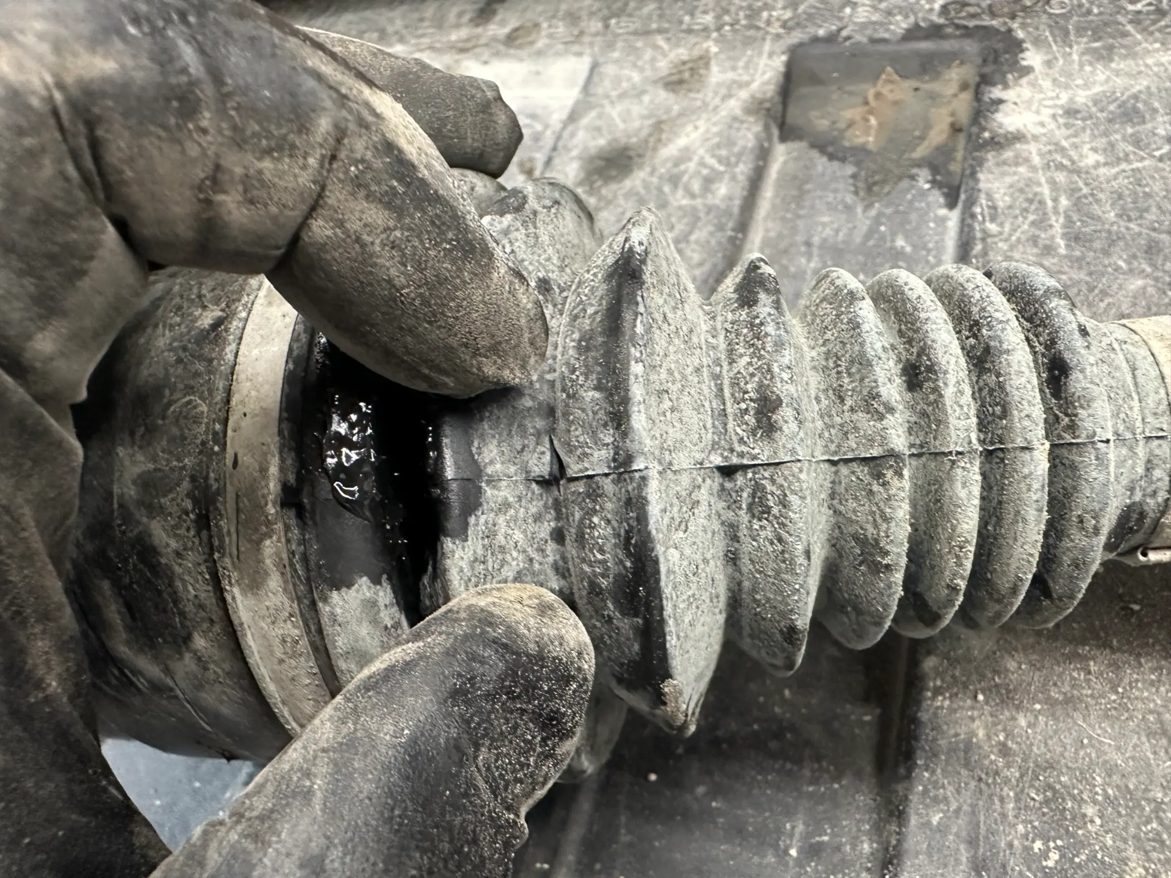

Bad news guys. The boot lasted 300km. It’s cracked on all the ribs. Made a mess. So I’d consider niche boots a bad investment. Never leaked on the clamps though. lol.
Ugh, sorry to hear that! Is it excessive CV flex, or is there something that is physically coming into contact with it? It seems strange that it would only affect one boot and not all the rest of them.
I originally spun the factory boot on that inner CV in the winter. I bought a aftermarket replacement boot and it is not the quality of the factory boots.
Well that’s the shits. I guess cheaper isn’t always better. Sorry you gotta do it all again so soon. Thanks for the update. Glad I never bought any now.
