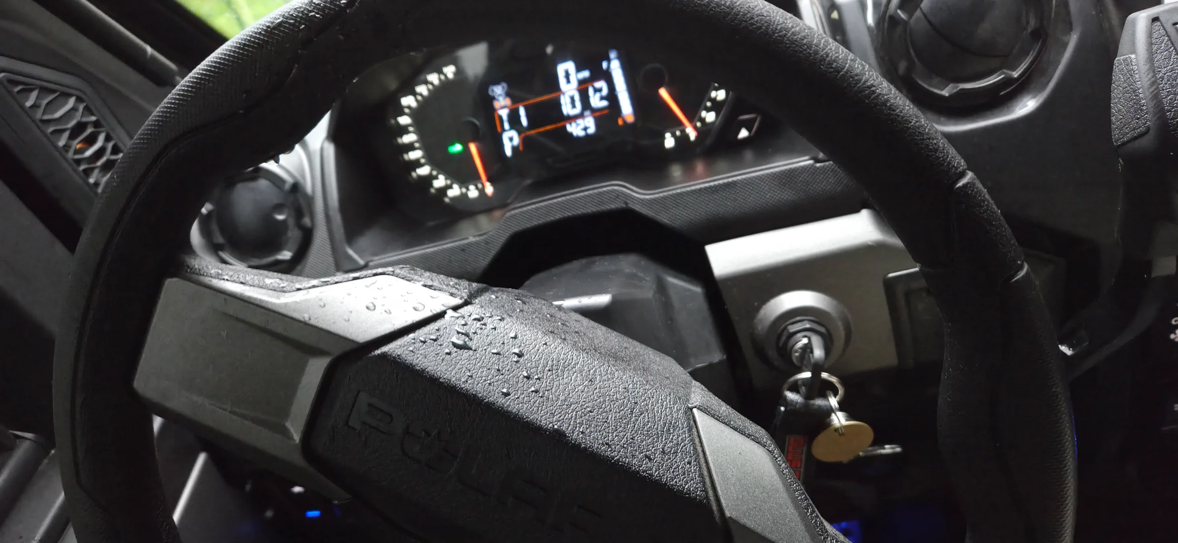

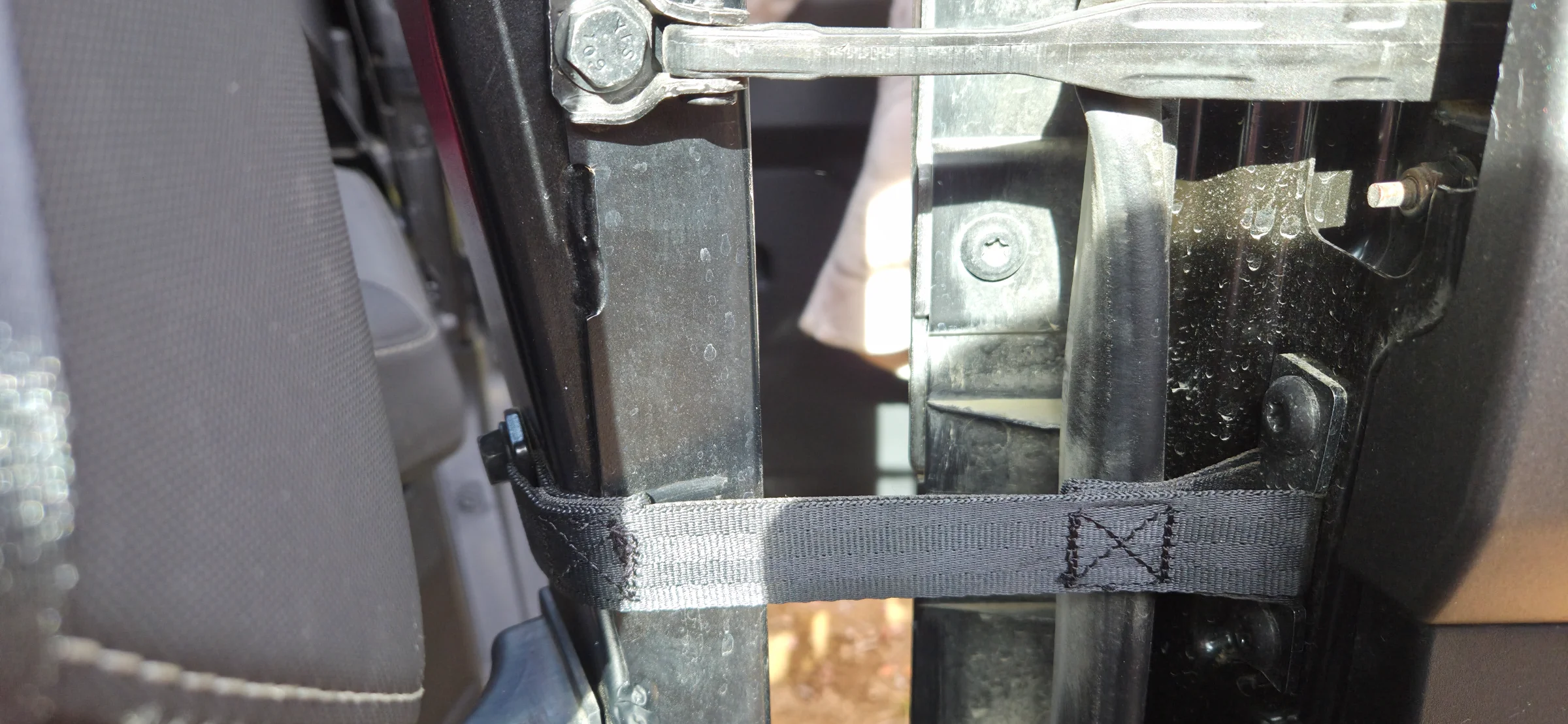

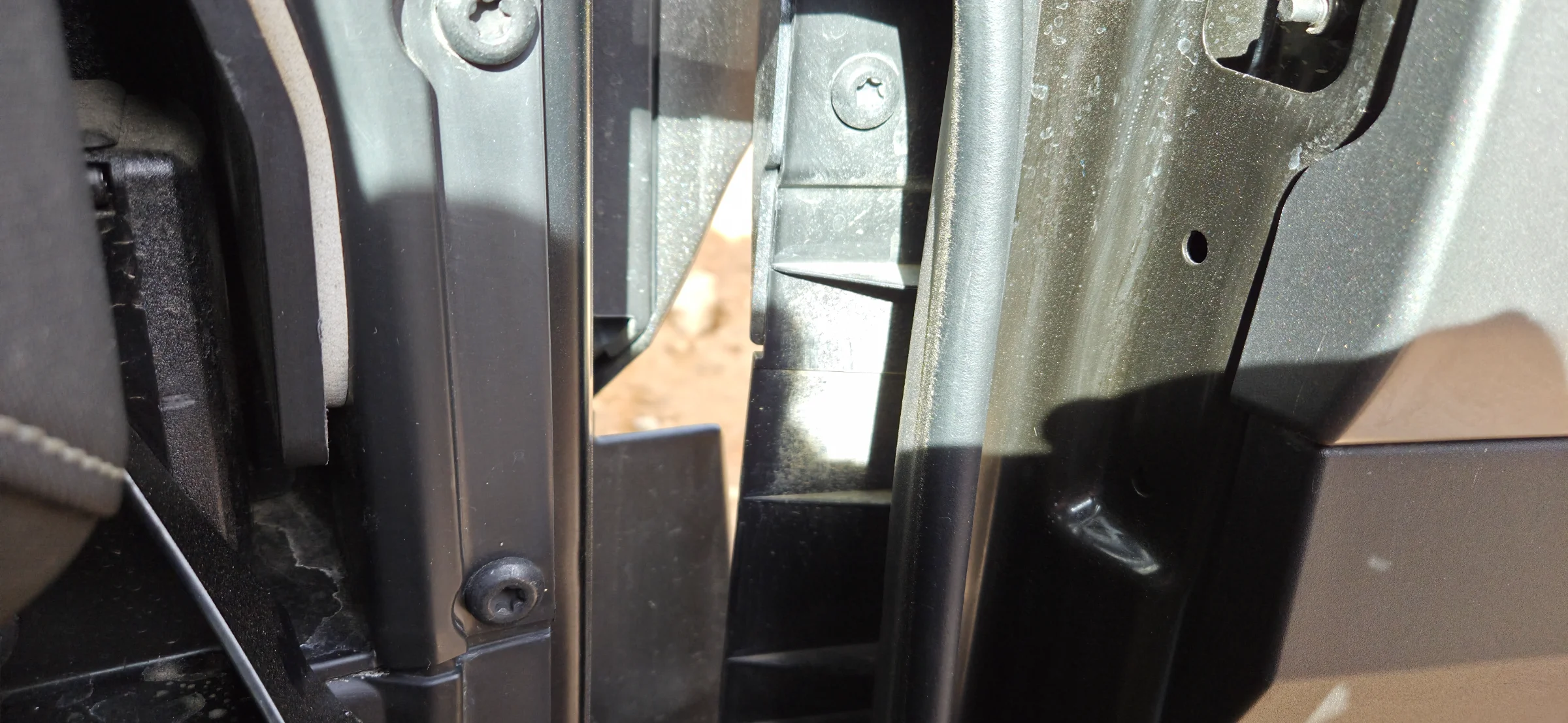

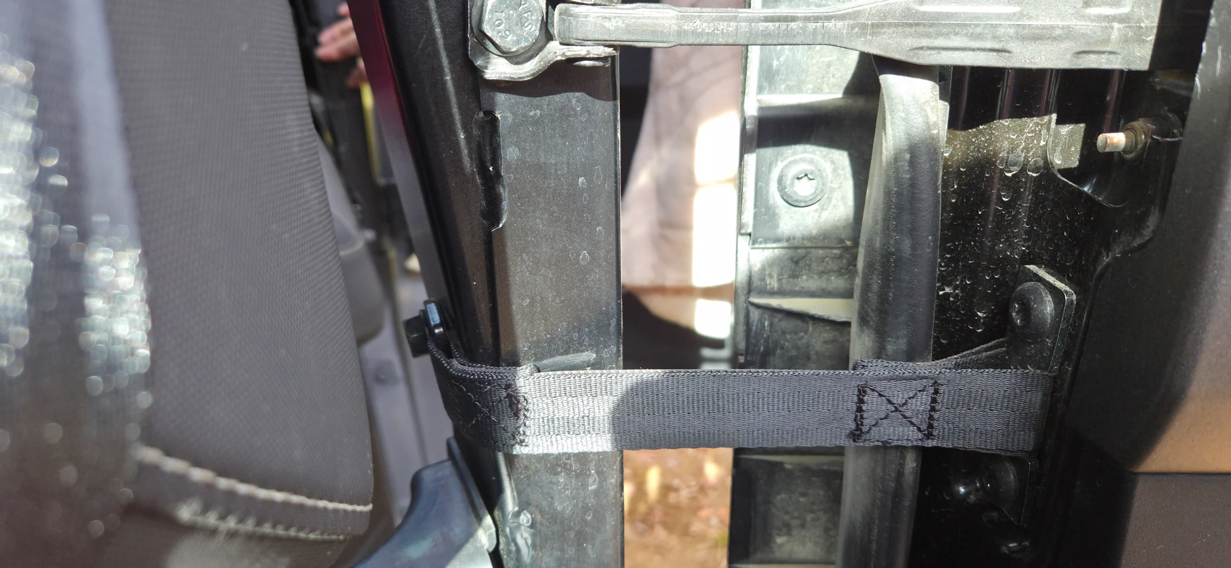

I just went on a ride through Lewis and Clark Motor Way road and I started getting rearend clunk coming out of a kelly hump ( water bar). Machine has 1850 miles on the speedo. Several things happened during this trip: never had any water issue in those miles. It rained pretty hard that night and I had about 1" of rain on the driver side floor board, machine was setting front end downhill. It was coming from above the steering wheel and window. Clean mess up and road another 120 miles in rain and never had any issue? On a side note we had three Rangers XD two two doors and one four door. The four door has a door stop strap and all four doors as the two door has none. One friend was going down the road and his door was not shut and his door opened up and it pulled out of the door stop ball slider and broke both hinges at the seat. where it is set to be from factory. Sorry I went down the rabbit hole. Look at picture of four door straps. Then I have one picture of my 2025 XD Ultimate
