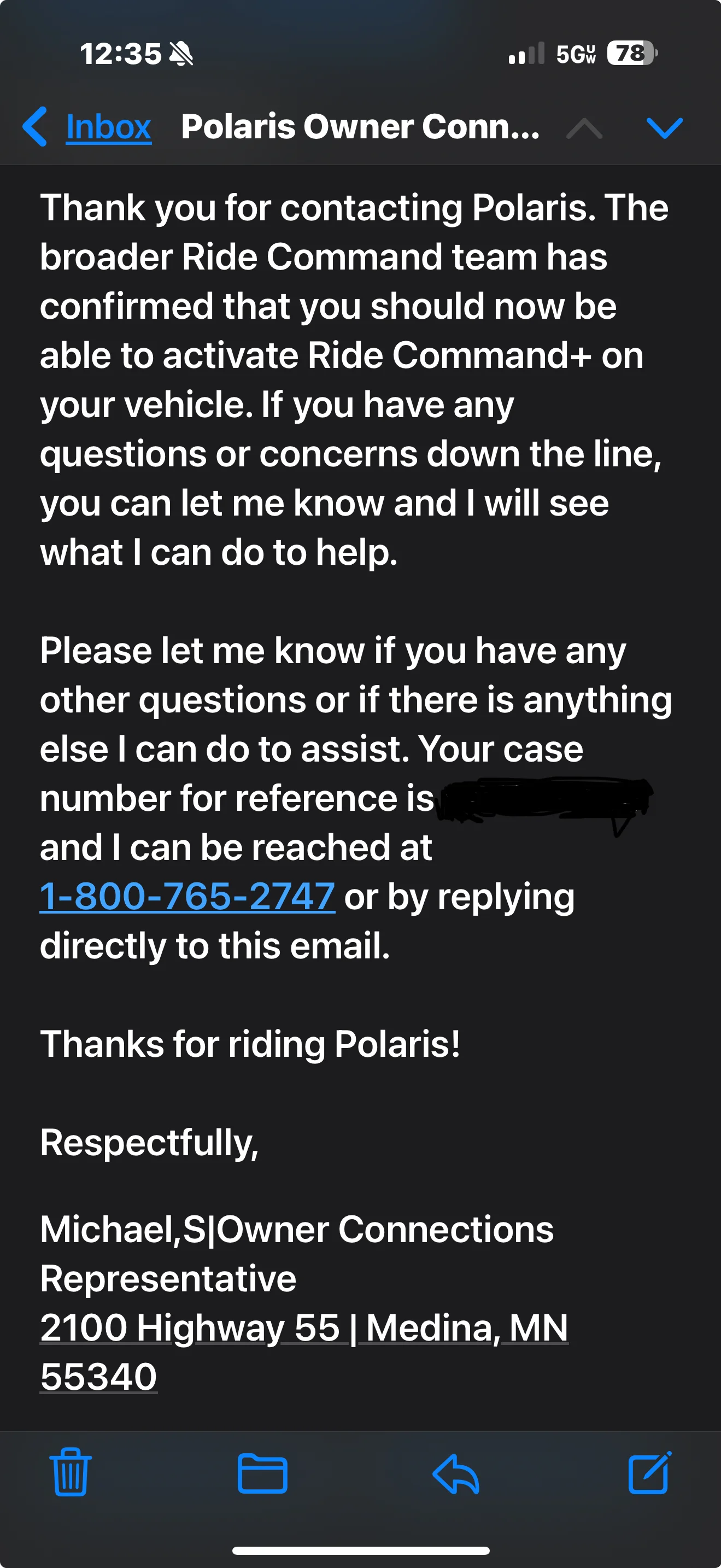

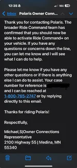

So a little update on my situation. I actually reached out to Polaris on Wednesday evening to tell them what my issue was. I was actually not near the machine when I called them, but I wanted them to be aware that I was having an issue so that like what was mentioned above, if it’s on their end, they could work on it.
The representative mentioned that I would need to be near the machine to be able to diagnose what the problem was. I understood and agreed. She set me up with a case number, so I could call back the next day and get it sorted out when I’m near the machine.
When I got in my machine the following day, I tried to go through the steps of activation before I even reached out to Polaris, and everything went through seamlessly then. No call needed.
I then received an email on Friday indicating that they knew on their end. Everything should be straight. They also included a phone number so that if anybody else has this problem, feel free to use that number.
Hope this was helpful
