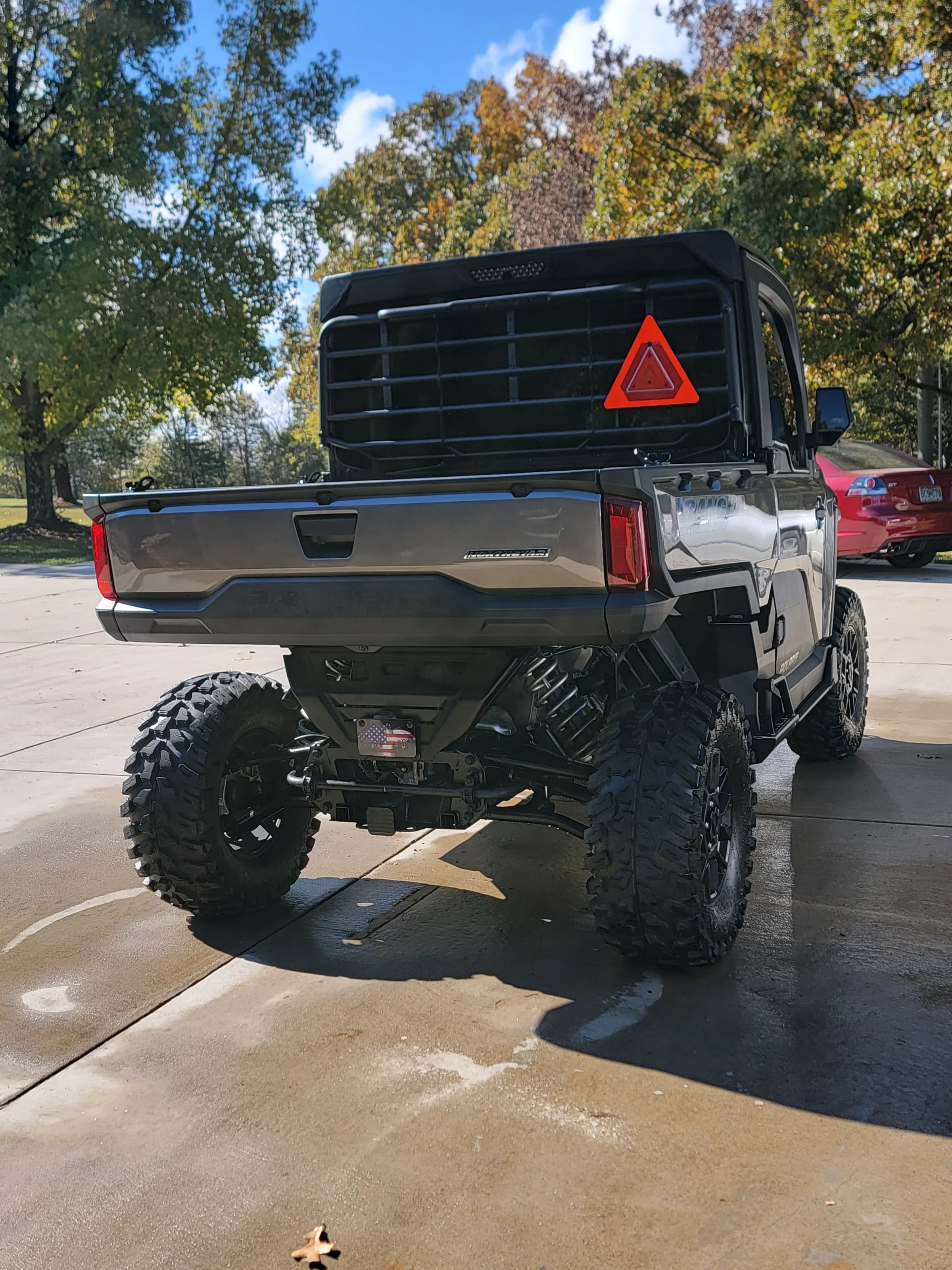

Picked up my new XD 1500 Texas Edition yesterday and getting it street ready… must have a safety triangle… any pics or input on best location for looks and appearance?
Where ever there is room.

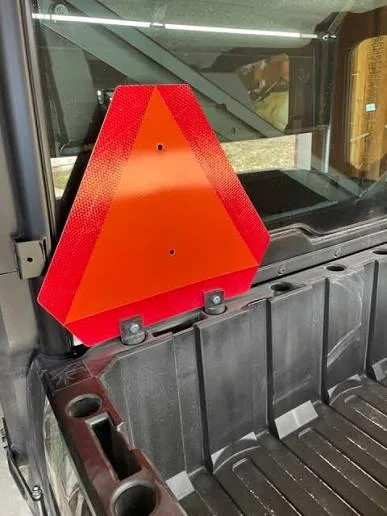

Remember if you trailer your Ranger you have to remove the SMV sign or cover it up. It's no longer "slow moving" if it's going down the highway on a trailer at 70 mph. I don't know if it's ok to mount them upside down as shown in the picture above...........I've never seen them displayed that way and would not want to give the Po Po a reason to discuss it.
Here is how SMV signs are supposed to be mounted.
To display a Slow-Moving Vehicle (SMV) sign, mount the reflective orange triangle point-up on the rear of the vehicle, centered as much as possible, between 2 and 6 feet off the ground (measured to the bottom edge), and perpendicular to the direction of travel, ensuring it's clean and doesn't block lights or reflectors. Use mounting brackets or secure it well for vehicles like farm equipment, ATVs, or animal-drawn carts.
Mounting Guidelines
  • Orientation: Always point the triangle upwards.
  • Position: Center it on the rear of the vehicle as much as possible.
  • Height: The bottom edge should be 2 to 6 feet above the ground.
  • Angle: Keep it perpendicular (straight up and down) to the direction of travel (within 10 degrees).
  • Visibility: Ensure it is unobstructed and doesn't cover other lights or reflectors.
  • Condition: Keep the sign clean and reflective; replace if faded or damaged
FYI if your looking for a good SMV sign. This is the last one I bought and is much better than the steel, aluminum, or cheap plastic ones with the webbing on the back. This one is about 1/4" thick and solid orange plastic.
