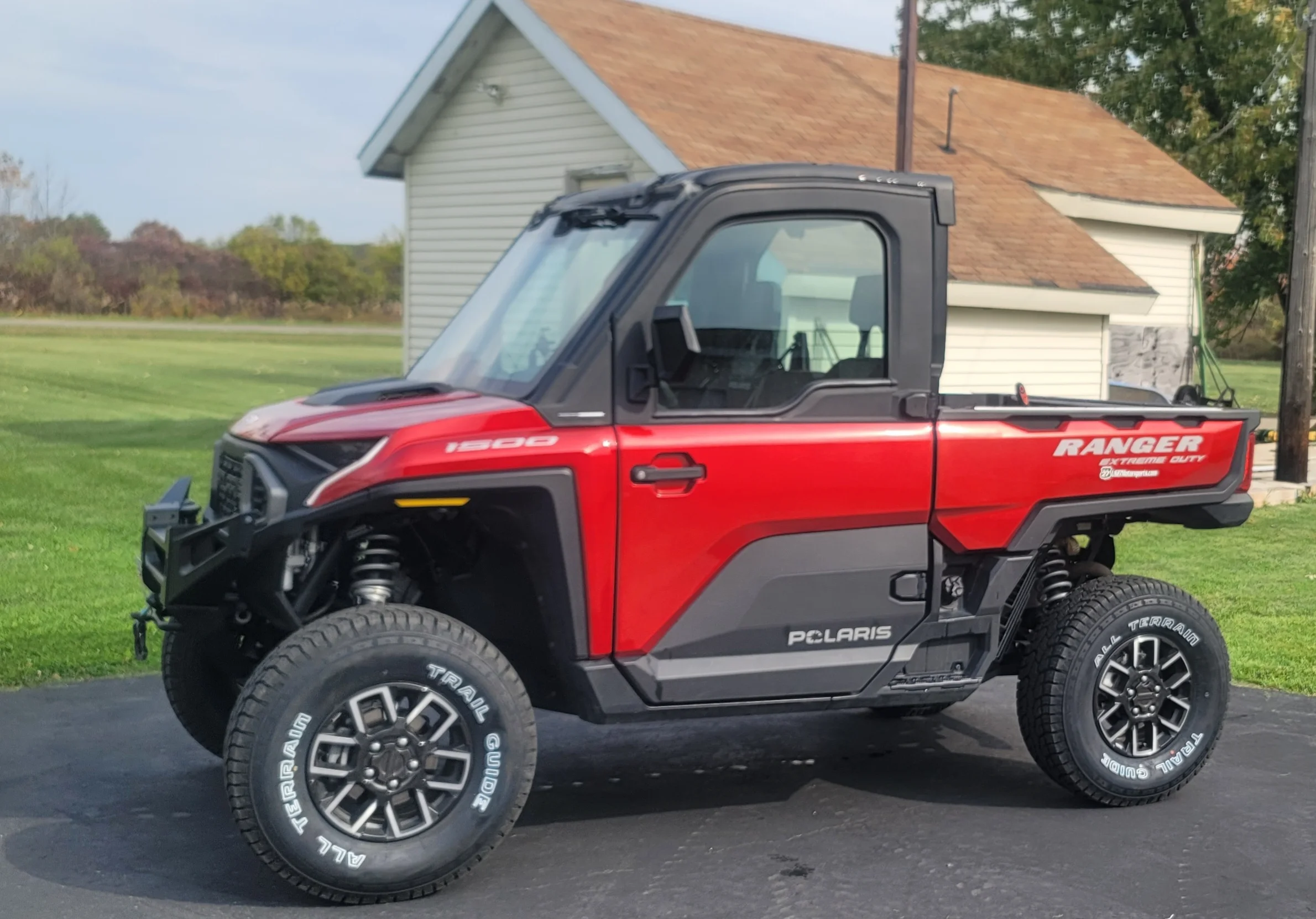

I did trail guide all terrain 31 inch. 30 psi is a good ride. I might try 25 psi. Actually get 1 or so mpg better ......

Does your ranger feel like it’s not as stable with the 10s in rear
Ok. I’m running stock wheels. It’s seems like it has a sway to it.
Your sway could be the stock setup. The wider rear tires on the stock rim, cause the tires to pooch. The tread width is wider than it really should be with the measured rim width, causing the tire to what I call pooch. So the side wall flexes under cornering. I had a truck that had 35x12.50R20’s on it. And when I towed my toy hauler, I could feel like the rear end was washy/squishy. I went to a narrower tire and issue went away. I have the same setup as clubin and zero issues. Although I am do to rotate.

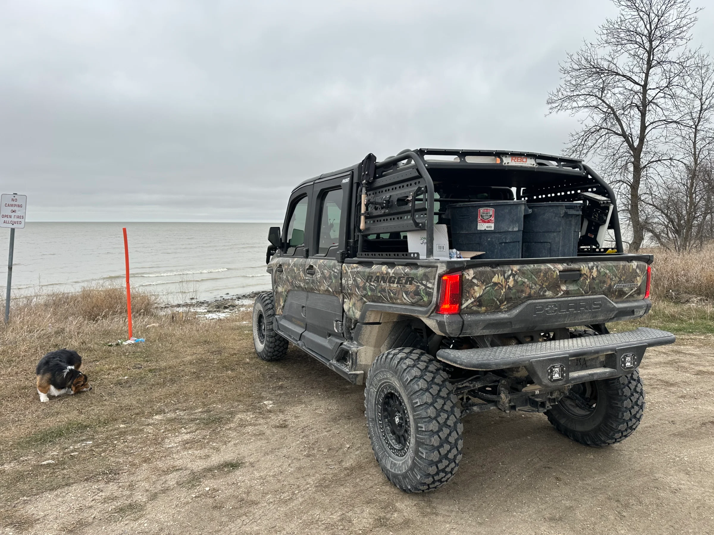

Looks like I will probably get more than 12,000 miles based on what Rupp Collector has experienced. A friend of mine has 12,000 miles on his 30" tires and they are really chewed up, that said he only runs gravel which is much harder on tires compared to what I run.
Are these KM3's Big Red?
Yup, 10 X 32" UTV version. This is the first set of KM#'s I have ever had so I'm only guessing how many miles they will go.....my only reference point is a buddy of mine has wore through a set of 30" tires around 12,000 miles of hard gravel use. Last I knew he was still running them but they were really chewed up.
