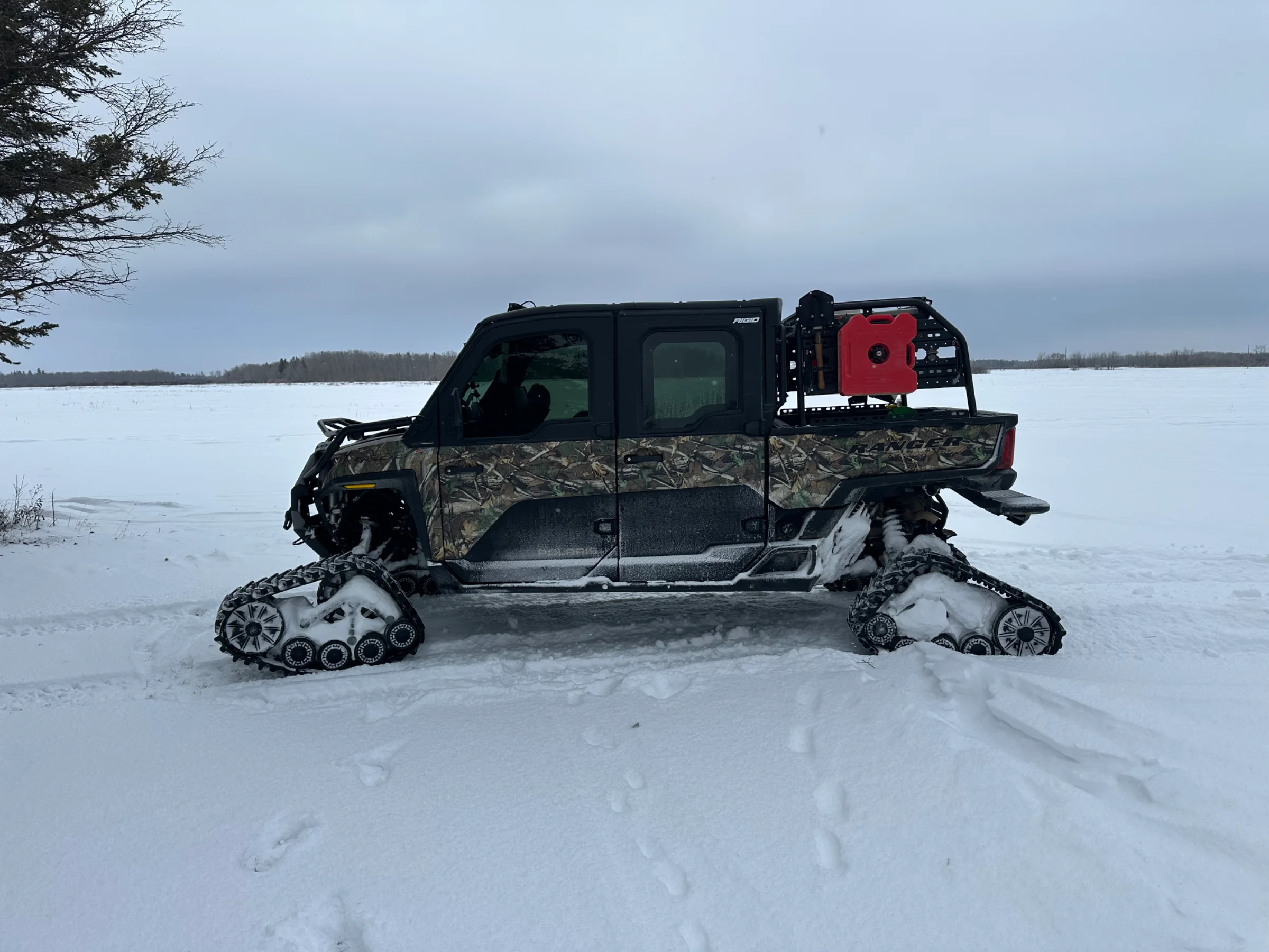

It will steer tracks with no issues. Plus I run 32” alpha Valor
