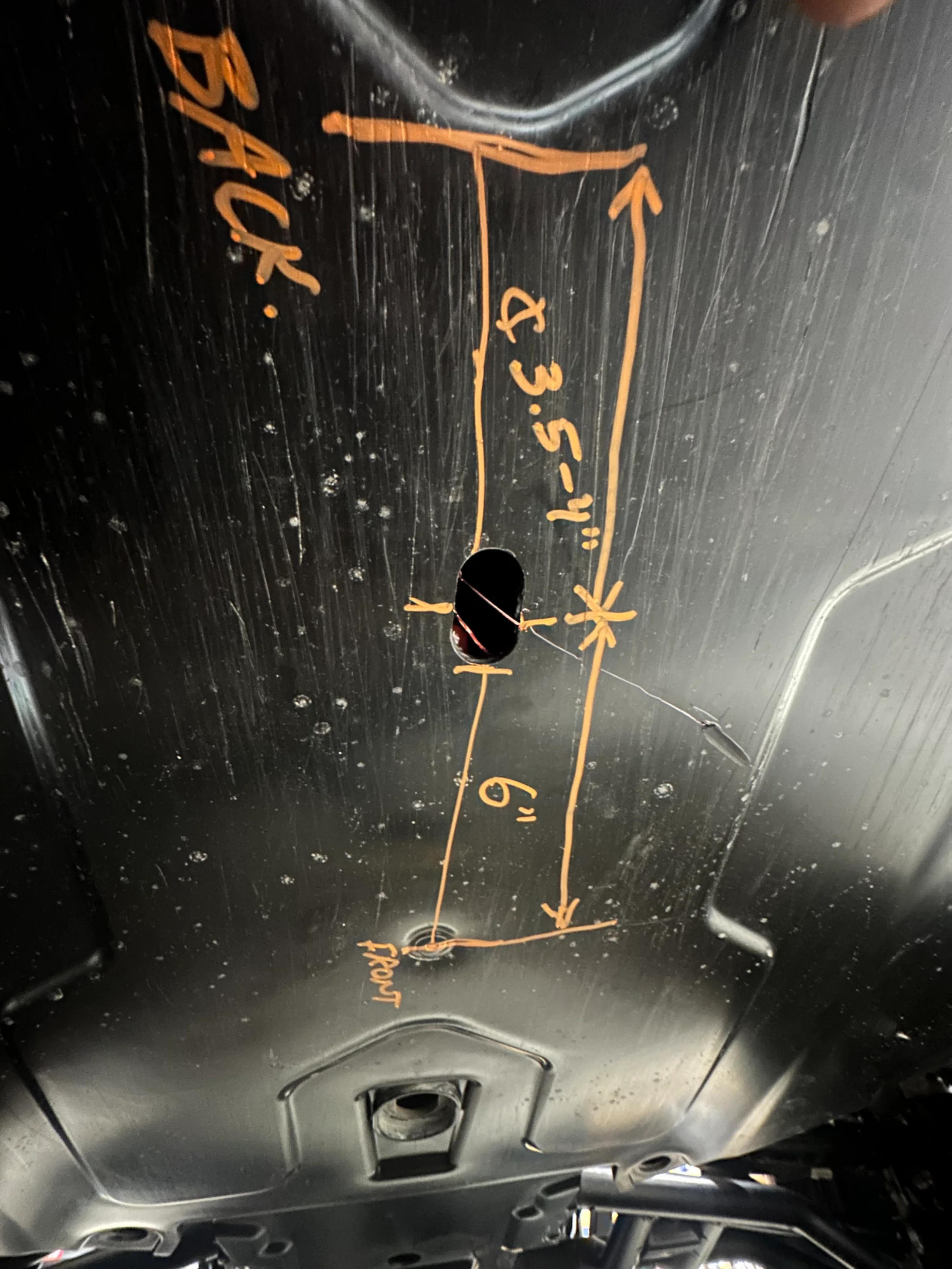

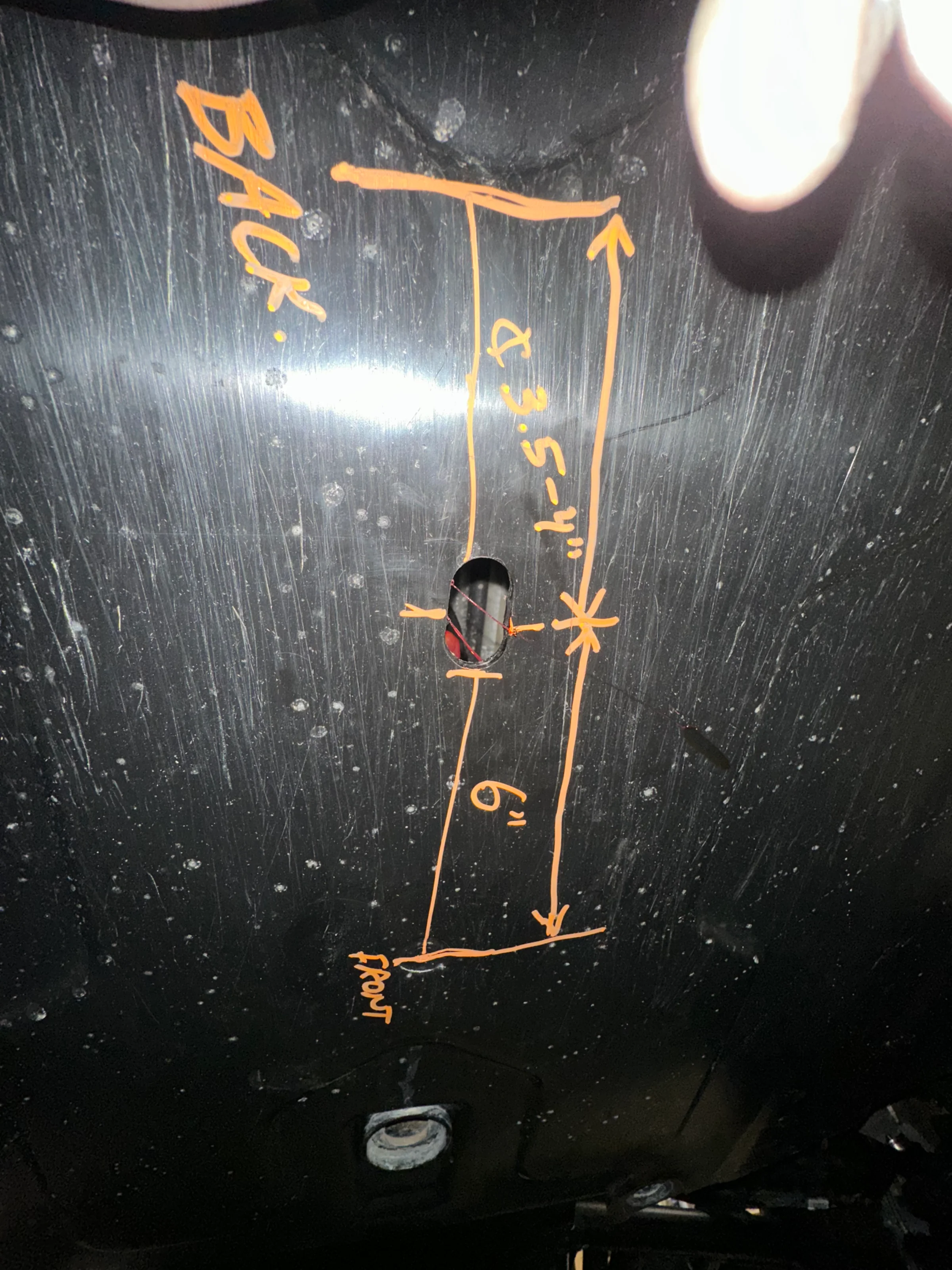

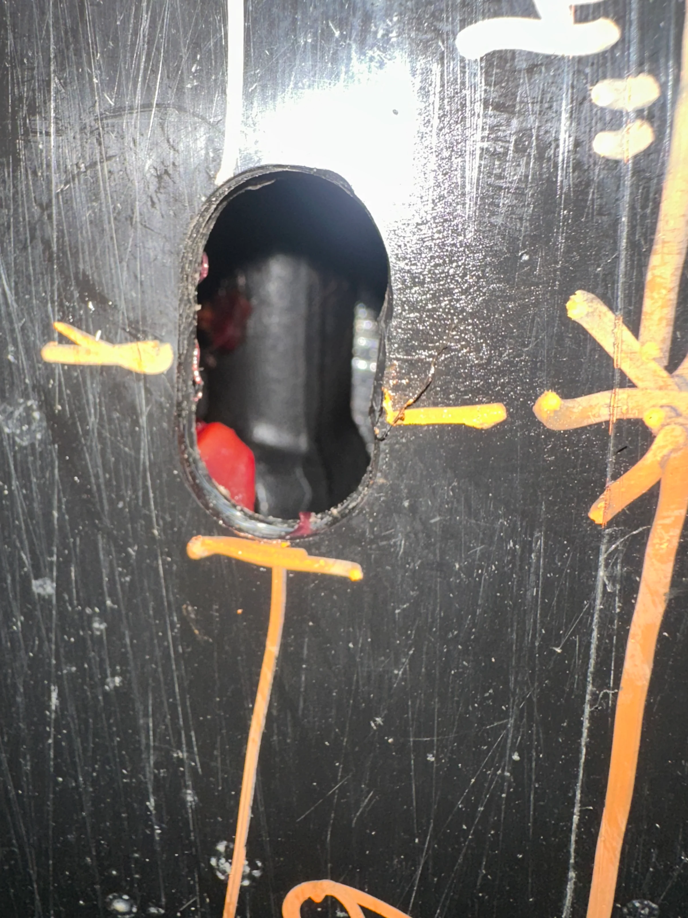

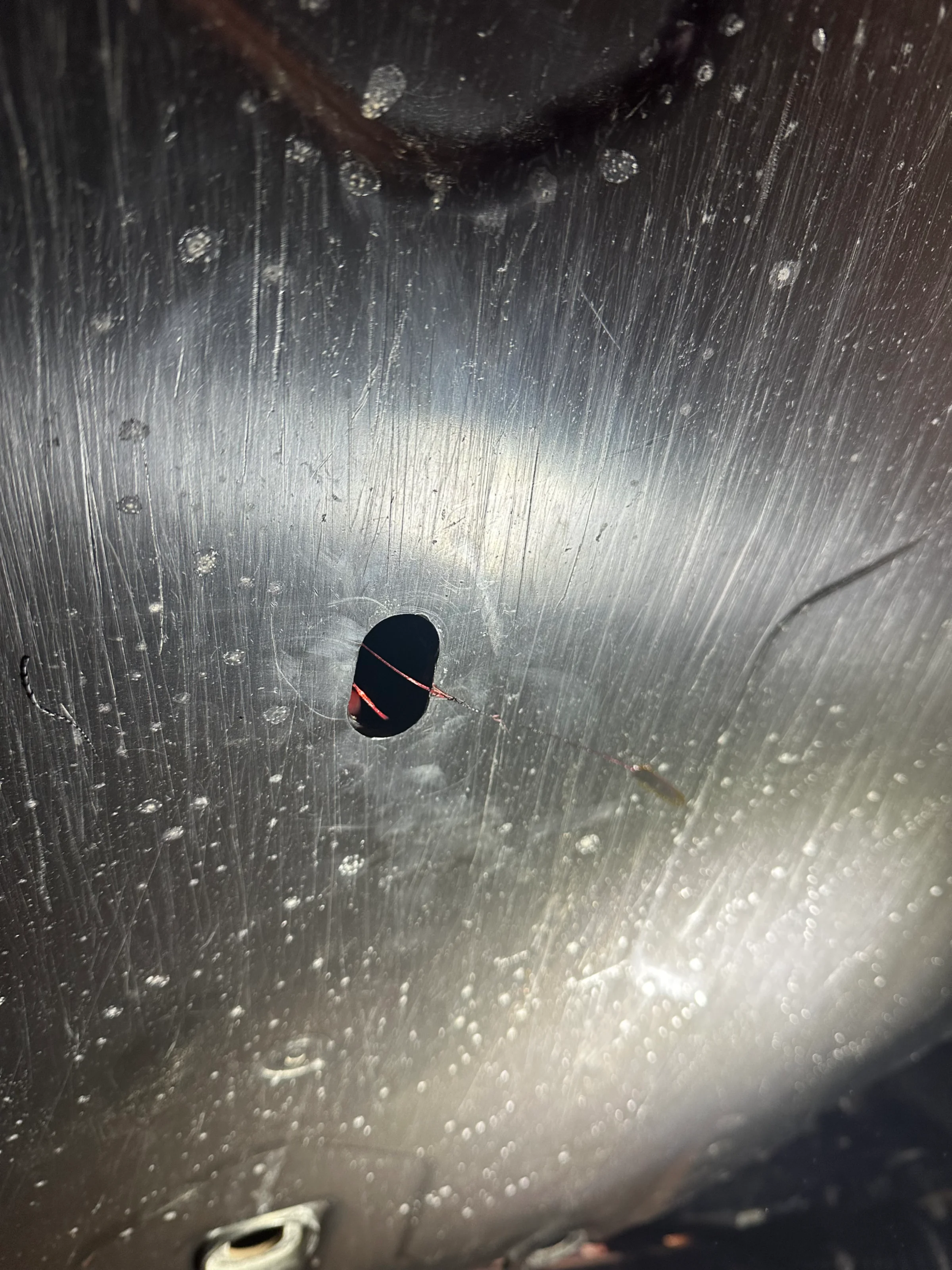

For anyone that’s interested here’s a measurements and location to drill a 1 inch hole for accessing the front Grease Zirk on the driveshaft. I drilled a 3/4” oval hole. Only because that was the way it worked.
This is for a crew. The rear grease Zirk on the front of the transmission can be accessed through one of the oval holes on the plate below the transmission.
For anyone that’s interested here’s a measurements and location to drill a 1 inch hole for accessing the front Grease Zirk on the driveshaft. I drilled a 3/4” oval hole. Only because that was the way it worked. View attachment 4686View attachment 4687View attachment 4688View attachment 4689This is for a crew. The rear grease Zirk on the front of the transmission can be accessed through one of the oval holes on the plate below the transmission.

I had my center console out for a bit, and drilled a small pilot hole below the zerk on my 3 seater. I'll try to get measurements at some point.
