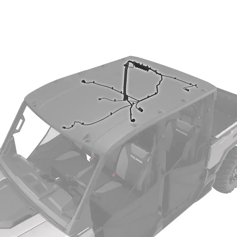

Has anyone taken pics or videos of the electrical connections at the rear of the cab on an Ultimate model?
I want to know what I am getting into before removing the head liner.
Does this help? The 4 door is the same except the wires from the front to the back are longer.
Thanks! You were up late researching this!
So, the big block in the back would be my power connection?
Not up late, rather up early. Yes the Pulse bar is in the left rear corner. You should see an access panel up above the passenger seat.
