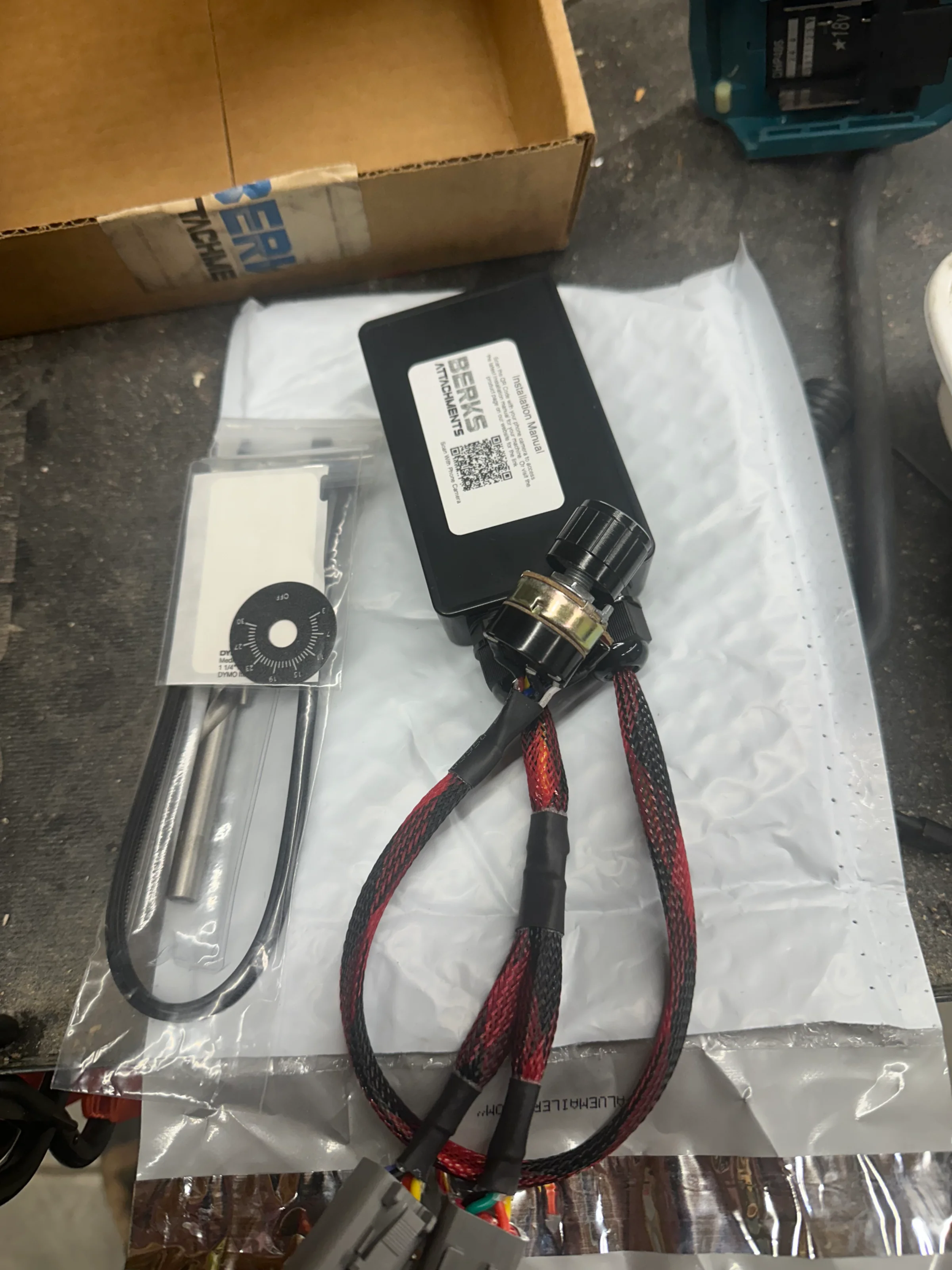

Pick this kit up as many of us have. Install was easy. I will attach a bunch of pictures.

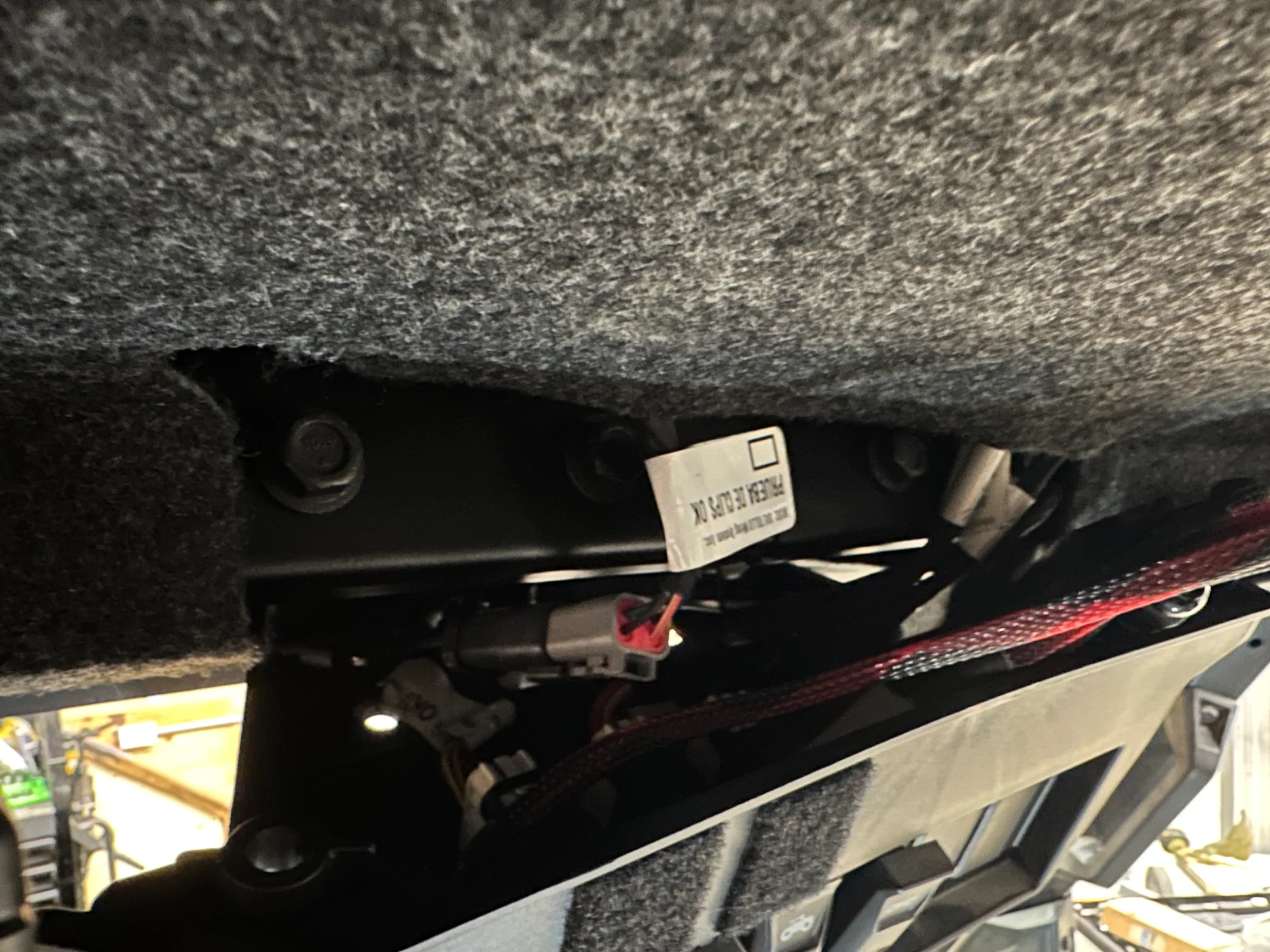

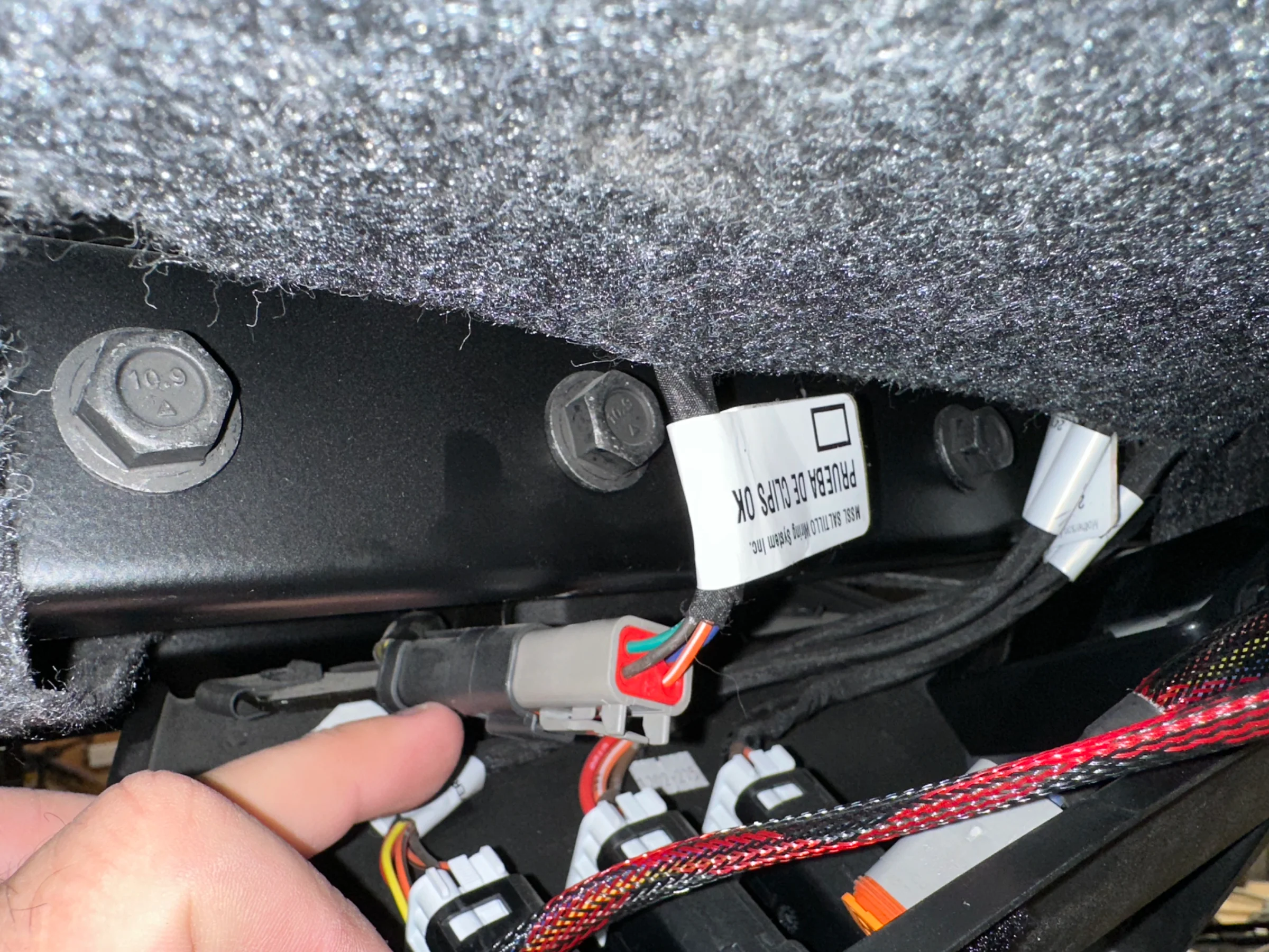

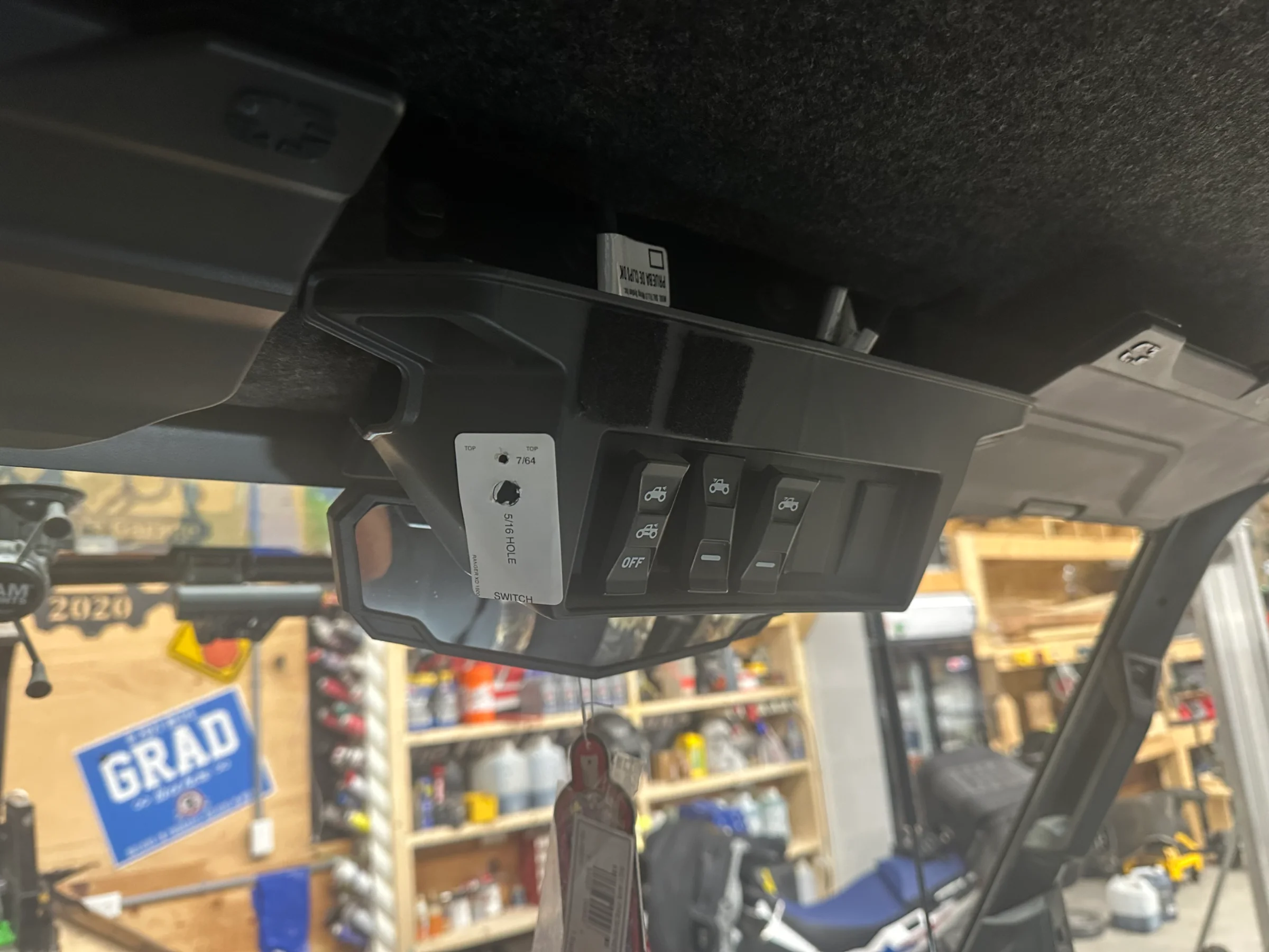

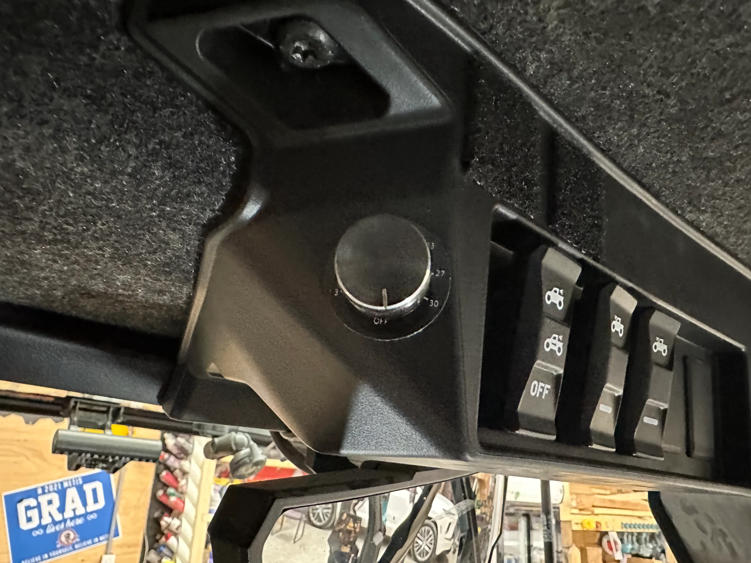

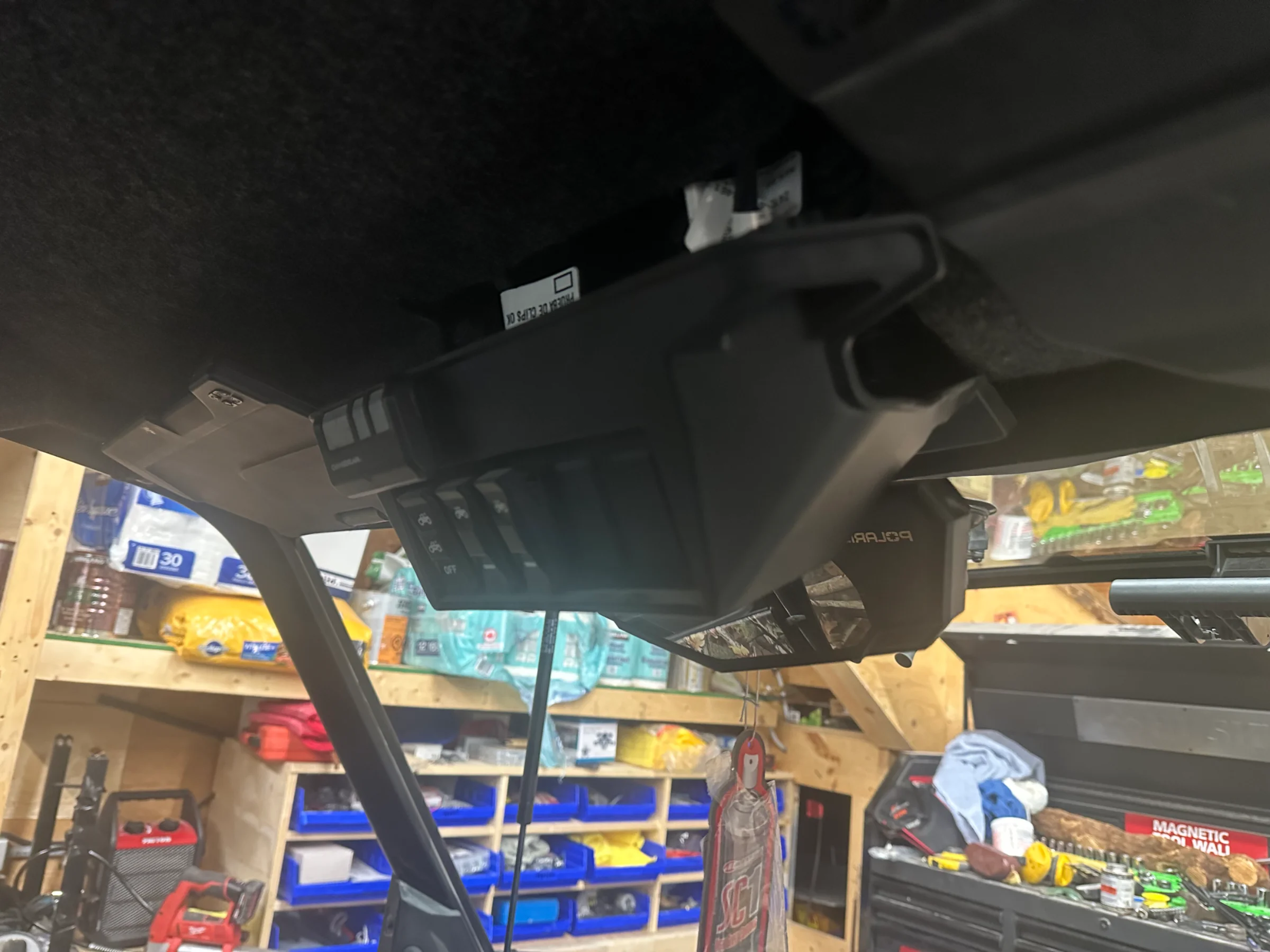

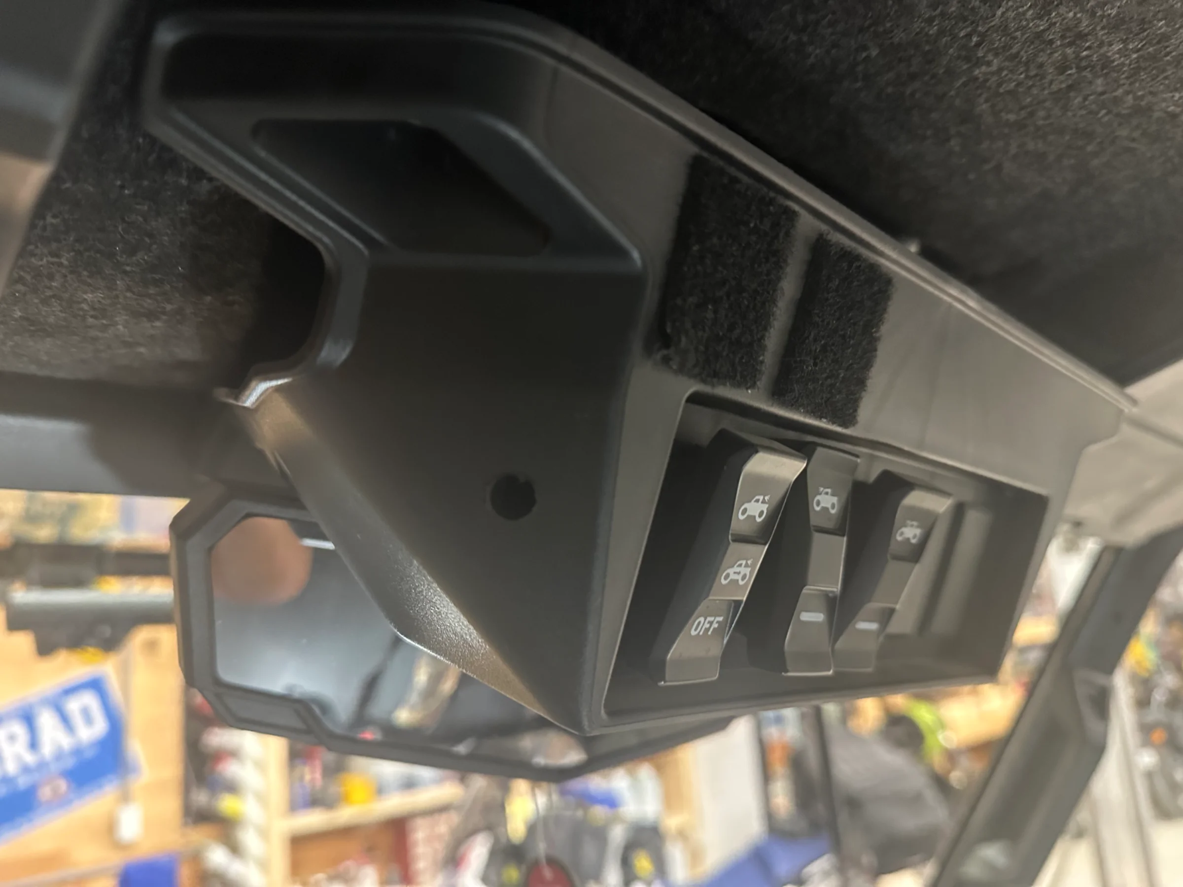

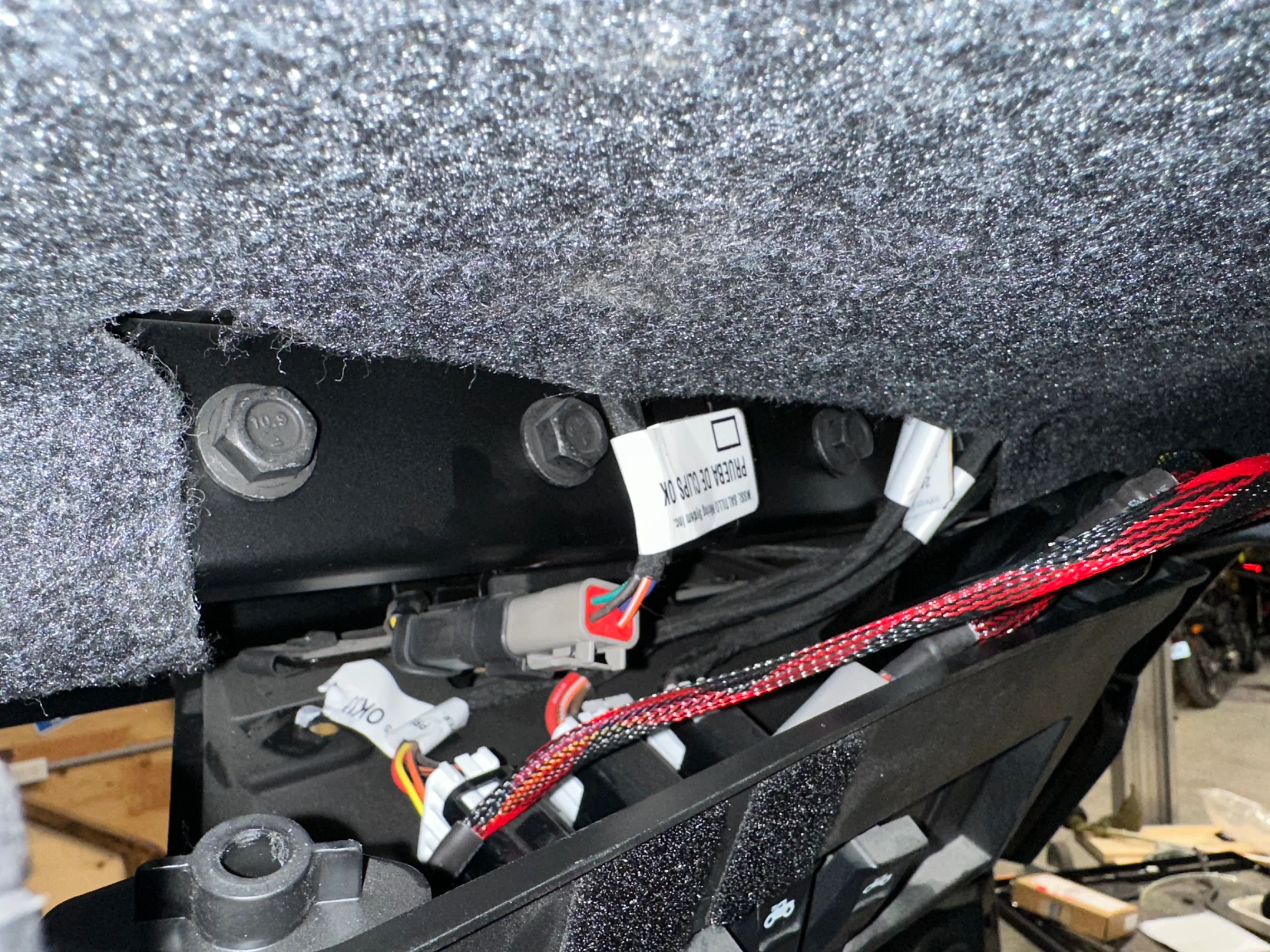

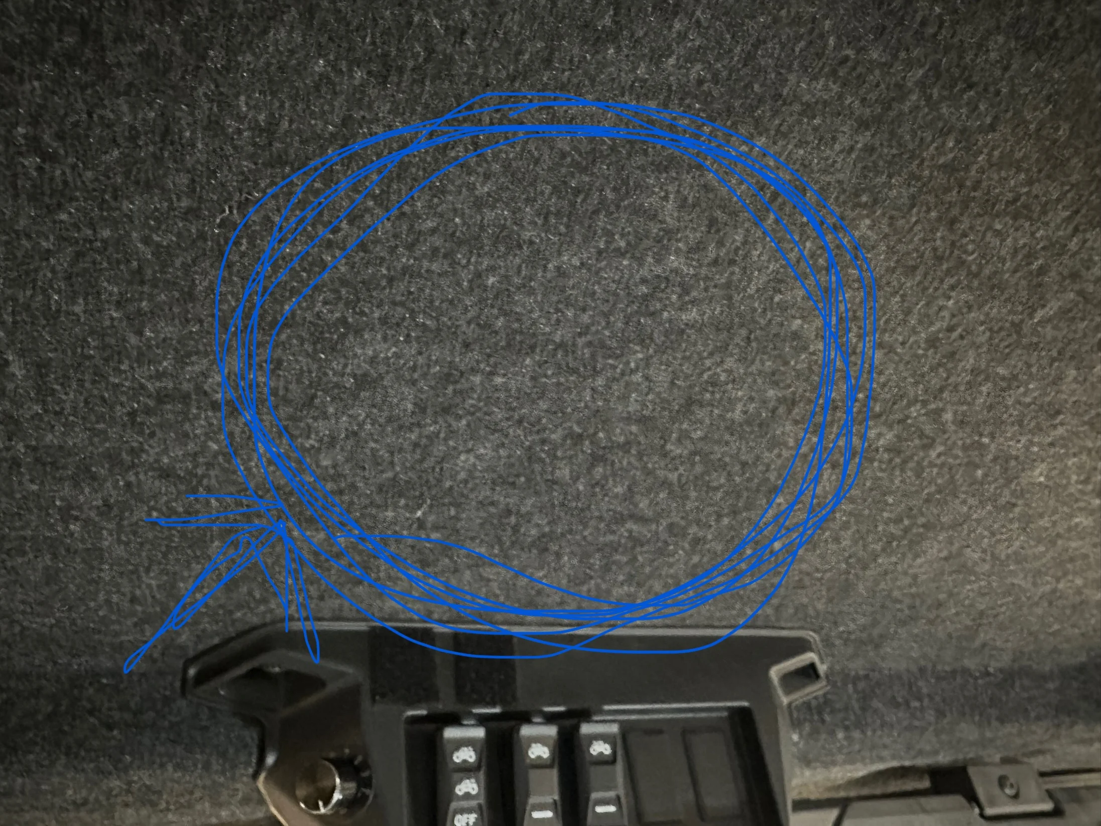

The instructions the manufacturers provided are very good, they are found online and I just took screenshots of each page. I encountered one problem with mounting of the relay box. I had extra switches up in my upper box. I mounted my relay box above the headliner. I will attach a picture with the area circled in blue. Theirs is There’s enough wire to reach there, and there is enough room for the relay to stay there. I also mounted the delay switch not in a switch mount, but on the left-hand side of the upper switch cluster. Lots of room to mount it there. I just think it looks better, and I think it looks better.
Oh and it works perfect. There is a light click when the relay activates but when driving it’s not noticeable. I do think it looks better.
The drill bits included in the kit are very good too.
