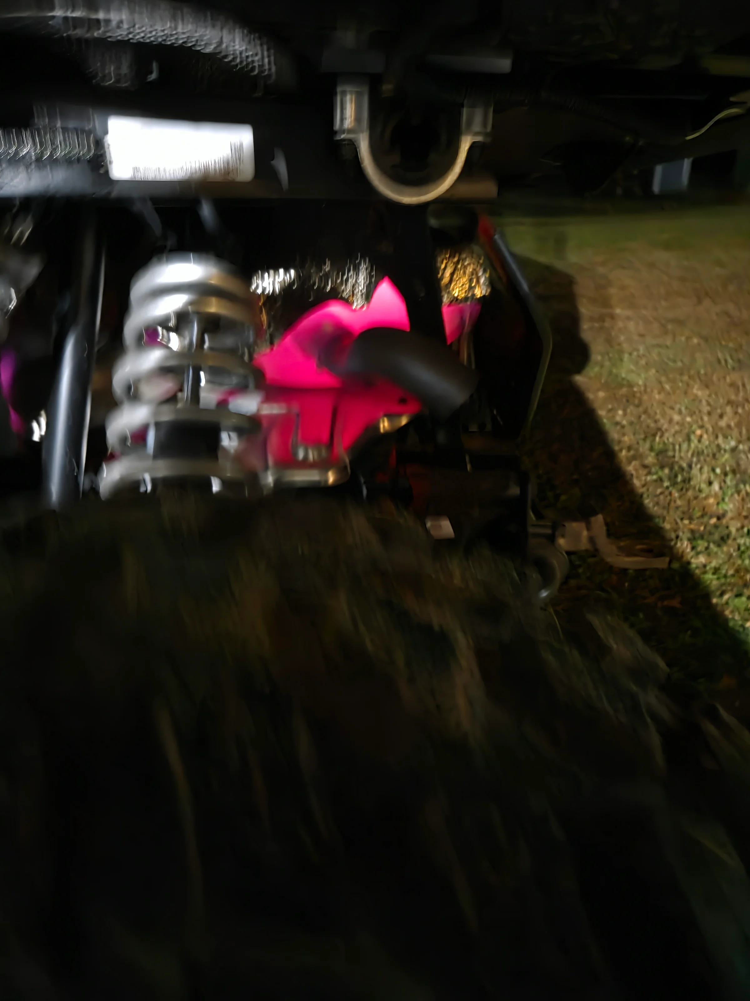

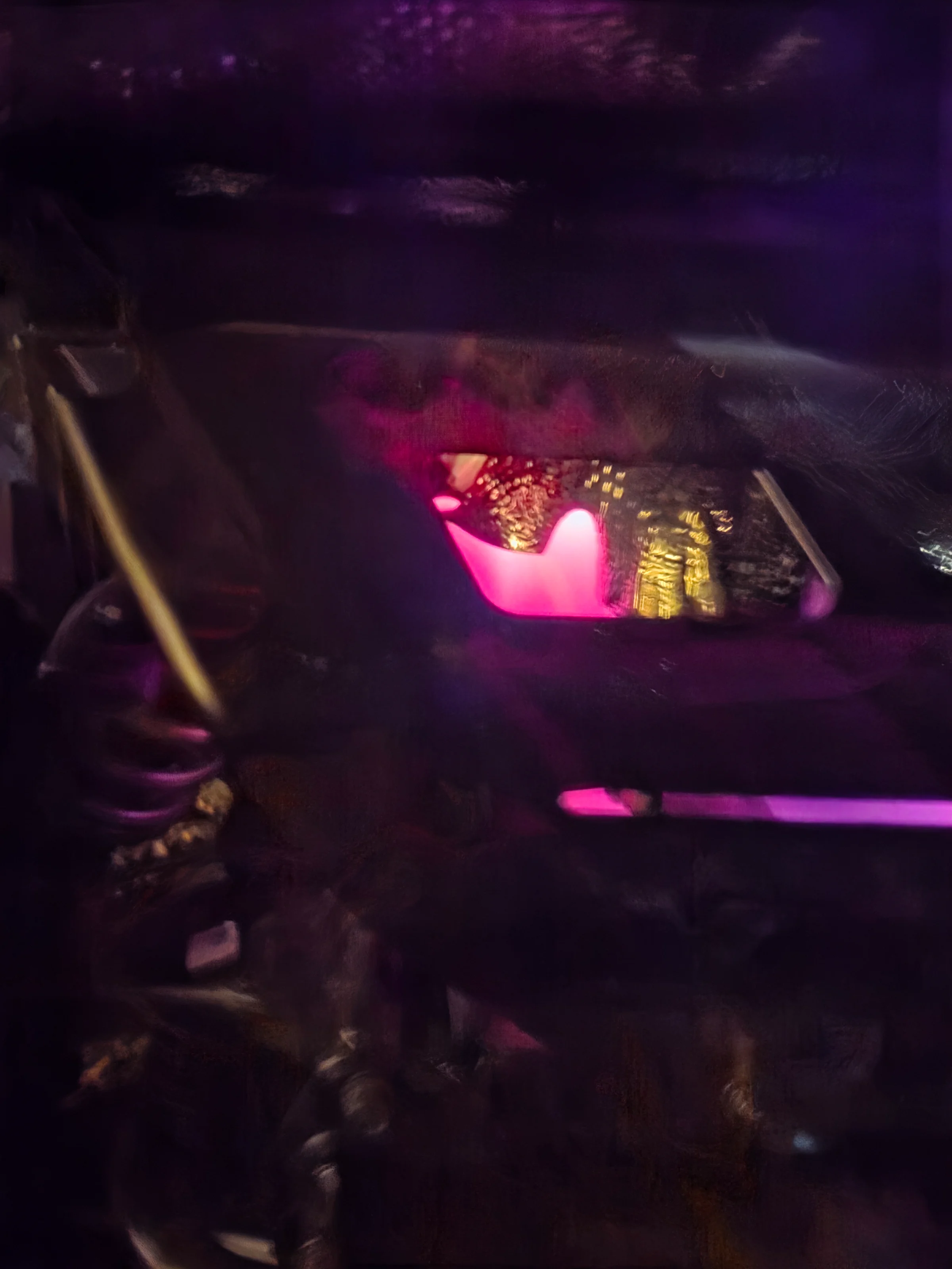

Just took mine to my brother's last night during the dark , 1st thing he noticed was the glowing red. I'm also curious if taking ithe Cadillac converter out worked? is it still glowing red hot? Is it raining just fine? Any dummy lights come on?
Run just fine. The converter is after the sensor so nothing changes in how the engine runs. It should is a touch louder but not bad. No lights on and no more glowing red. The converter is right where the muffler is glowing in you pics
