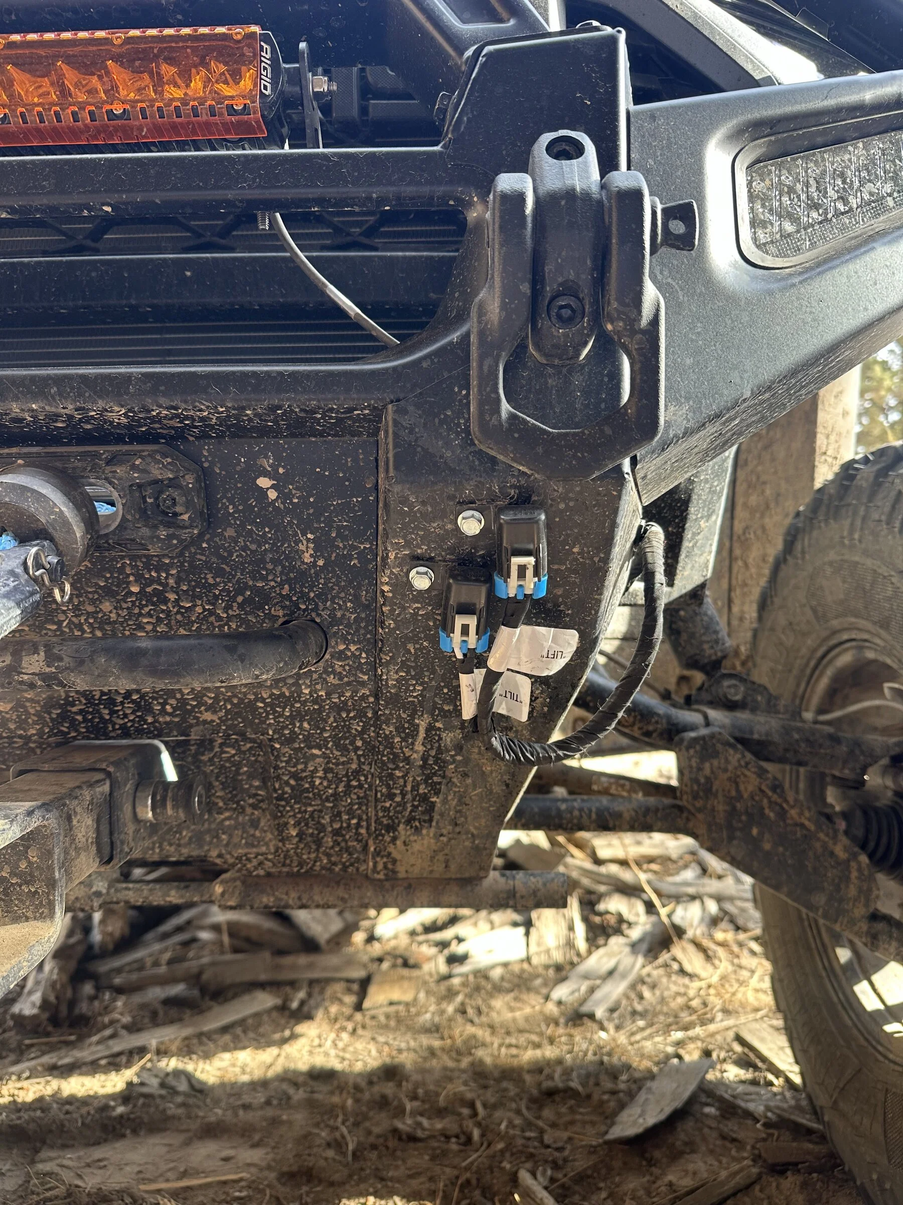

Not sure on the whole install, as my dealer pretty much installed all my options that I didn’t want to deal with for a very minimal cost. And I wanted to pick it up fully done. But this is how they secured my plow control wires on the front of my bumper. They’re covers for the electrical connections and screw into the bumper. I’m gonna either paint them black, or buy black ones. Either way, here’s a pic.

Plow connections are a bit of a personal preference thing. I bush wack lots. So my connections are tucked in so they don’t get ripped off.

Thank you for the suggestions. Yes I have my cables tucked behind the winch fairlead, under the winch line. It stayed in place during our ride so that’s good. I guess I would have just though there would be a more polished setup.

The blue connector doesn't bother me as much as the dealers running the wire down where something on the trail one day will rip it clean off your unit. As soon as I saw that I rerouted it though the center hole of the front bumper where nothing can reach it.
