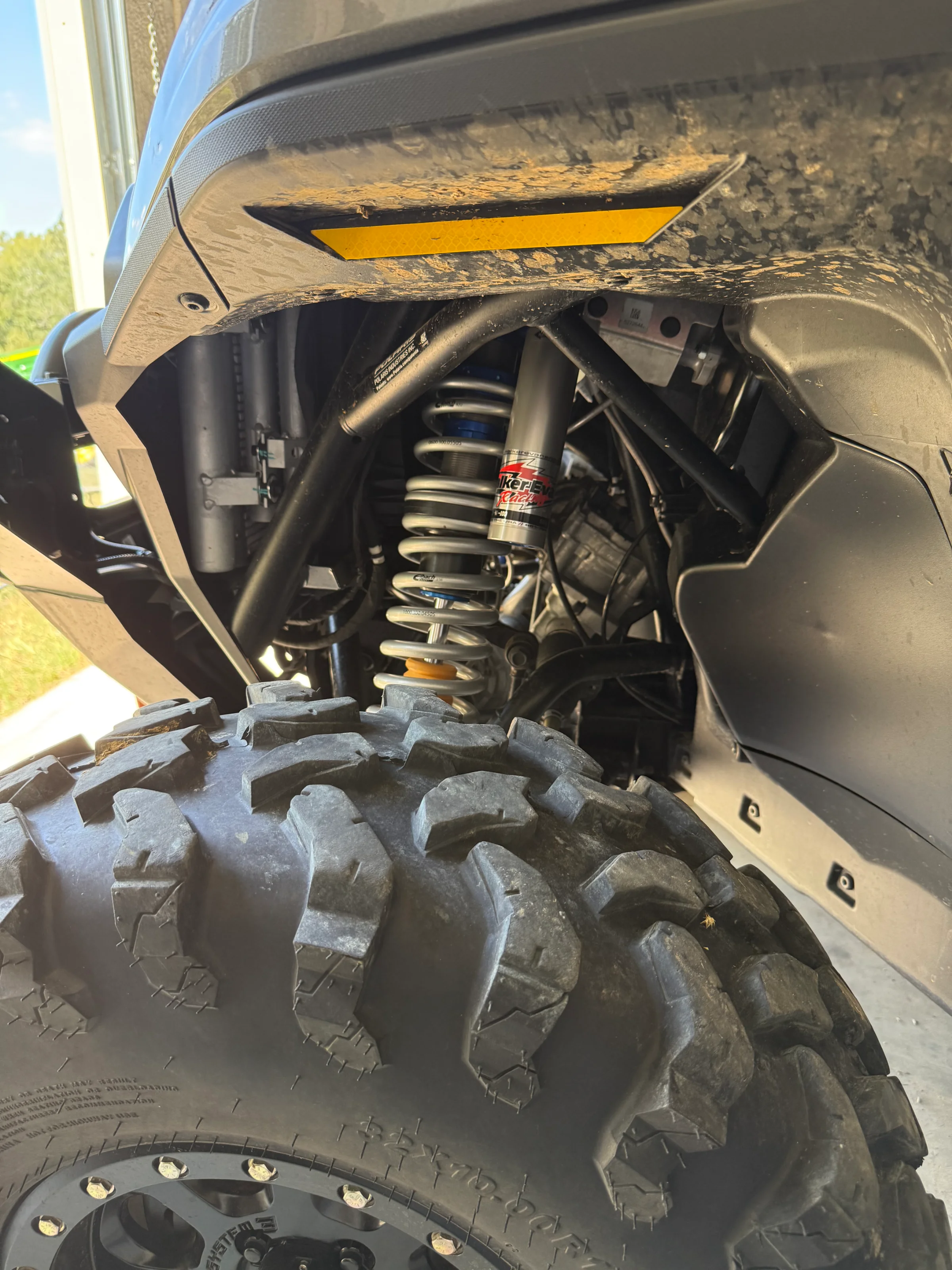

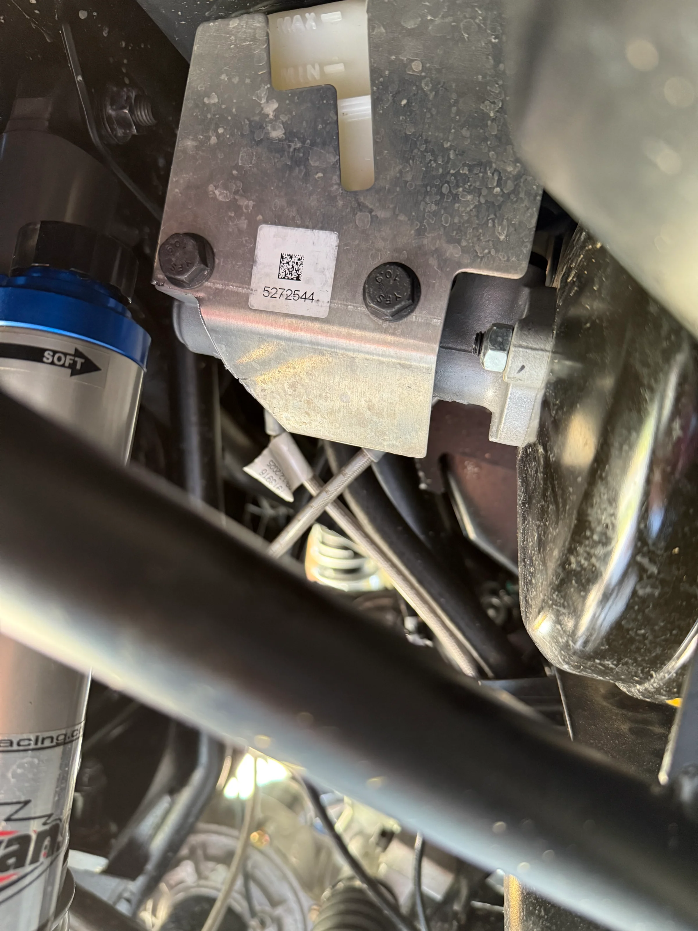

Alright, got them installed. Longer ones on front as front stockers were a little more than an inch longer than rears. Ride quality is substantially improved. I do need to adjust preload for some more ground clearance as shocks are set at stock ride height as I like a tad more. Just now started messing with clickers on shocks, so far, so good!
I did have to trim the protective master cylinder plate a tad as the reservoir was less than a 1/4” of clearance from it. Used tin snips.

Looking at Boomers photos the front shock has 550 lb on top and 450 lb on the bottom , I don’t see how the crossover's would ever come into play with that setup. If someone could explain I would like to understand .

Could you tell me which hole you used to mount the front shocks , the inner hole where the stock shocks were mounted the Walker shock body hits on the shock mount ,like shock eye is to close to the shock body. I’m going to try the outer hole next . The top shock mount is a pain to get at , would be nice if Walker could have threw in a piece of paper saying not to use the stock hole . I hope the outer hole has more clearance .
I used the inner hole. Things are pretty tight up there but they go. One thing I can think of, the piggybacks have to be angled towards the back. Not saying you got them wrong, just all I can think of.
They bolted up ok on the inner hole , but there was no room for the shock to pivot . As the suspension loaded the top of shock hits on frame mount , like the eye on the shock is to close to the shock body to allow it pivot on the top bolt . I’m going to try to get them on the phone tomorrow , maybe can get some information . I have them mounted the same as what Boomer has in his photo .
Damn, I went out and looked at mine and I guess I missed that during the install. I haven't been on anything but rough roads since I put them on. No damage done but I don't see any alternative but to mount to the outer holes. I hope it doesn't change things much. If you get a hold of them, please let us know what they say.
I sent an email this morning I hope they respond , there is more clearance on the outside hole . Most seam to think the ride is stiffer on the outside hole. , kind of defeats the purpose of the upgraded shocks. I will let you know if Walker responds , they didn’t answer my questions before purchase .
I suppose the shoulders of the shocks that are making contact could be ground down a bit, but I'm not about to do that with brand new shocks.
