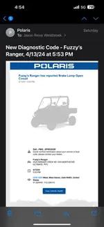

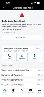

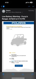

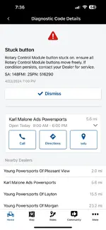

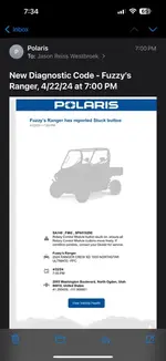

3. I've had problems with the ride command sending me emails telling me there is a problem and an error code but nothing was found at the dealer. The dealer replaced the ride command and so far that seems to be fixed.

3. I get some codes on my phone from time to time, never anything real I just clear them. My app also says I have 20 hours on the machine which is wrong. No way that I have found to reset it.
