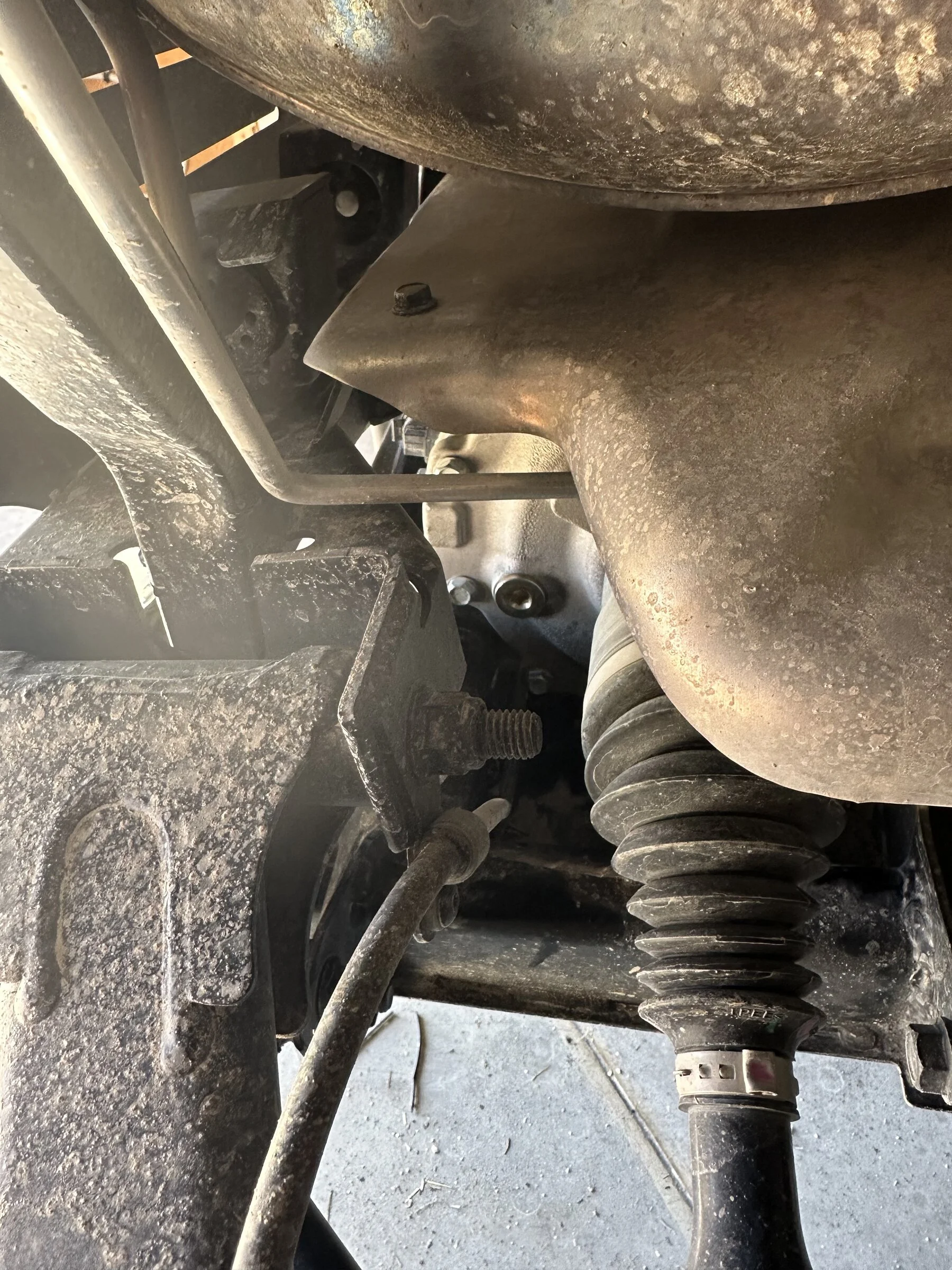

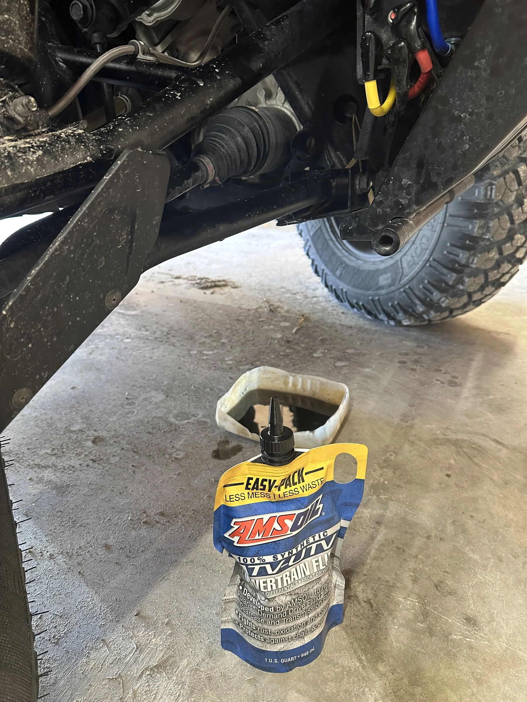

My machine has 780 km on it and 25 hours, so I thought I would do my first oil change on the front and rear differentials. Front differential is easy to access and everything is as you would think. A little bit of a metallic on the magnet, but nothing major. Rear Diff on the other hand is very easy to drain. The fill plug location is very tough to get at. The rear diff had quite a substantial amount of metallic on the magnet, and the oil was very metallic. For the front desk, I used Amsoil powertrain fluid, and for the rear diff I used 75w140 full synthetic gear oil.

My machine has 780 km on it and 25 hours, so I thought I would do my first oil change on the front and rear differentials. Front differential is easy to access and everything is as you would think. A little bit of a metallic on the magnet, but nothing major. Rear Diff on the other hand is very easy to drain. The fill plug location is very tough to get at. The rear diff had quite a substantial amount of metallic on the magnet, and the oil was very metallic. For the front desk, I used Amsoil powertrain fluid, and for the rear diff I used 75w140 full synthetic gear oil. View attachment 660View attachment 661
Did u use polaris oil for the rear diff

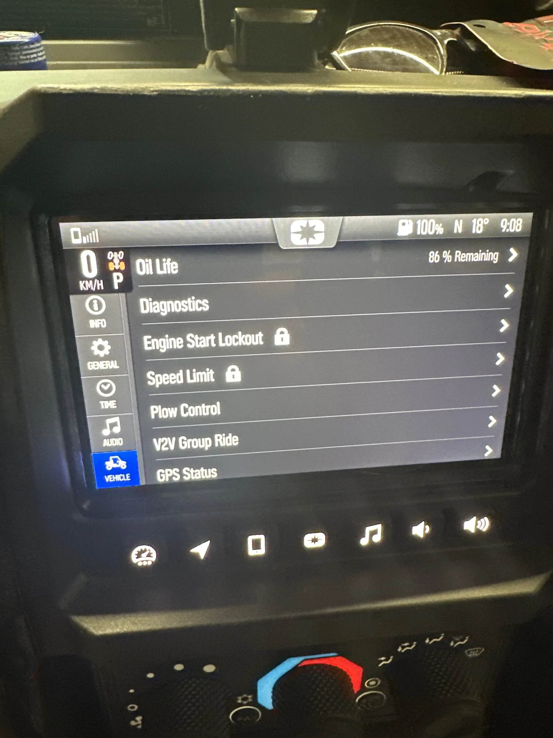

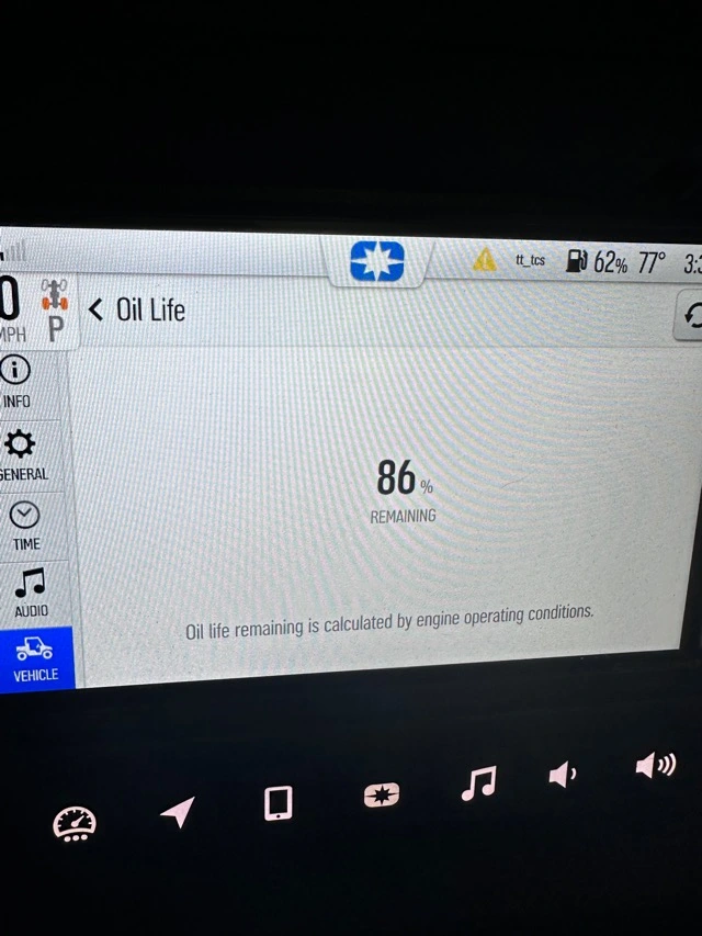

86% oil life how many more hours do I have
Dealer got my new dash cluster in they were going to pick it up next tuesday to replace guess better do oil change first

Thought it be Longer than just 26hrs
I would. It’s super easy though. Oil won’t be that bad.
But it say 86% remaining shouldn’t it be 10-15% remaining that’s was next screen after the alert shrugs

I did my oil change never dropped that clean of oil in my life. Not sure what you guys paid for oil but Canada it’s $25 a quart 4 quarts bugger
