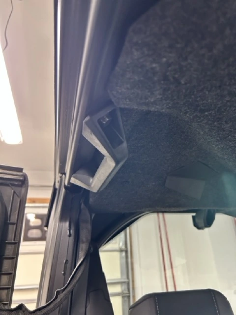

I bought mine from Polaris. The front grab also fits above the passenger door. On my rig the holes were predrilled. I just used the same self tapping bolts from the front handle. If you go to your shop and look at the expanded view of the parts for the cab area it shows the handle being placed there.
HANDLE-GRAB,ROPS, BLK, Part 5465599-070
Item # 5465599-070
2 - Hex Flange Bolt, 8 mm x 1.25 mm x 20 mm, Part 7518555
Item # 7518555

View attachment 2896View attachment 2897
