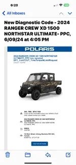

Out for a ride got this fault code come up.
My wrench is always on, I think someone said it had to do with the software flagging an oil change at 25 hours (like the 1000 XP) or so. Not sure if that's why yours is on but I'm thinking that's why mines been on.
My dealer opened a case on Thursday. Never heard anything back from Polaris. Went for another ride it never did it again.
Hmm, I just crossed the 25 hour mark last night. I was expecting the wrench symbol to come on because of the 25 hour break in and it never did. Be curious to see what Polaris has to say.
Happened again on todays ride. Shutting it off and restarting it didn’t work. Shifting gets weard when the light comes on.

No, it changes the shifting when the engine light is on but still works.
Mine has thrown this exact code. When it did, the machine lost all power and would not go over 5mph. Turned it off and back on, light went off and reset itself. Everything was fine at that point. I was thinking it might have been the transmission torque converter acting crazy due to the 37’s.. not sure. Took it on another ride a week later and it would not climb a small hill once the wheels slipped it basically stalled out. Curious to hear what the dealer says to you, I haven’t contacted the dealer about mine.
Just called my dealer. Still no reply from Polaris. Just went for another ride up and down the driveway. Fault is gone and check engine light is off.
