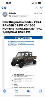

Were you able to perform the update or did the dealer have to do it?So my problem was an ecm update. No other faults found. That fault I got has something to do with a communication error between the cluster and ecm.
Dealer has to.Were you able to perform the update or did the dealer have to do it?
So I'm going to the dealer for service Friday and going to have them download the latest Ride Command software. Do you know if they will all need an ECM update?Dealer has to.
So the update fixed the daytime night time dash lights changing. Went for a good rip tonight. No problems.So I'm going to the dealer for service Friday and going to have them download the latest Ride Command software. Do you know if they will all need an ECM update?
My wrench came on also at 25 hr mark. Changed oil filter and differentials. Wrench never went off when I first start the vehicle but if I start and stop a cpl times then wrench goes awayMy wrench is always on, I think someone said it had to do with the software flagging an oil change at 25 hours (like the 1000 XP) or so. Not sure if that's why yours is on but I'm thinking that's why mines been on.
Yep. Same here. Mine had worked flawlessly since the update was done.My service was done today, and the oil life was reset. The wrench is now gone.
Weard. Mine has been gone since the update.My wrench showed up on my dash again today. WTF?? No notice sent to my Ride Command ap saying what the issue is.
We can’t reset it in the dash cluster by the steering wheel. It is reset in centre cluster. Mine is still off after update.Mine came on at 25 hours. And now every time I turn the machine on, it flashes then stays on. After the ignition is on for a bit, it goes away. I assume it’s because I hit 25 hours. On the old machines you could change the service hours and reset it. I don’t see how to do it on this one.
