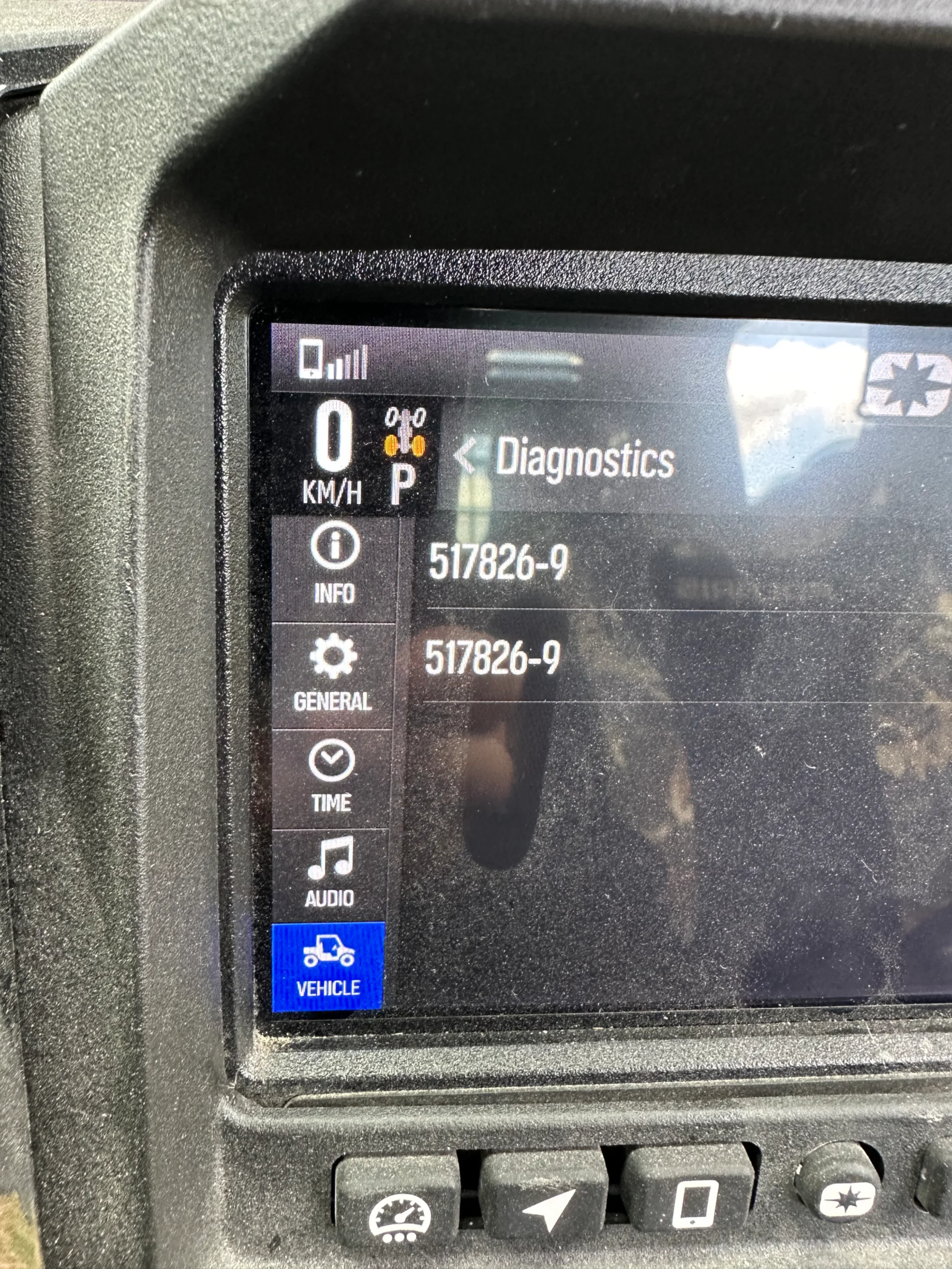

Loading it now taking to dealer,517826 is gone engine running fine other 2 codes remain. Thanks for responding

Got it home and got the amber triangle and code 517826
Mine seems to run OK.
Too cold in Northern Illinois to really drive it too far and test it.
I haven’t seen the fault since the engine was replaced. Actually no codes since then. It could be a wiring harness issue in your case.
Problem with that fault is it was unpredictable with mine. Usually came up when easy cruzing.
Yes but it never made any sense when it would come up on mine.
It happened to me whenever I was in comfort mode doing about 20 to 35 mph or plowing in tow mode. One time we were doing about 45, but either way, all The Times happened in comfort mode on county highways or flat level dirt roads at low to medium speeds.
I could understand it happening if your plowing in Comfort mode, but it makes no sense why it would happen cruising down the highway. I run in Comfort mode 95% of the time (even off-road) and have never got this code.
Been a while but it came up Again. Easy driving. Dry. Cool day. Shut it off, had a couple cold ones and continued on light went out and never came in again
