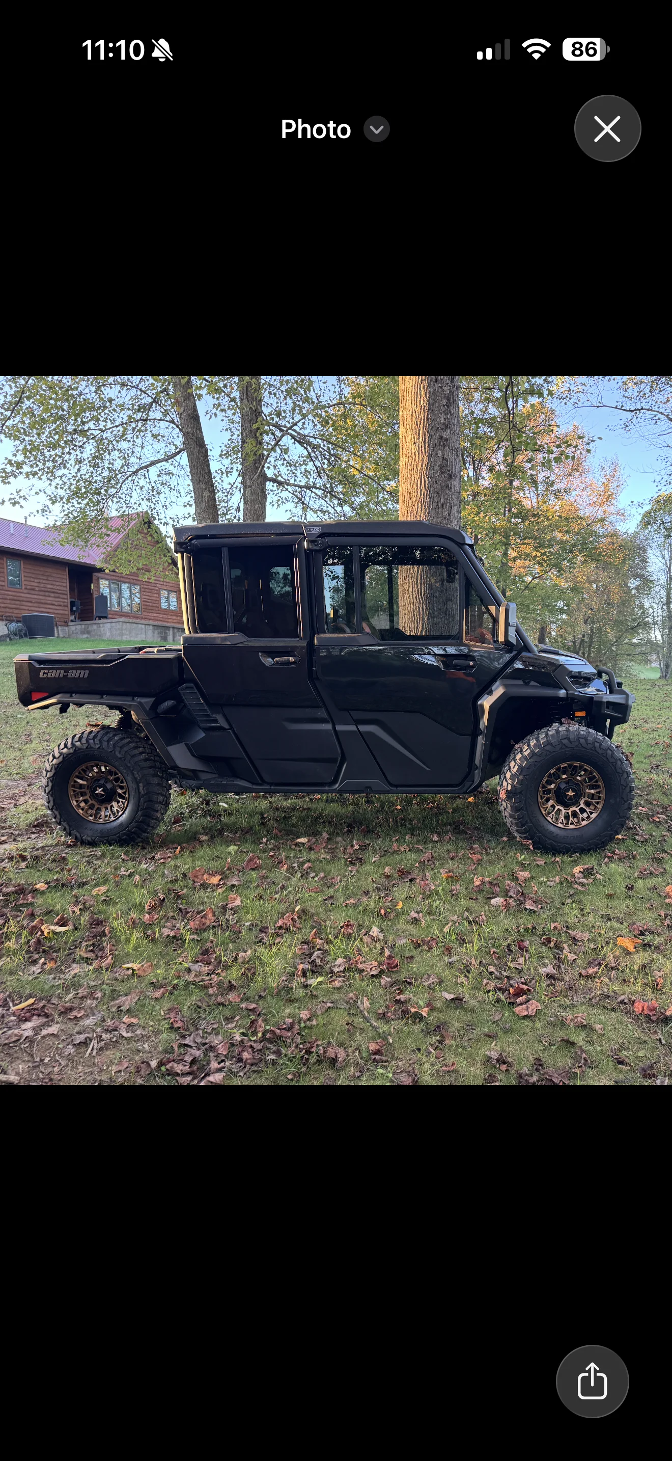

My new 1500 Northstar runs terrible when cold starting. I let it idle for awhile, then try to start going in comfort mode and it pops, backfires shudders and almost stalls. Is this normal? I have many fuel injected machines, including Polaris 4 wheelers that don't have this problem. Or am I being picky? After the engine warms up to operating temperture the problem goes away.
