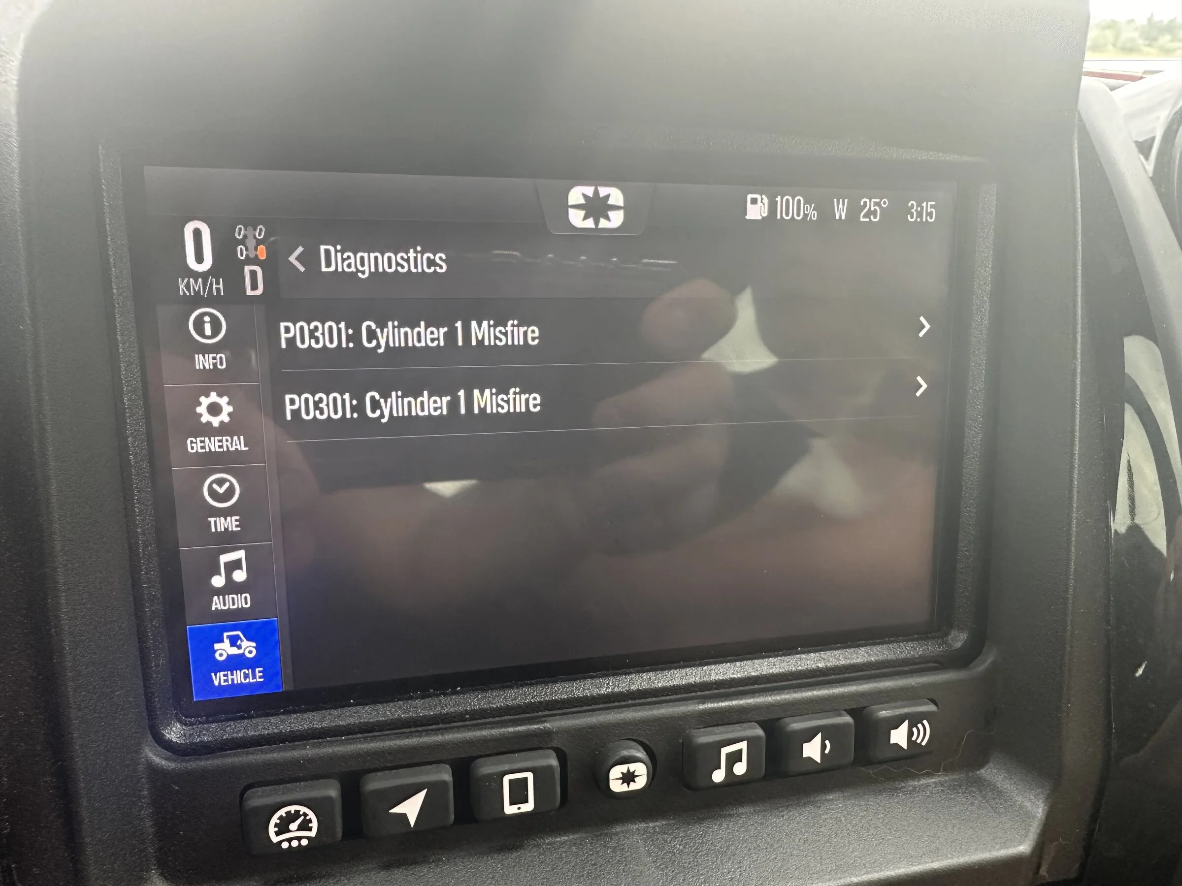

The trip before was perfect. No issues.
Started rough. Popped a few times. Rich smell of fuel. Tons of smoke. Ran good rest of the day.

Don’t know. I’ll call dealer today. Tried it this morning again. Did the same thing.
Dealer figures
Spark plug?
Ignition coil?
Failed injector?
They are on it.

I had the same issue with my XP1000 one time. And I had dam pack rat start chewing on the coil plug wire. Pulled it off enough that it had the same symptoms and code. Raised the bed to take a look and noticed the teeth marks. Pulled all the way off, pushed all the way back on and issue was taken care of.
I’ll pick it up today. They wanted to try start it in the morning one more time. They are throwing parts at it. The diagnostic tools my dealer has don’t work with the 3 cylinder. They opened a case with Polaris so hopefully something they changed has fixed it. Will know more later this morning.
No solution. I have it for the weekend but they want it back Monday morning. I think Polaris doesn’t deal with the cases very fast. Or there are lots of cases open o don’t know

Once it’s running it’s ok. The first 10 seconds after start up it makes a poping in the exhaust and runs rough, lots of smoke. But after a minute it clears up and works fine.

I'm sure they changed the easiest of all parts,(spark plugs) but the symptoms of no fire until it warms a bit certainly sound like a fouled plug on yesteryear engines.

Years back when leaking valve seals were an occasional issue the symptoms were similar, it would be interesting the next time it does it to immediately shut it down and check that plug for oil residue.
