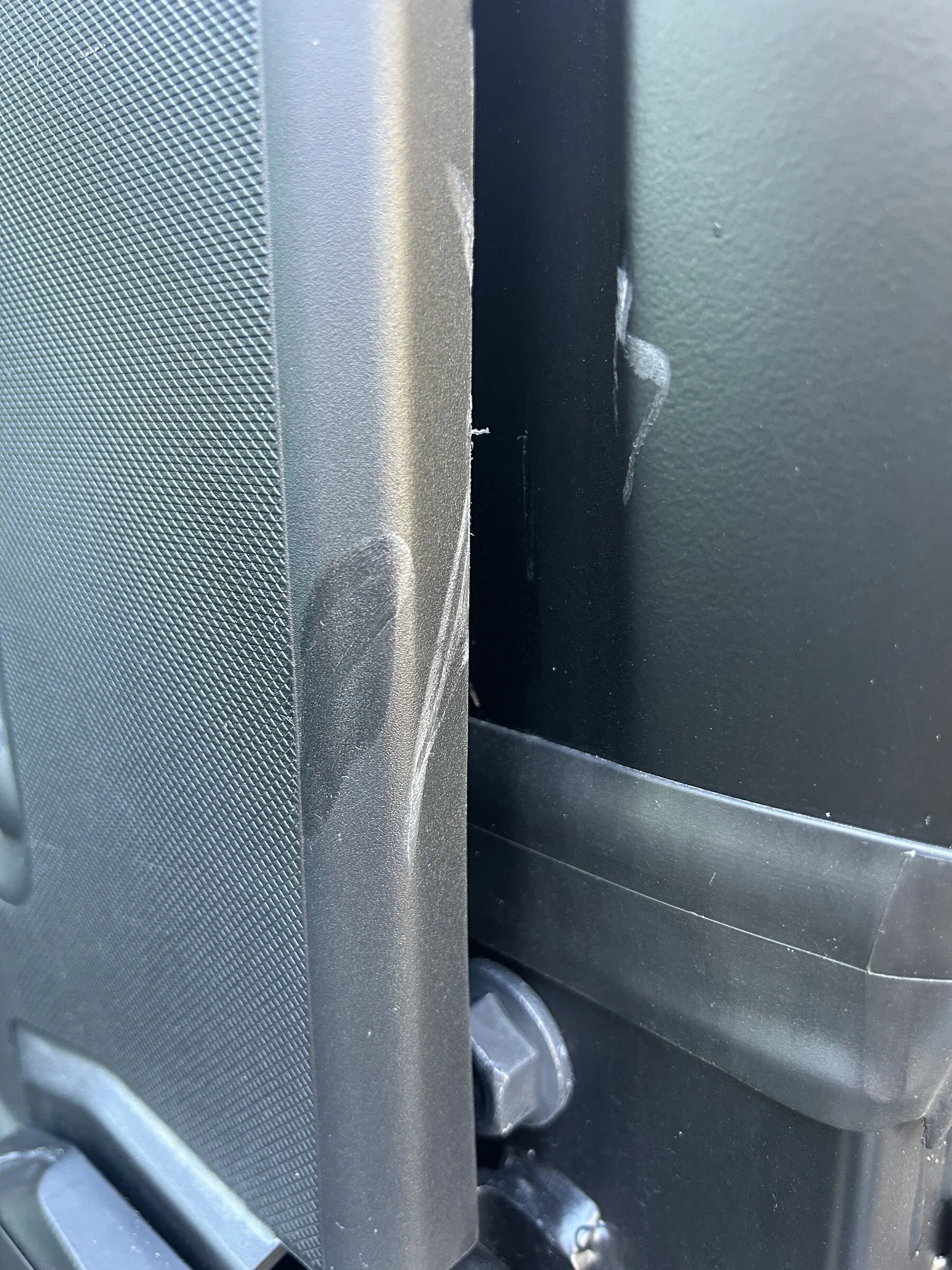

Had it happen today on driver door at 45 mph.
Door had been closed securely prior to and came wide open and folded back on its own!
No damage to the door that I can find.
I believe the mirror actually helped by not allowing it to fold back completely back.
I'm really surprised that there was no damage after flying open at 45 MPH. It's been a while, but a member here had the aluminum lugs break off the door hinge when the wind caught the door and blew it open when parked.
Haven't inspected the lugs closely for damage yet.
Door seems to close properly, and nothing seems to be out of line.
Mirror was scuffed on the outside corner from contact with the back door.
Handle is not returning to flush position though.
Seems in line with the email from polaris

The first photo is where the mirror hit behind the rear door. Looks like some damage to the hinges but they seem to still be secure.
The hinge stop broke off, that's what happened to a member here when the wind caught her door. Your rig looks a little messed up, I'm glad no one got hurt. Thanks for sharing the info from Polaris, your incident is the first time I ever heard of a door flying open. If I was you, I would be super PISSED OFF and raising hell with Polaris.
Ill be calling polaris and the dealer Monday. I reviewed all the links on the email and it states they should have a remedy this month.
For now they recommend continuously checking the door handle to make sure its flush.
Hopefully they will fix what's damaged.
