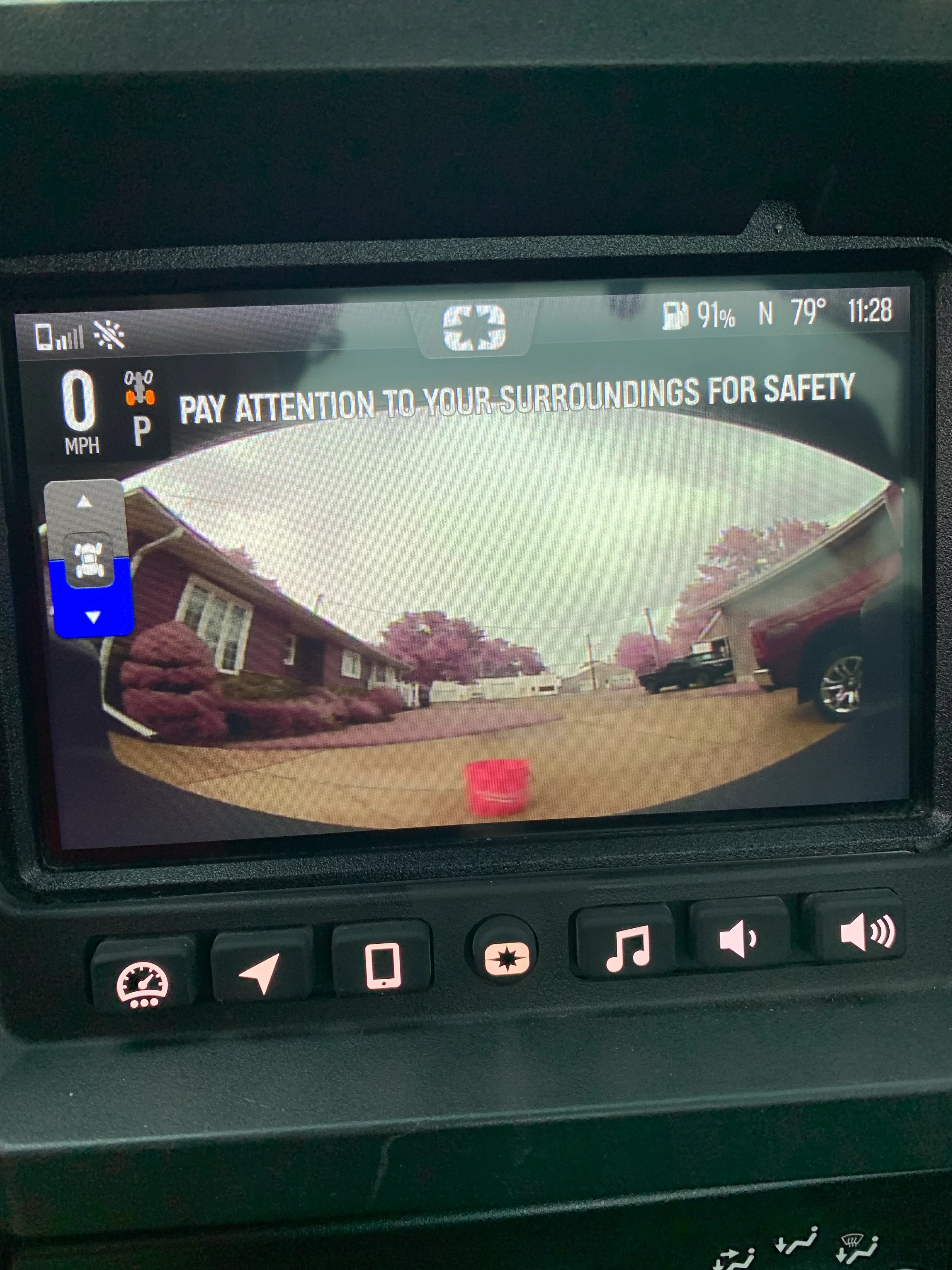

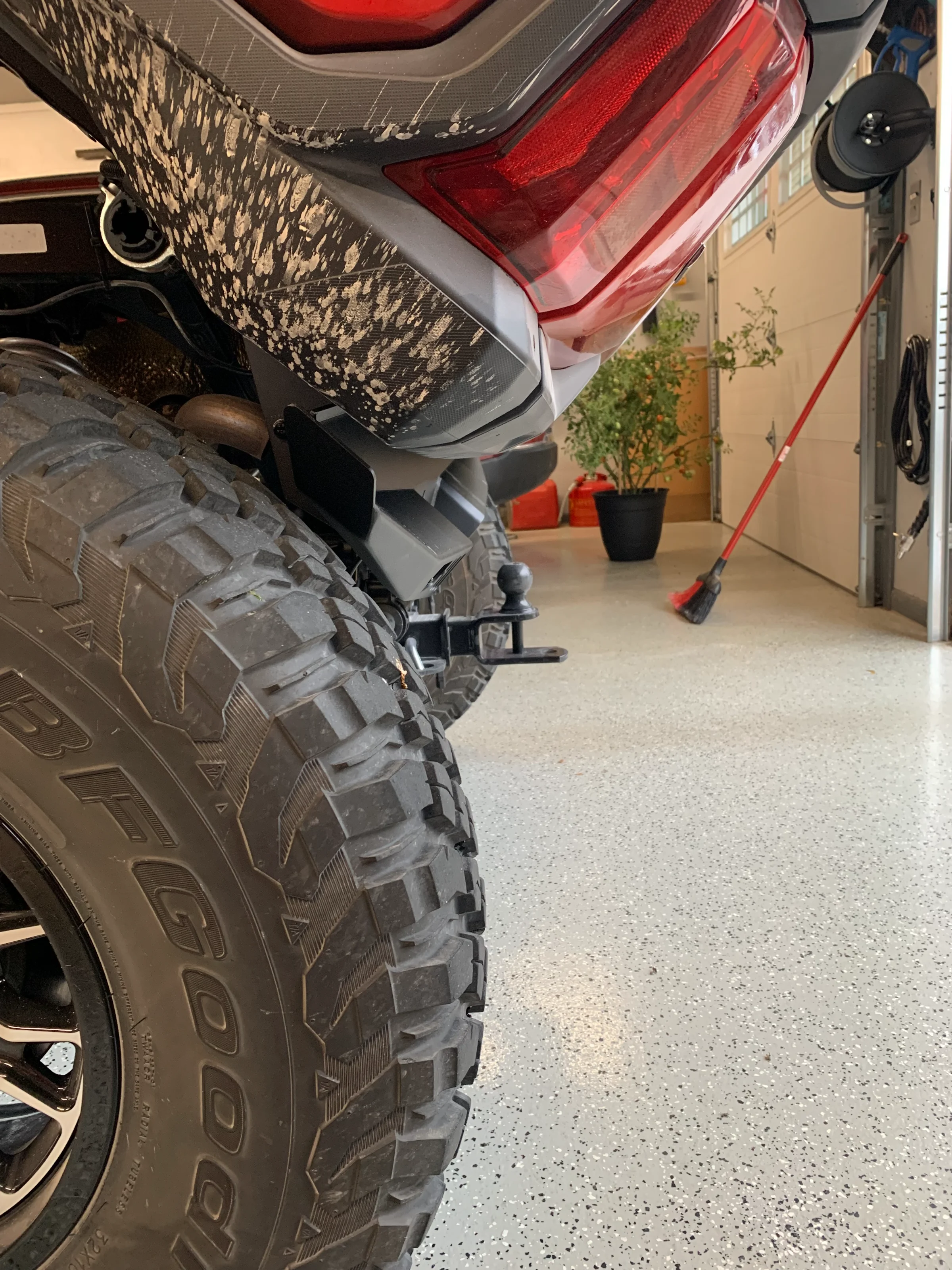

I'm sure I'm going to loose the ability to see the ball on my hitch because the bumper pushes the camera out further and tilts it up a bit. That said I think I will still be able to see the ground behind me which is the most important thing for me. I will post some pics when I get it installed hopefully next weekend.
I can’t see my ball very well either with having the winch on my rear bumper. But it gets me close enough for the trailers I hook up to it with. I’ve thought about getting an extension anyways, so the ball is a little further out for easier connecting. And if I’m not careful, the fairlead will get caught on the ball if I tilt the bed down to far and it’s a real pain in the ass to undo.

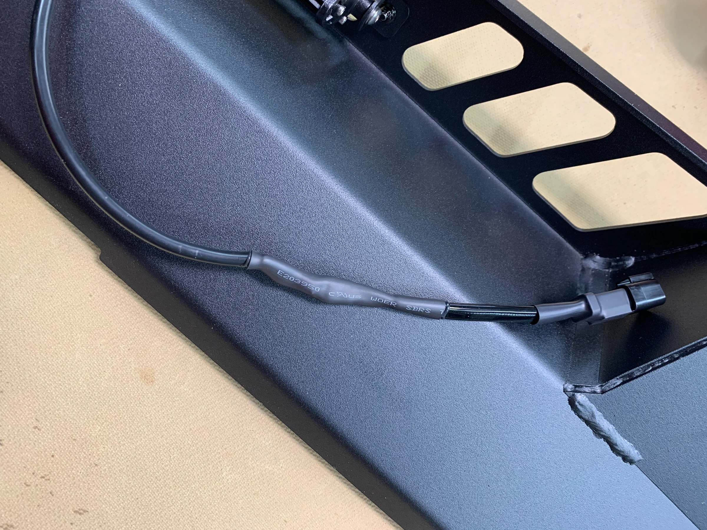

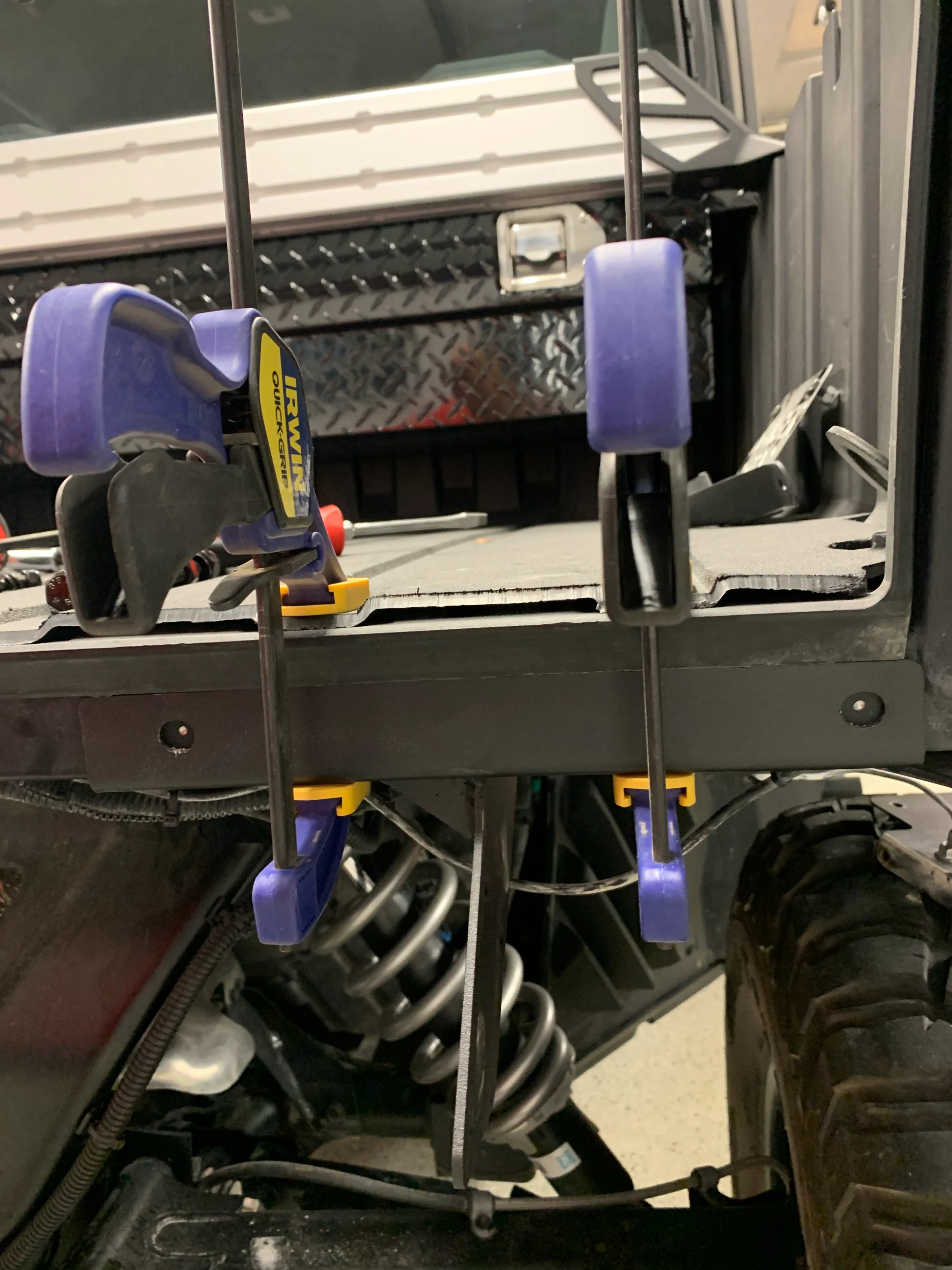

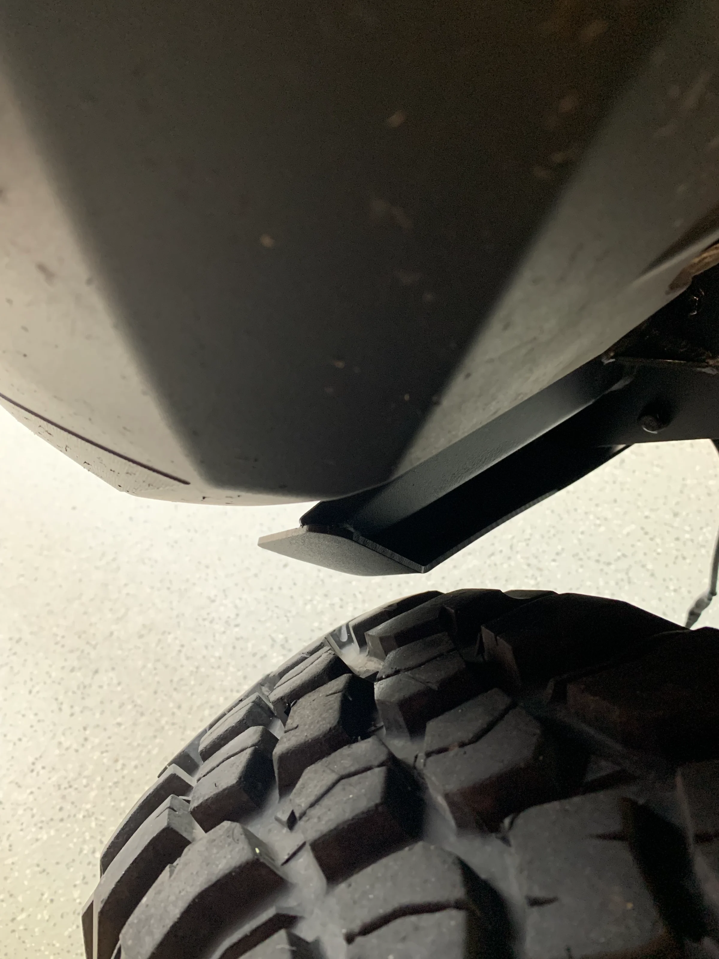

Just finished installing the DRT rear bumper. The lights come preinstalled you just need to add leads to them. Mounting the brackets are fairly easy but getting a wrench on the bolt under the bed SUCKS. By far the hardest part of the install. I found it much easier to just clamp the brackets on the bed then measure the distance apart from each other which needs to be just shy of 42 1/2" (use bumper for your measurement) The outside of the brackets almost line up with the edge of the bed (see bracket pic) I also found it much easier to use a center punch and pilot drill for marking out the center of the holes. I left the bracket clamped while I drilled all the holes. Install bolts but don't fully tighten, test fit the bumper and the brackets will self align, then snug the bracket bolts to the bed. I then removed the bumper and fully tightened all the bracket bolts. You need to reinstall the tailgate before you bolt the bumper back on or it will be very difficult to put the retaining bolt back on the left side of the tailgate. Set the bumper back on and tighten the 6 bolts and your done. I have 32" BFG KM3's and the bumper clears them no problem. The camera is tilted up a bit but you can see the ground starting about 54" from the back of the bumper (see bucket in picture) The bumper does not hit the ball when fully tilted, you can see what the camera looks like with the bed fully tilted.
All in all a fairly easy install, the lights may be the hardest part. Anyone have a suggestion on what the easiest route is to run the wires from the back to under the hood? I haven't started that process yet as I'm waiting on a wiring harness which should arrive today.

Bumper looks good. The camera angle still looks functional. Sorry I can’t help you with the wiring. My only thought is what about through the tunnel?
