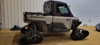

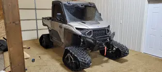

I went with Rubitracks for my 1500. They are pretty big tracks compared to the camos and the defender tracks.
So far I’m very happy with the floatation. I’ve climbed up snowy rocks to get to our cabin where my Gator on WSS4’s would get stuck.
