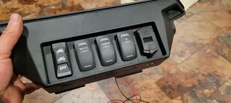

I've got the switch panel ready

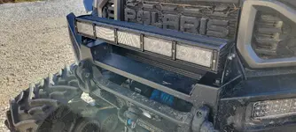

Pics of an an Extreme LED
The back light was a Polaris freebie from 15ish years ago but was manufactured by Rigid.
Like it was made for it.

Here are the switches. I wired the bar to dim when the low beams are on.

It's a little different light pattern. Jack of all trades but master of none. Each little cube of two bulbs is a sealed unit with two different color leds. They are removable and replacable which is nice. The relays/controler is in the light so you just wire it to your switches. To get all the functions out of it you really need 5 switches. I just did three and wired the dim function to my headlight switch.
In white light mode the two outside pods are spot beams and the center is a flood. In IR mode there is one spot and one flood. In amber they all light but it's an asymmetrical mix of spot and flood.
So each pod has amber leds and either white or IR.
I really like it but if I wanted an all out bright white light I'd go baja designs. I've had there lights and they are impressive. I got it for the IR but now I'm really liking the amber. I never even looked into amber lights but now i love them. For what i do they are prefect. If i didn't want the IR, the white and amber version would be the way to go. Maybe down the road I'll swap out the IR/amber pods for white/amber pods.
That’s really cool that they’re all interchangeable. I’ve never seen lights that have that ability before.
There are bolts on the front holding them in and they are wired in with waterproof plugs. You can order the pods and do it yourself. Since they are sealed glass you should never get condensation in them.
It's a cool design for sure.... and i don't work for them or anything, i just bought them. Funny i feel the need to say that but these days everybodys got an angle.
