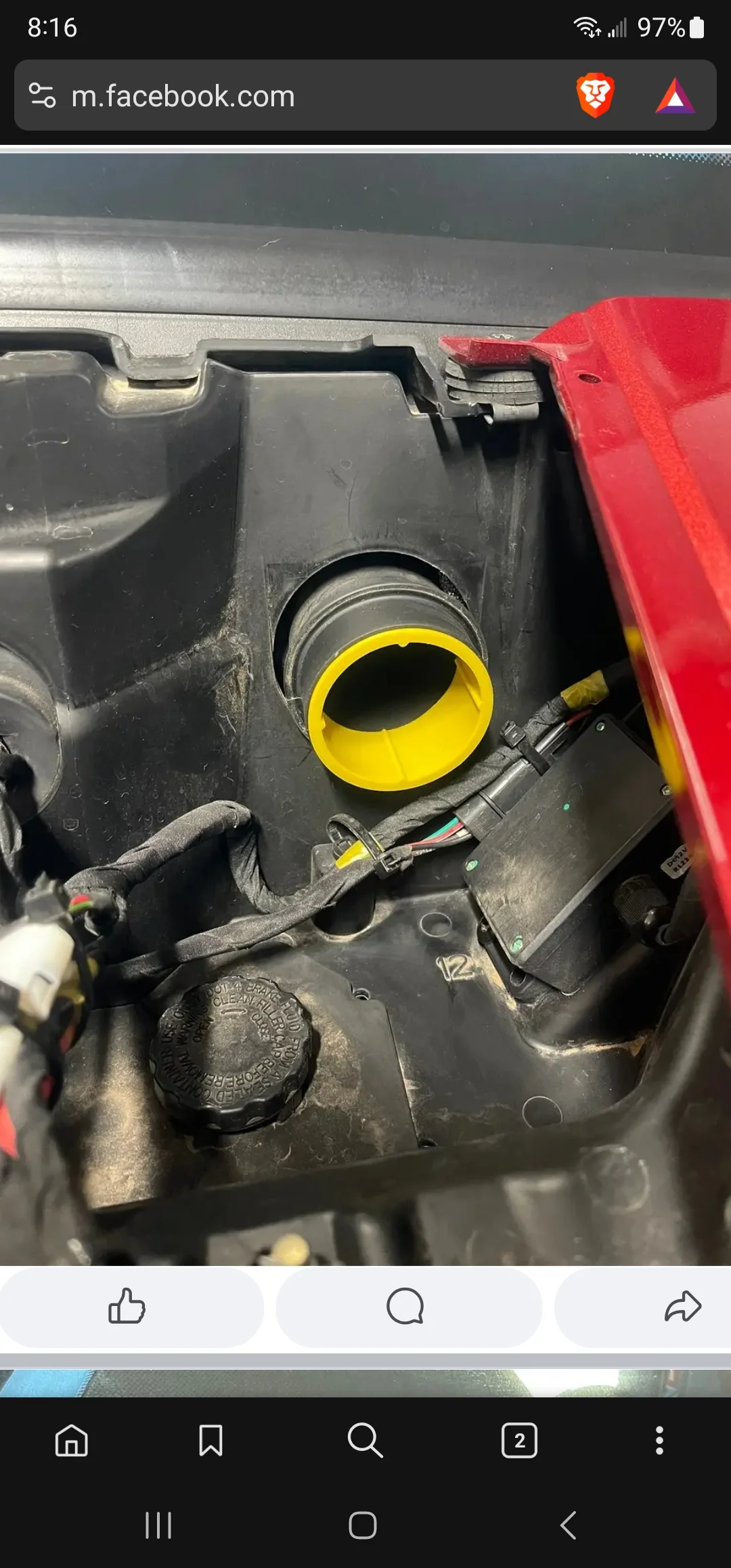

If you remove the cabin air filter under the hood, you will see the opening around the tube. I used black RTV Silicone to seal it up. That helped a lot.
