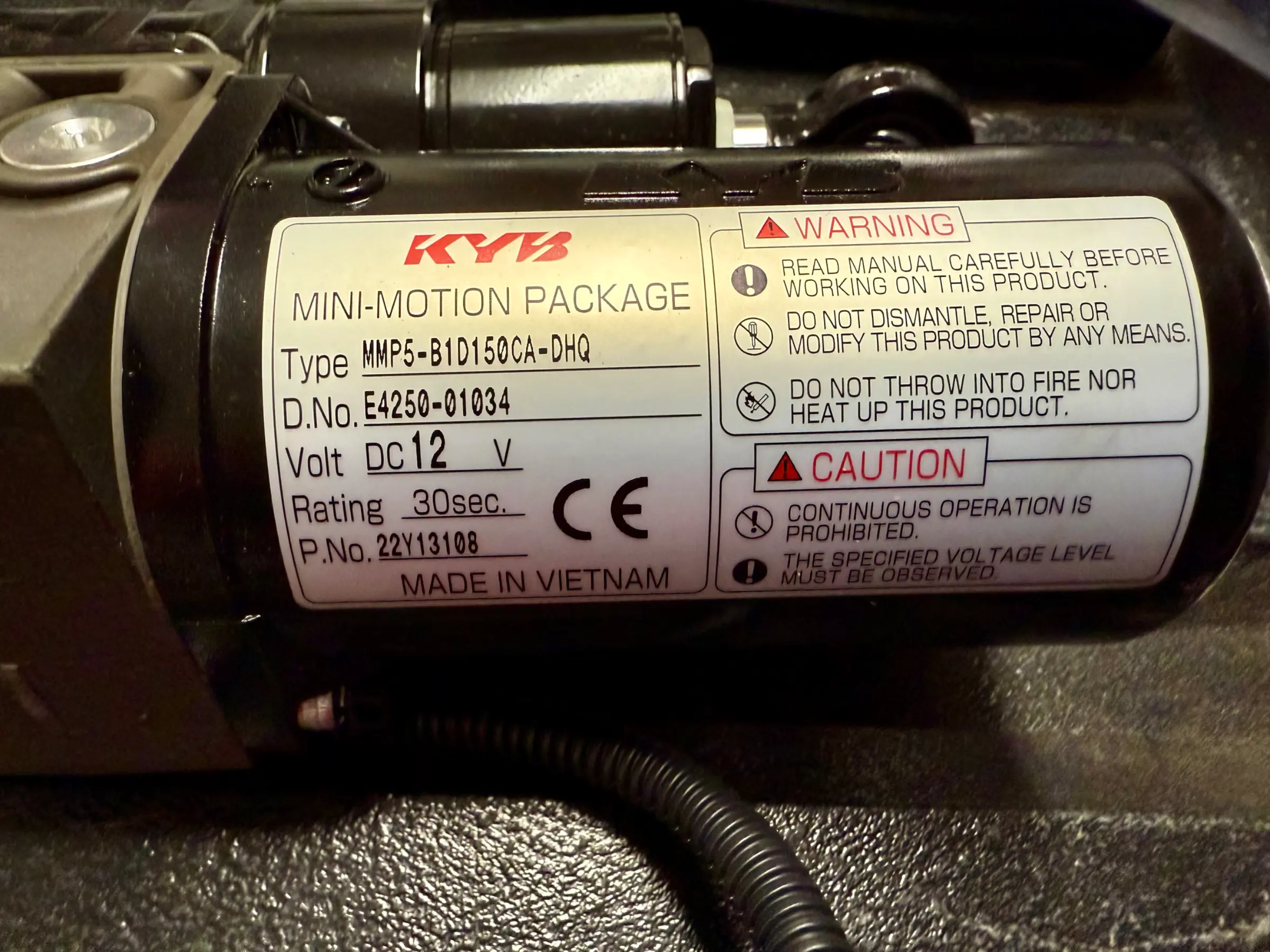

That’s great news, if you could post up some pics of the part/model once you’ve got that’d be great. Just want to verify with my dealer when I go to get mine.

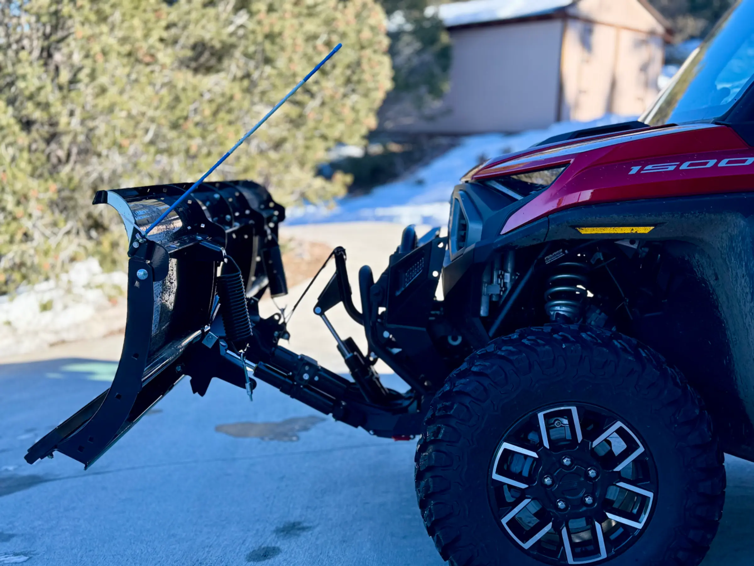

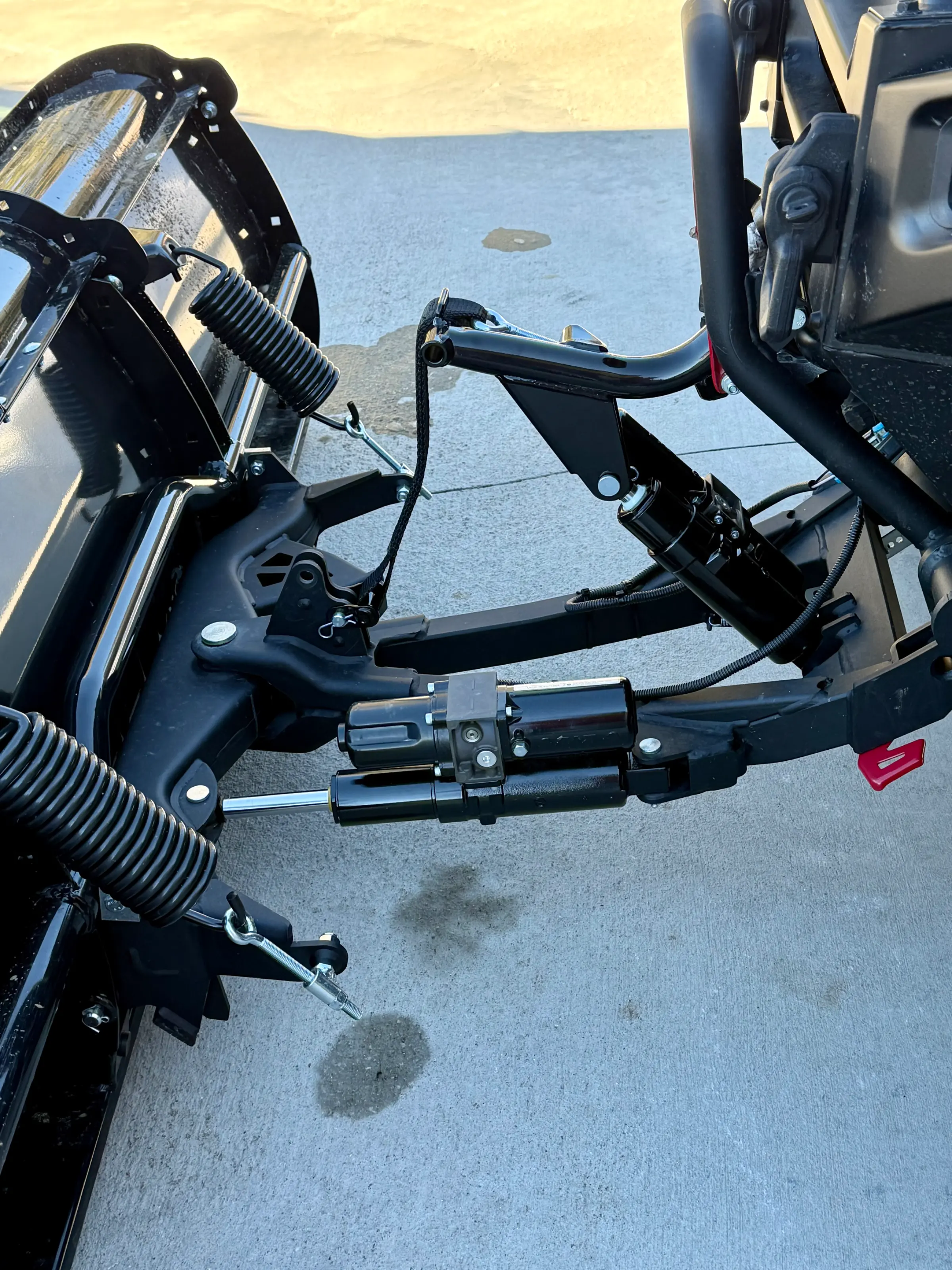

I picked up the new hydraulic plow lift kit today and got it installed. Attached are 3 photos. One shows the label on the hydraulic unit. Second shows the plow down on a slope that’s 12 degrees from horizontal and there’s still slack in the strap. The third photo is with the plow raised all the way. This is how I have it adjusted as I need the plow to be lower when I transition from horizontal to down slope. It raises and lowers just fine, but a little slow.
Glad you finally got the right parts, let us know how it performs when you get your next snow.
I picked up the new hydraulic plow lift kit today and got it installed. Attached are 3 photos. One shows the label on the hydraulic unit. Second shows the plow down on a slope that’s 12 degrees from horizontal and there’s still slack in the strap. The third photo is with the plow raised all the way. This is how I have it adjusted as I need the plow to be lower when I transition from horizontal to down slope. It raises and lowers just fine, but a little slow. View attachment 2171View attachment 2173View attachment 2172

Just installed my hydraulic lift for the 84" plow. Slow as hell and doesn't want to raise as high as yours. My part number appears to be the older lift. I cannot for the life of me seem to find the part number listed on your pump. How can we be sure if ordering the lift from Polaris (or any dealer) that is going to be the beefier unit? Feel like I'm stuck with this one now.... Thank you.
