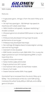

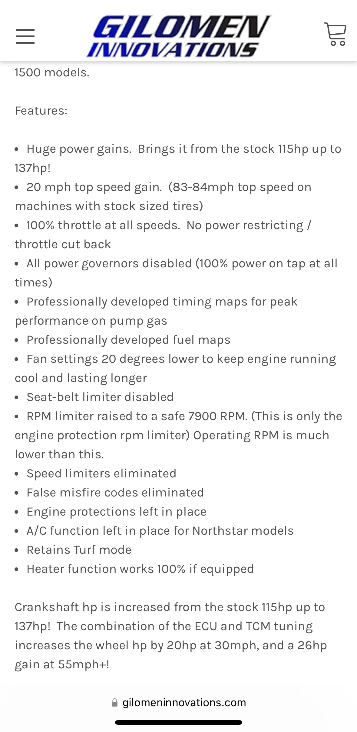

For anyone that might be interested, the Gilomen ECU/TCM tune can eliminate the speed limiter on tow/haul… along with a bunch of other fixes. It feels like an entirely different machine after the tune.

The original reason for doing the tunes was that we had issues where if you tried starting out on a very steep hill it would just lug for a few seconds and then pop a trans temp code. It was really bad in reverse. We had the dealer reflash the TCM a couple times and it helped a little, but didn’t fix it. As far as im aware, the Gilomen tunes fixed that issue, but it also really woke the machine up. I have no doubts on their claims of 137 hp, since this thing is incredibly snappy now.
We also use it frequently for pulling our Camp trailers, so the speed limiter on Tow/Haul was pretty annoying. We’ve got at least 500 miles since doing the tunes, with no issues.
