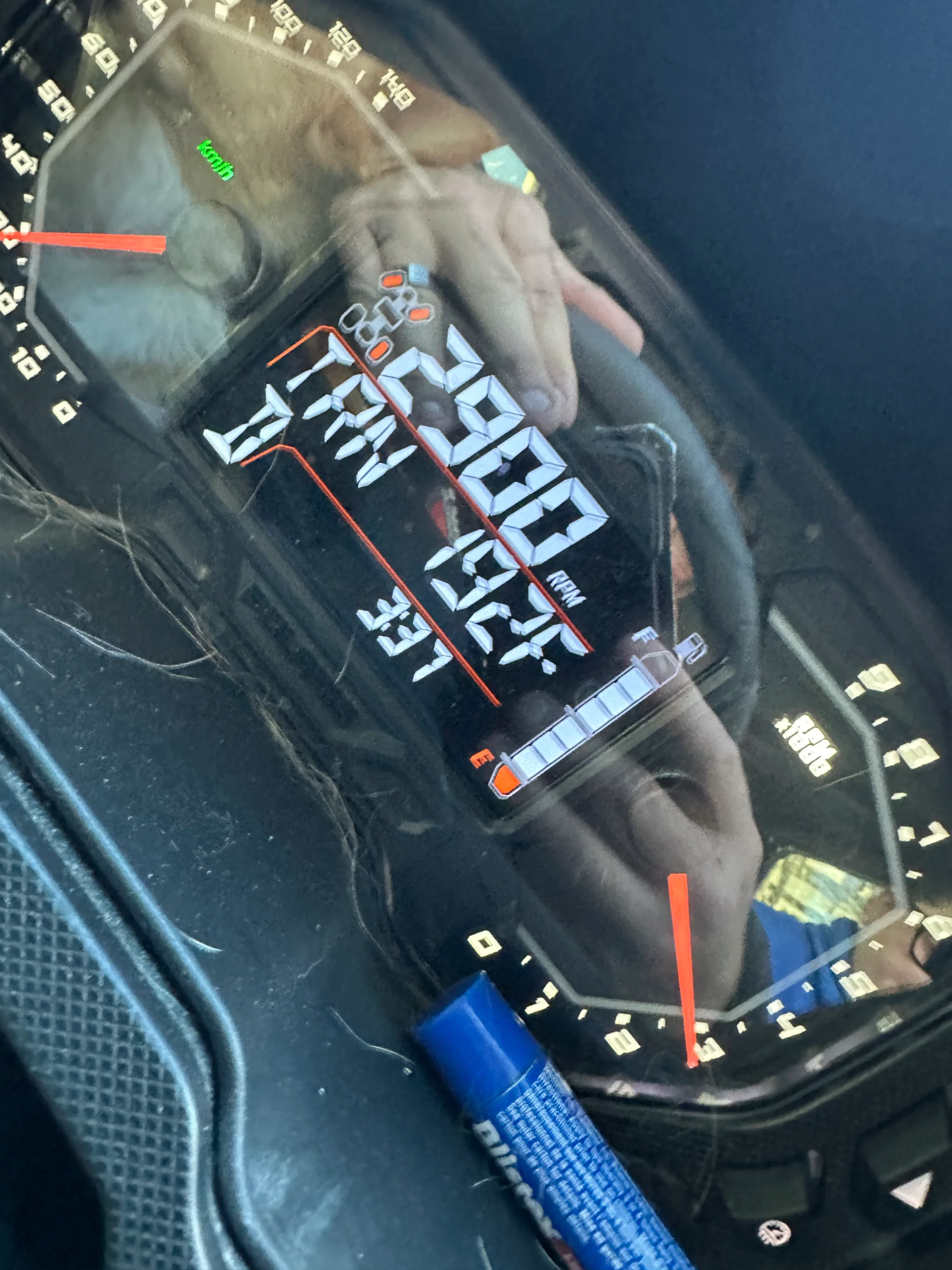

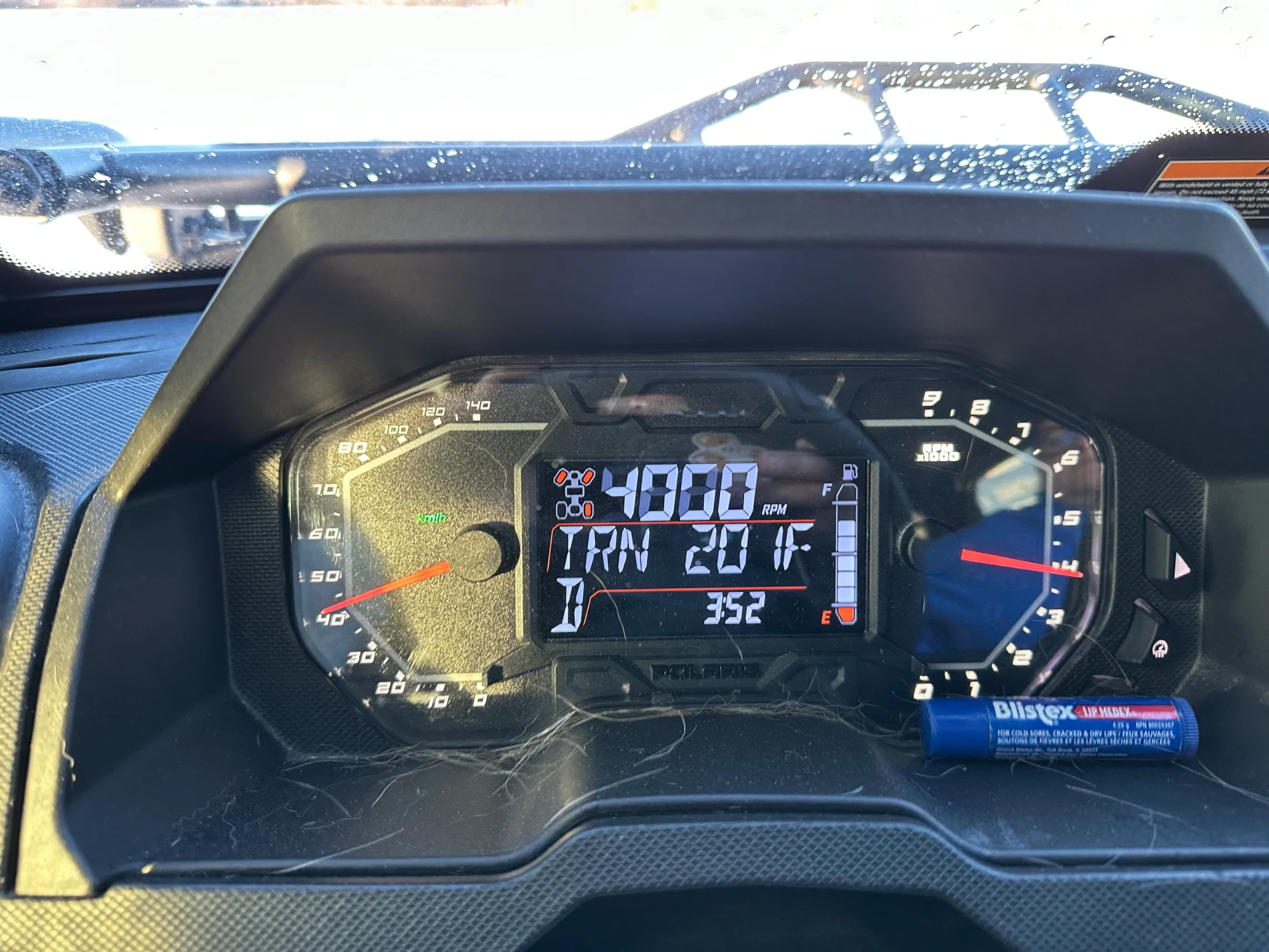

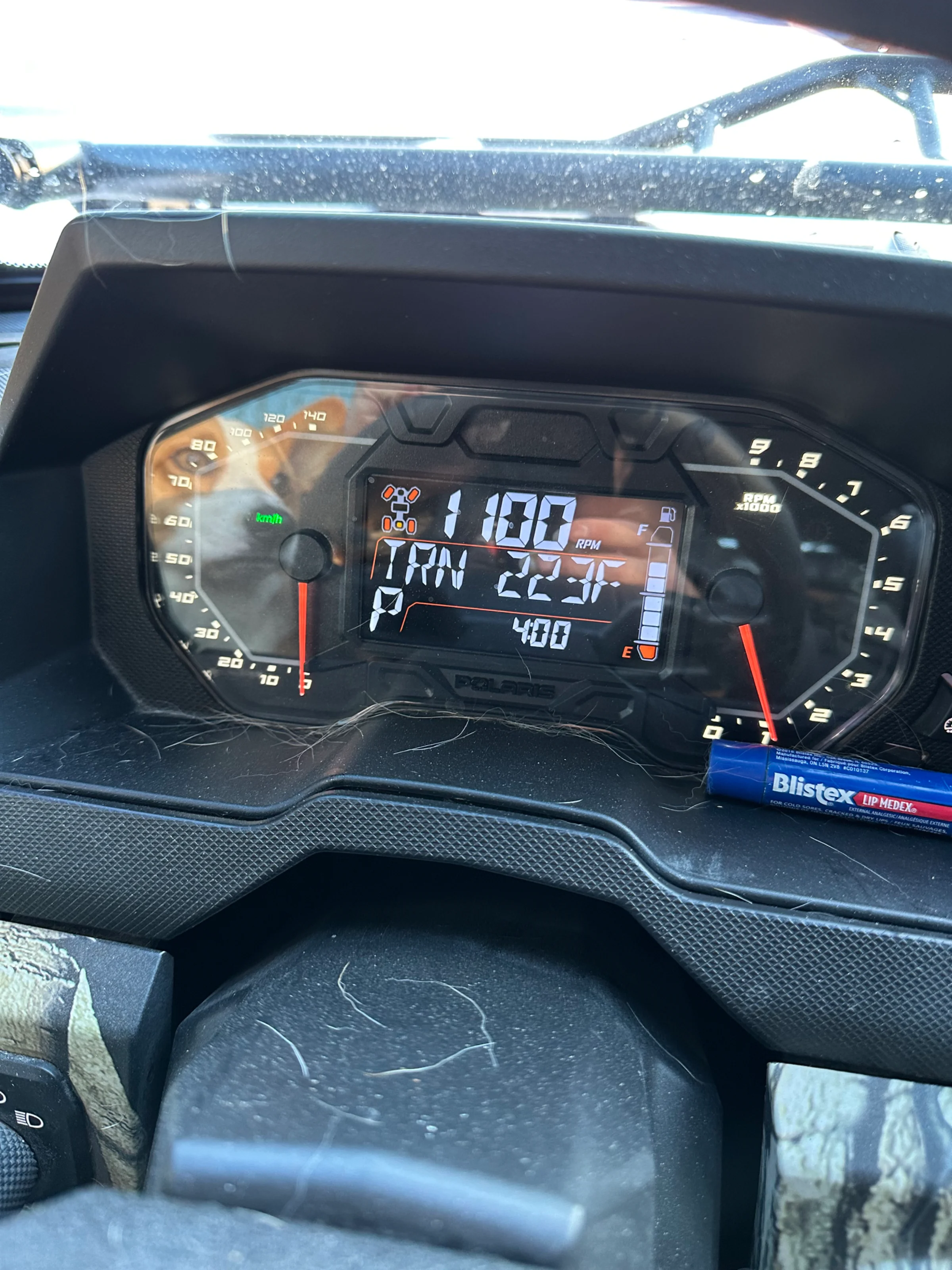

Road running and lack of air across the rad? I don’t know. That time it was a cold day, Just put the tracks on and was at 4500-5000.
I’ve never done that to it again. What I know is take it easy. Leave it in tow/haul. Now I never see temps above 90f.
