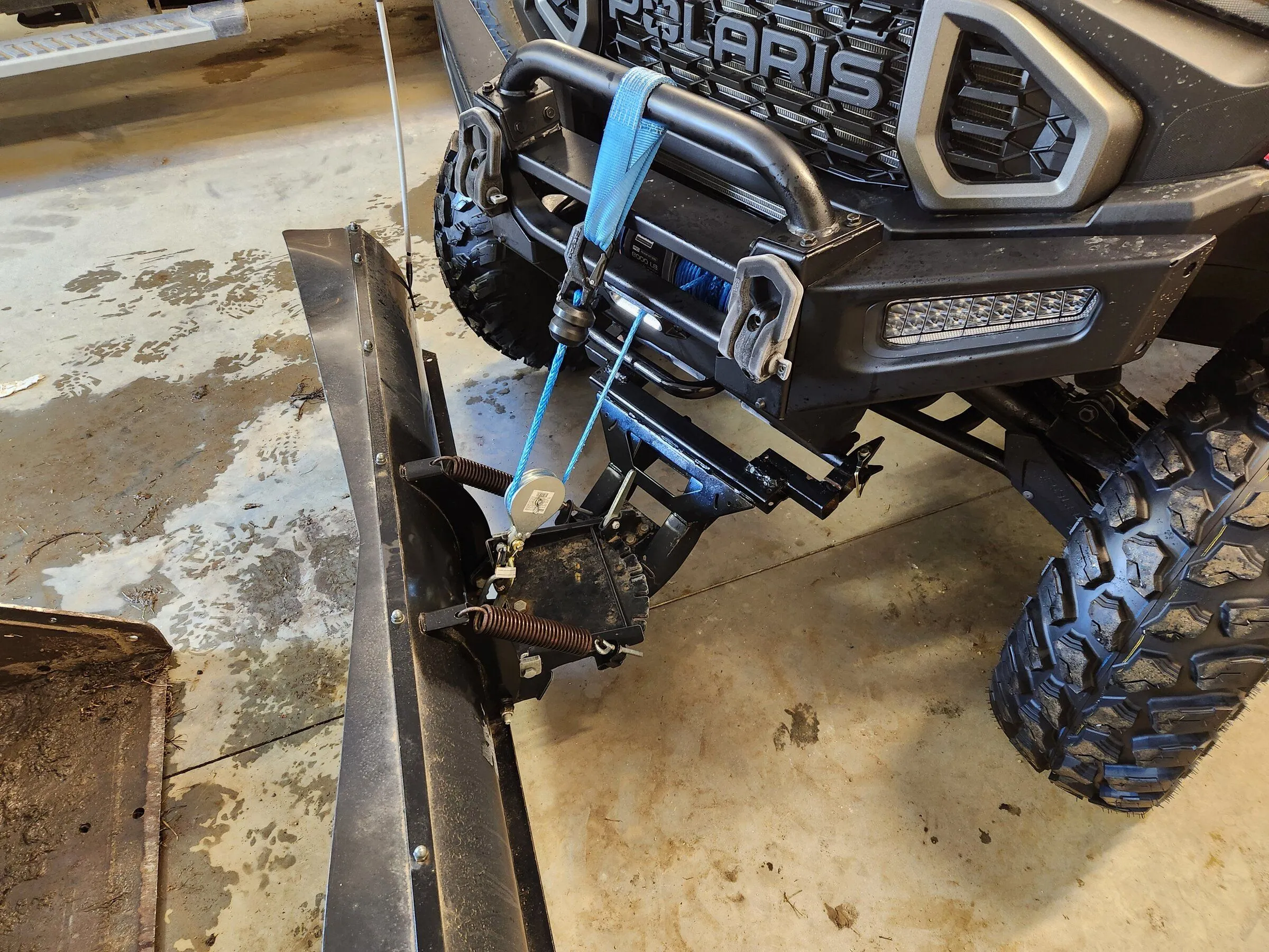

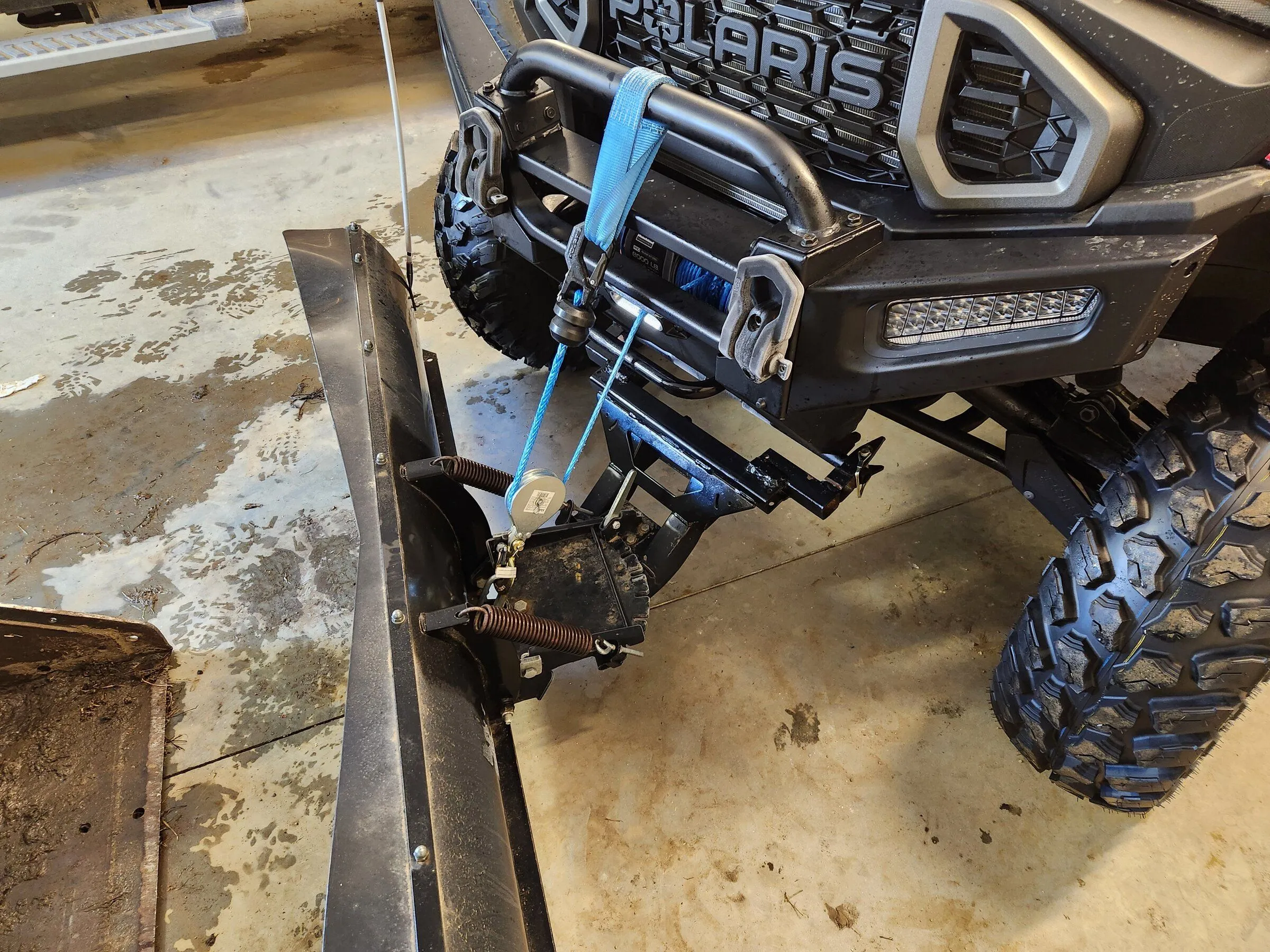

This isn't a new idea but I thought I would share. The only thing I didn't like about plowing snow with the 1500 (besides the fact that I had to do it at all) was that the winch moved in and out so fast that it was hard to find just the right height for the plow. This cuts the speed in half making it much easier to control depth. The cross bar on the bumper looks pretty sturdy but I will be keeping an eye on it so it doesn't get screwed up.
Good ideal! I have seen several similar set-ups. I would think the top bar should handle the load.... it's fairly beefy and Polaris made sure to use enough bolts.
Make sure your winch is on the L setting not H on the knob where you turn it to free spool. I thought the same thing and then found out it has 2 speeds
