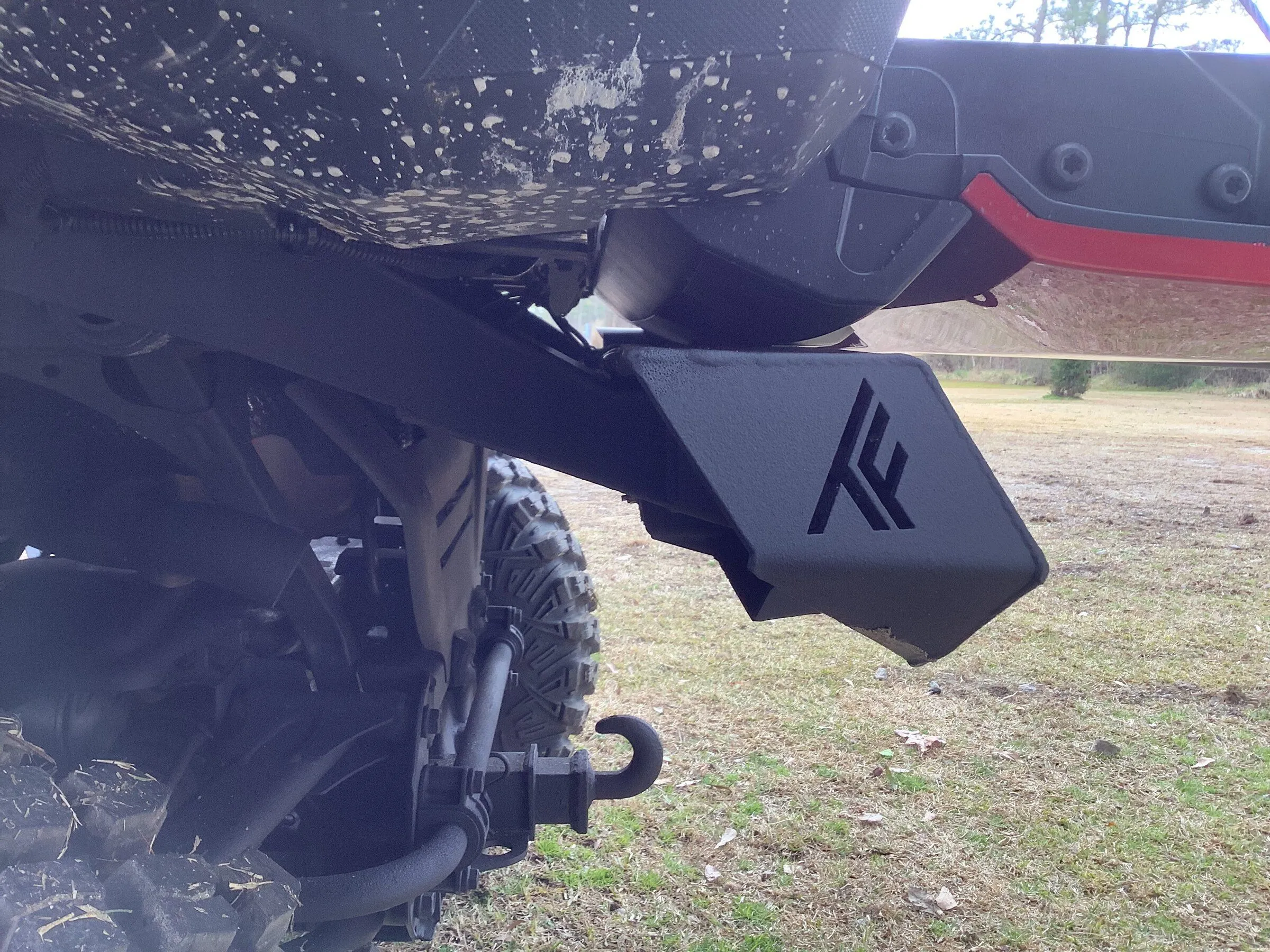

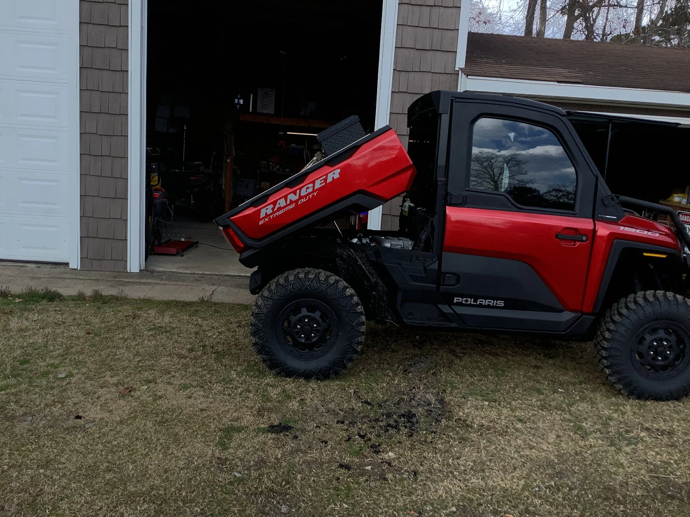

And no, I don’t have the Polaris bumper option. You definitely won’t need it with the thumper fab since it extends well past any protection, the Polaris bumper would provide. this rig has 32 inch tires. Took picture of tire to bumper clearance at full tilt. Not much room if you put any larger tires. Still don’t have thumper fab spacers, so don’t know how far they will restrict bed tilt, if at all.
I’m keeping the 30” tires on mine so it’ll fit in my enclosed trailer. Usually when I haul alfalfa it’s 4 bales and the tailgate is down is my concern. It’s a sharp looking bumper and rig for sure.
I meant to put this picture in with the last set. It shows the tailgate making contact with the bumper. I have not had a chance to see how to get the bumper lower to increase clearance yet. Other than that, I didn’t want to give anyone, the idea this was a cheap bumper. It’s very good quality. It’s just mighty tight on clearances. Perhaps it’s too close due to improper installation but it was pretty straightforward. Let me see if I can get sufficient clearance before anybody cancels their order or changes their mind.
