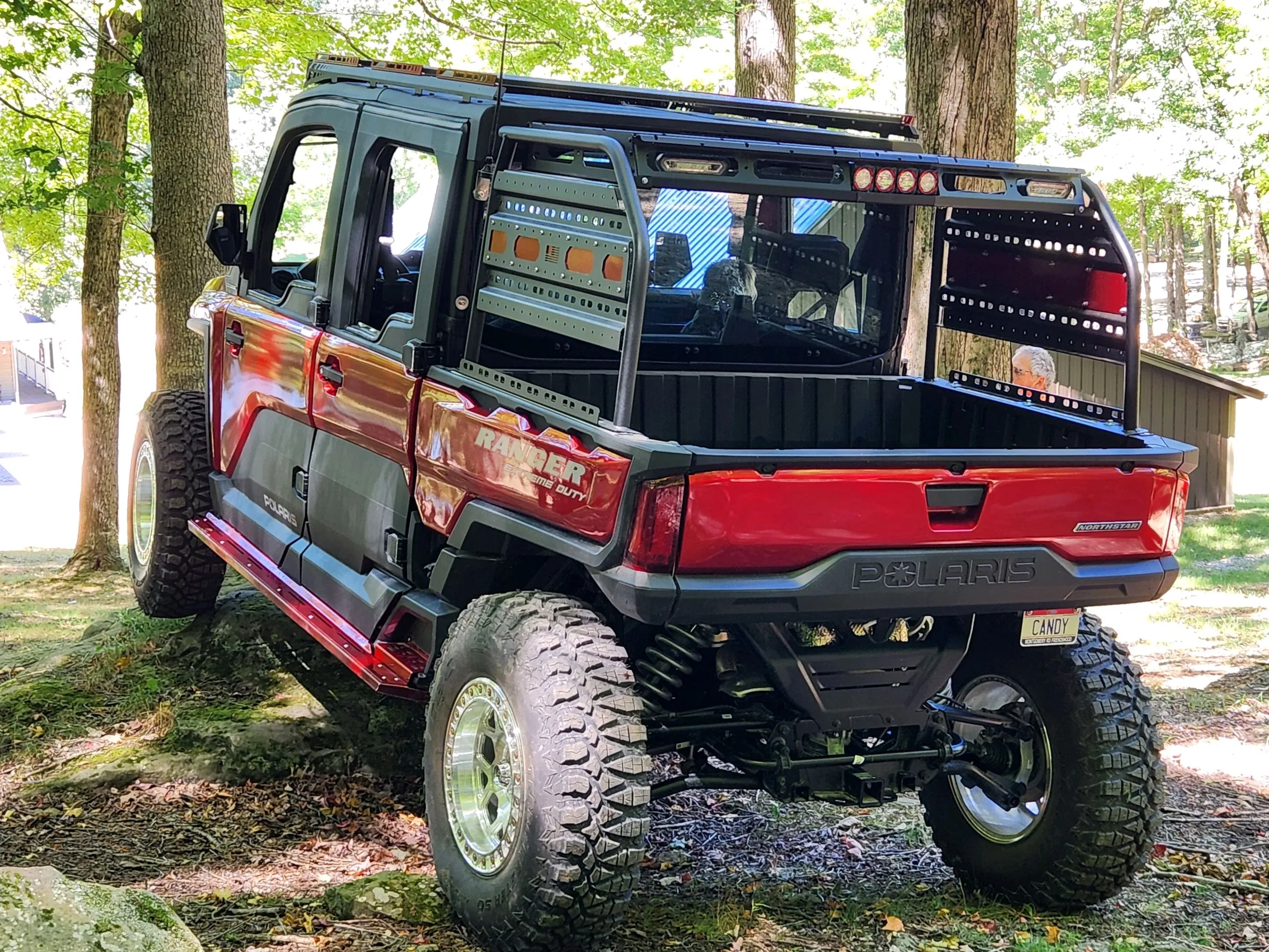

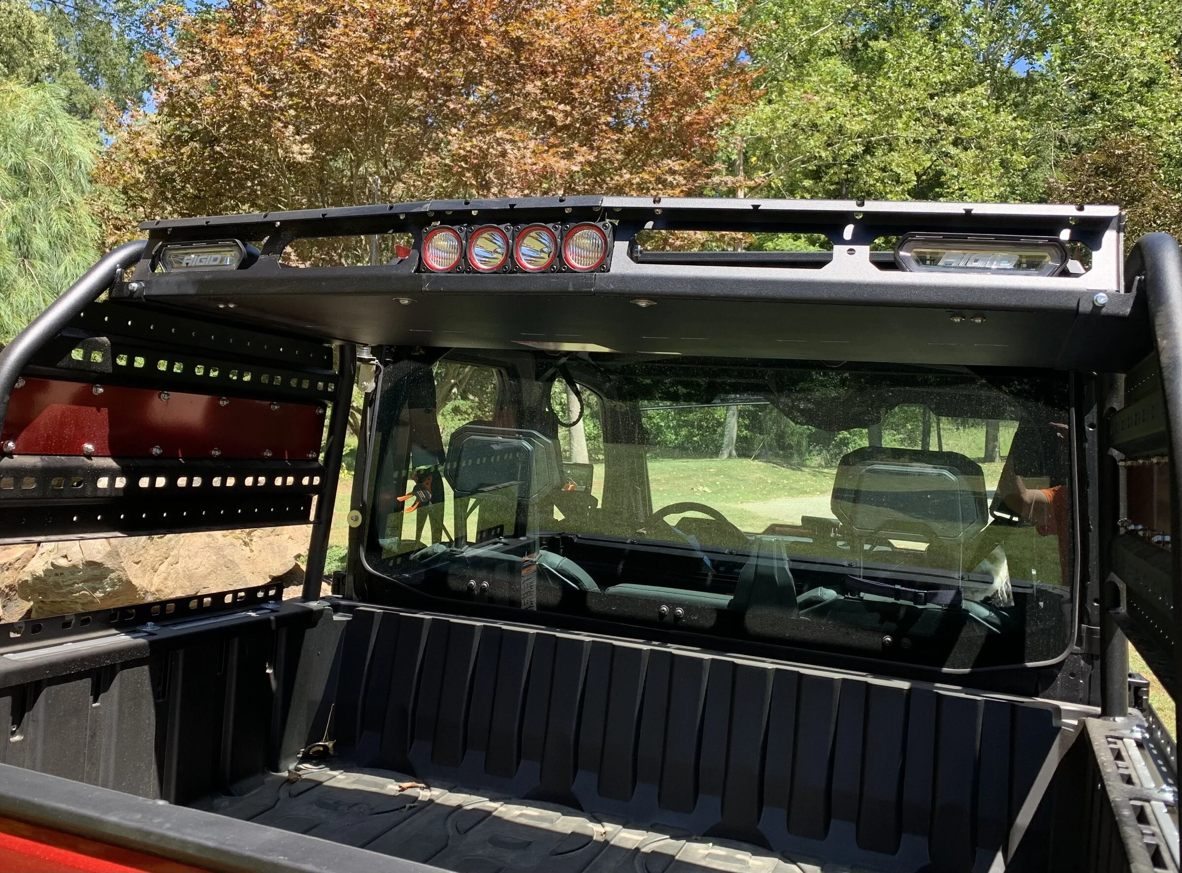

I hooked the Rigid lights (ones on the outside) up to same circuit on the shifter . They quadruple the amount of reverse light, also act as third brake light. The KC in the middle is on a switch.
Would you mind telling us about this wheel and tire package. Beautiful set up and rig!!!
Thank you.
The wheels are 17" KMC Mesa slotted. I did not need or desire a forged wheel but they were out of Grenade Crawl and cut me a good deal. Wheel Pros has a young man named Colin that knows UTV's.
The tires are GBC Terra Master SQ 35x10R 17, 10 ply rating
I am old school and still prefer the aluminum deep dish look but wanted to try some 17's this round.
There is very little choice in 17" utv tires without going even bigger than 35's. Endless choices in DOT rated.
I found out the hard way not all 35's will clear. There have been some claim no rub or just a minor scrub but on day one I knew mine were going to quickly eat holes in the inner fenders. Our land is very rocky with many angle changes causing suspension flex so that may be the difference or could just be manufacturer measurement discrepancies.
I purchased S3 forward arms and could not be happier. Perfect fit, much beefier than OEM , and just look better.
