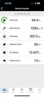

I do think the flickering is the auto dim as we notice it when we come in and out of dark areas on trails. Here's one for you - My Ride Command App will not pick up engine hours from the machine. They show fine on the display in the rig bit the app is stuck on 1 hour. Have logged in and out and no change.
My engine hours have been stuck at 20 for as long as I can remember. Nothing I have tried has made a difference, so I gave up worrying about it. If I want to know my hours, I just look at the gauge cluster.
All in all, I'm not impressed with the app, if it wasn't free right now, I wouldn't have it.
I sent a message to Polaris this morning. If I get a solution - I'll post. Thanks!
Same, my engine hours on the 7” screen and the app both say 0.8 hours. Well, I know it does in the app for sure.
Confirmed with Polaris customer service. There is a bug with the engine hours and the Ride Command mobile app that their development team is trying to resolve.
The engine hour problem has been known by Polaris for probably 6 months or longer......it doesn't appear they are actively "all over it"
