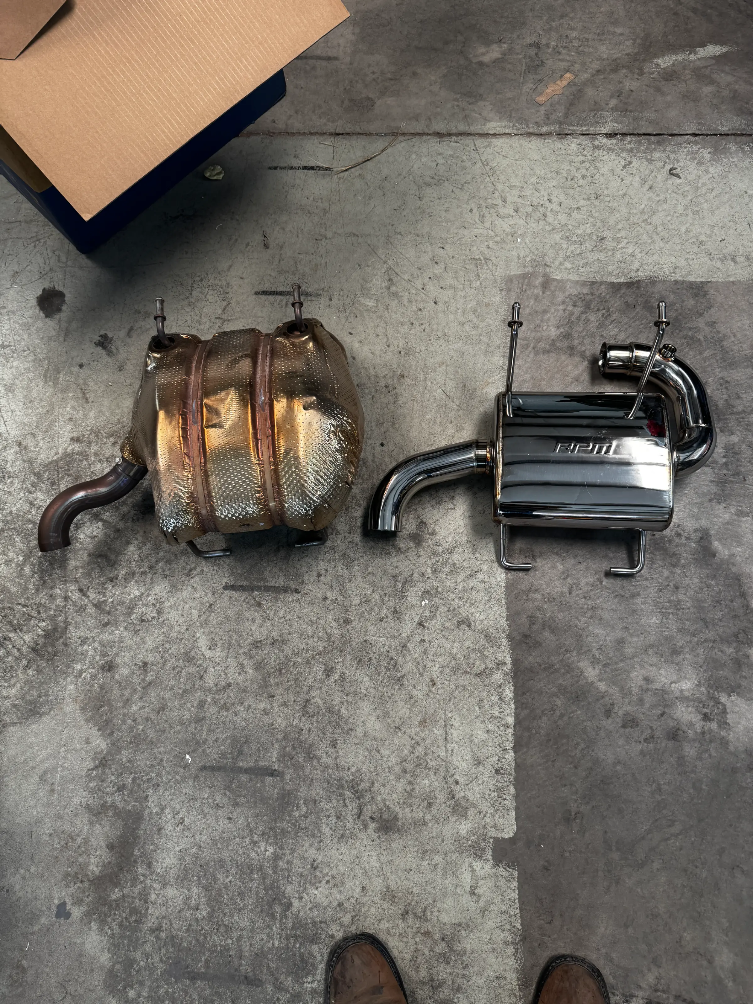

Ok… finally got to changing the muffler and header. It’s a fairly easy job, only takes about an hour to replace both. Could’ve been done in less but I wasn’t hurrying.

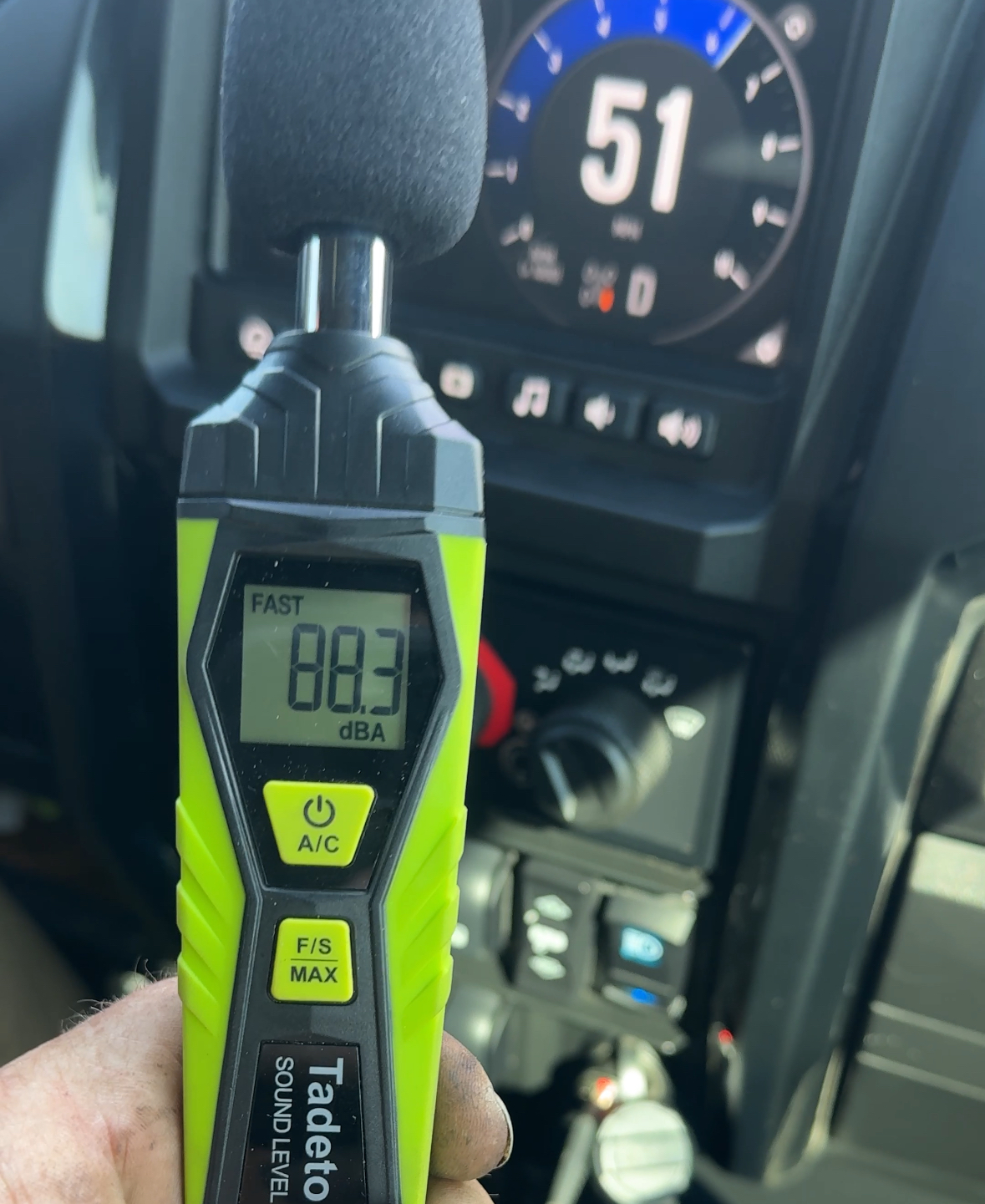

For the “before” decibel readings we had 92db at the rear by the exhaust and 81db in the cab between the driver and passenger.
After the RPM Sport Muffler and Header, we have a 10db gain to 102db at the rear (revving the engine). And a 7db gain in the cab between the driver and passenger.
All the noise tests were done at full rpm for maximum noise readings. The average db after installing the RPM Sport muffler and header were a couple db lower at normal trail speeds.
It’s definitely a much sportier sound with a deeper tone. I’m not sure when we’ll be taking it for a full ride, but we’ll have to see if it’s bothersome on a long ride.
Man, that is super pretty and really not a huge increase in noise. Would have been cool to do the same test the fella from AA done. 0 to 60 before the pipe and then after. But you gut feel is also worth a lot.. Be interesting to hear your feelings.
Thanks for the update. 7 and 10 db gain isn’t so bad. Also nice to see that the average db is lower while out doing normal trail riding. Curious to see your report after some serious driving

First of all, the new system looks great and I'm sure it sounds awesome. That said raising decibels by 7 and 10 respectably is a big deal. Decibels are not on a linear scale and a small increase makes a sizable difference. See the explanation below. In business anything above 85 db requires earplugs to prevent hearing loss.
A decibel (dB) is a unit of measurement for sound levels, also known as amplitude or volume. It is measured on a logarithmic scale, increasing exponentially. Every increase of 10 dB on the decibel scale is equal to a 10-fold increase in sound pressure level.
It’s definitely louder, but we could still hold a conversation without shouting. Considering that the 88 decibels is a little above what we’re able to get the Xpeditions down to with full sound dampening and insulation. We still need to get a spark arrestor for it, which will quiet it a little. Also, for anyone wanting the little more tone without as much noise levels, leaving the OEM manifold and only doing the muffler would be slightly quieter as well.
