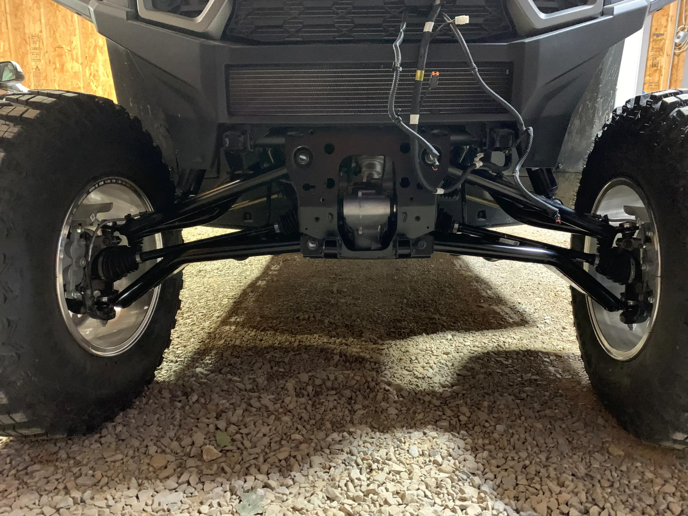

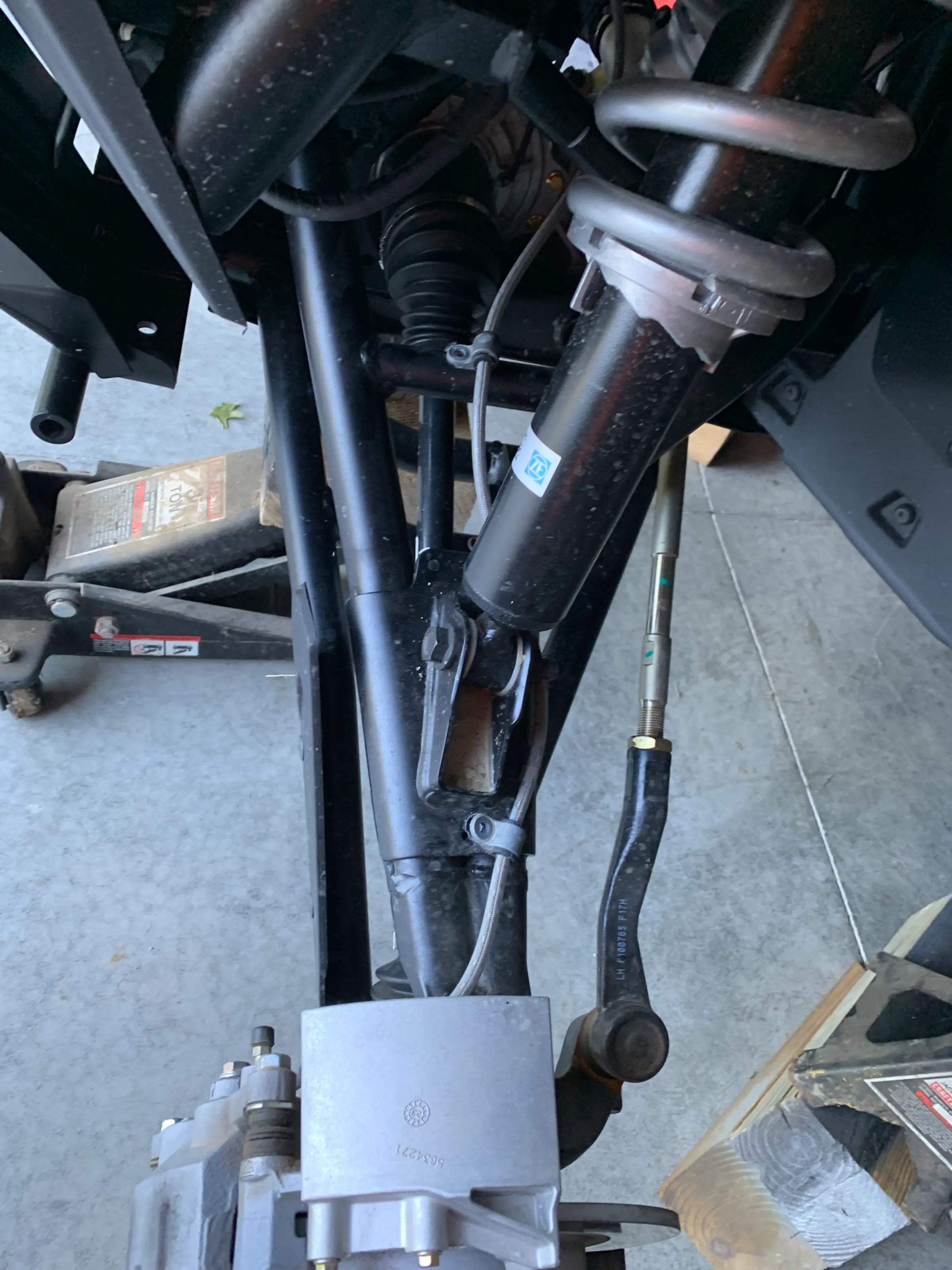

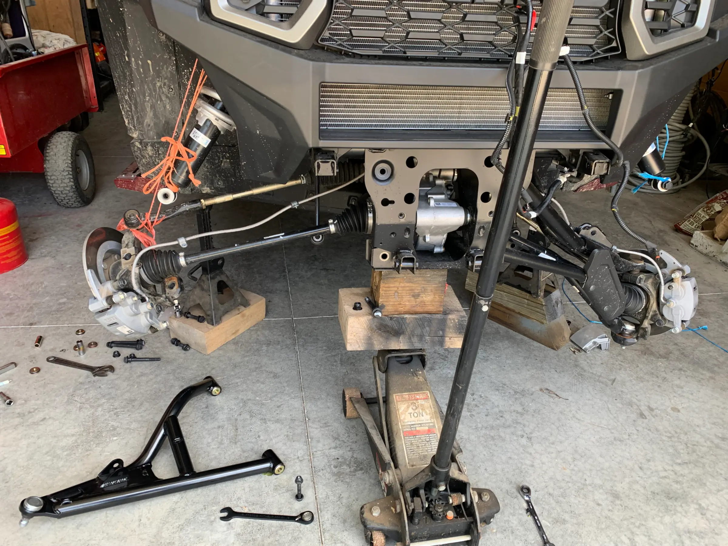

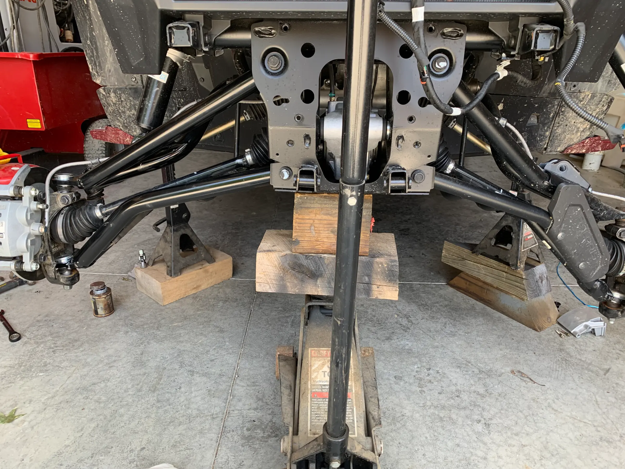

I purchased these out of necessity, my 35's rubbed hard. I had installed forward arms on two previous Rangers and never had any negative effects to CV jointer axles.
There are just a few brand choices for the 1500, I based my decision not on brand notoriety but solely on the materials they used to construct them.
S3 had no instructions written or online so probably not a task for beginners. If you do decide to take this on and do not have access to a press I I reccomended purchasing them with ball joints already installed.
It took me close to a day but I learned you have to remove the front bumper and winch to remove a couple of the pivot bolts, plus I don't get up off a creeper like I once did.
I knew I would have to realign it so I done it the old fashioned method and checked it measuring between to four foot straight edges held against the wheels. You have to adjust both sides to keep the steering wheel centered but I matched my previous measurements and drove perfectly.
These have been installed for six months now and the machine drives like a limo as before. I do not notice the 2" increase in the wheel base related to turning radius but I think it would have to.
Here are a few pictures

I agree with Clubin, thanks for sharing. Looking at your pictures you should invest in a Badlands Offroad Jack, they are excellent for our type of machine. Worth every penny IMHO.
Don't disagree but to say my old floor jack has lifted mucho stuff and those oak blocks are as solid as the concrete the jack is riding on.
I'm sure everything you have is everything you need, that's how I did it for years. That said I'm a little bit of a tool nut and can't resist the urge to upgrade when something new catches my eye, that's how I ended up with the Badlands. Walked by it in the store, saw it, touched it, had to have it.......my wife says I have a tool fetish, and I tend to agree with her.
