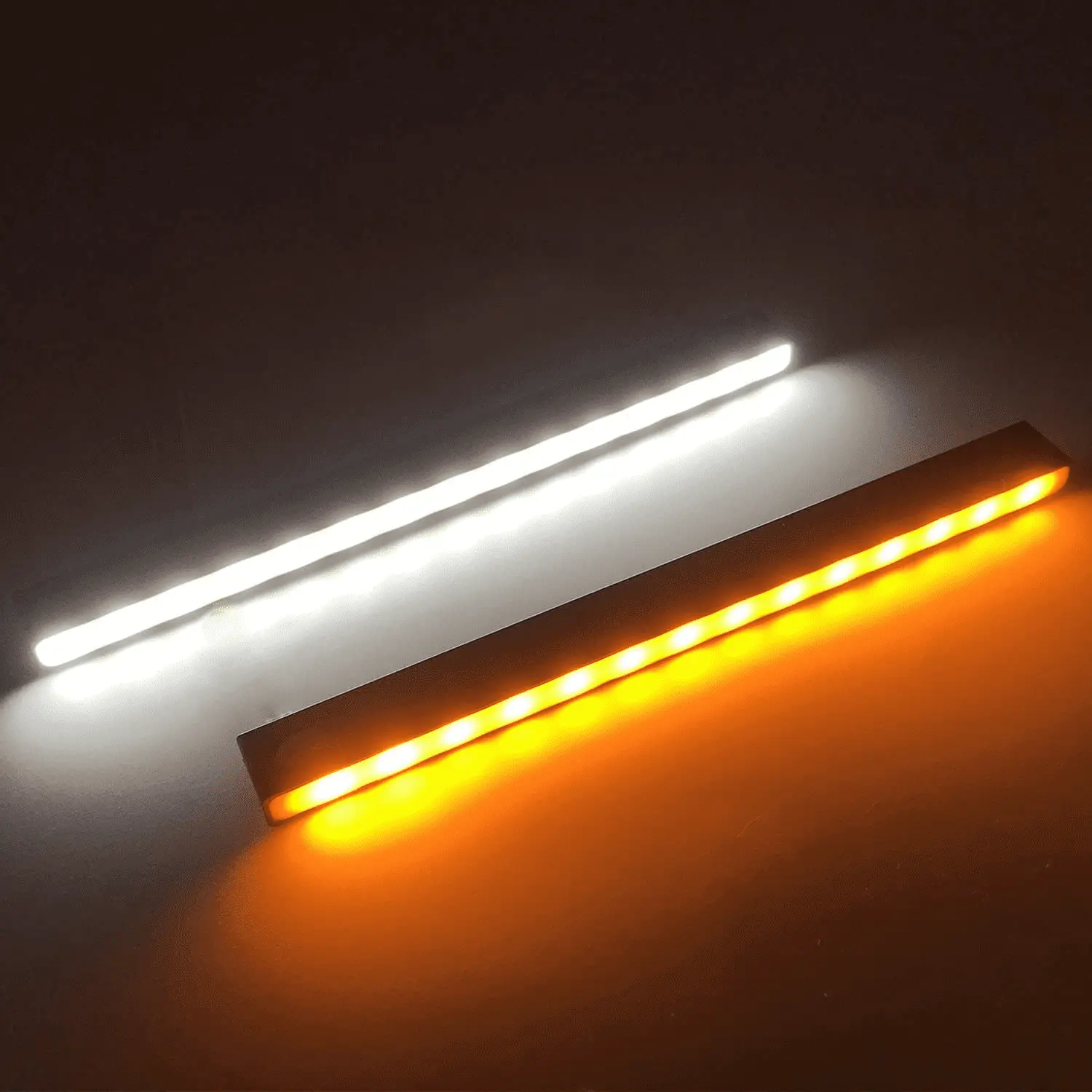

Thanks again for providing me with so much information and pictures, I really do appreciate you taking the time. The picture of the lever and the lights showing how they were installed is very helpful and helped me make my decision. I'm going to go with the Ryco kit as well but I have different plans for my front blinkers, I bought these off of Amazon a few weeks ago and plan to use them. They can also be used as a daytime running light and are sequential amber when they blink. They are 6" long, 1/4" tall and a 1/2" deep sealed in an aluminum housing and can be mounted with double sided tape. Current plan is to see how they look on the top of the front bumper.
Love that look! Let us all know how it goes! I might add those as well as the three I have, since my lights are blocked to some degree by brush guard.
Quick video of the turn signals mounted on the front bumper using 3M double sided tape. (don't use the shit they send with the lights) The lights measure 6" long X 1/2" wide X .3" tall. They come with about 3' of wire in a black harness. They are super easy to mount and wire. You can choose if you want to use them as running lights, turn signals, or both. If you only want one or the other just connect 2 wires, if you want both connect all 3. 1st video just running lights. The second video show what happens when you have a turn signal on.
Can you post the link off Amazon for these lights? Thanks.
Turn Signal Switch Fog Lights Assembly Universal Car Accessories Sequential Turn Signals 12V LED Light Strip for Daytime Running Lights, Night Running Light, White Amber Flashing LED Light Bar for Car​
Not sure the link is going to work but here is the description of the lights.
Thank you, the linked worked.
