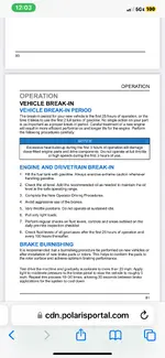

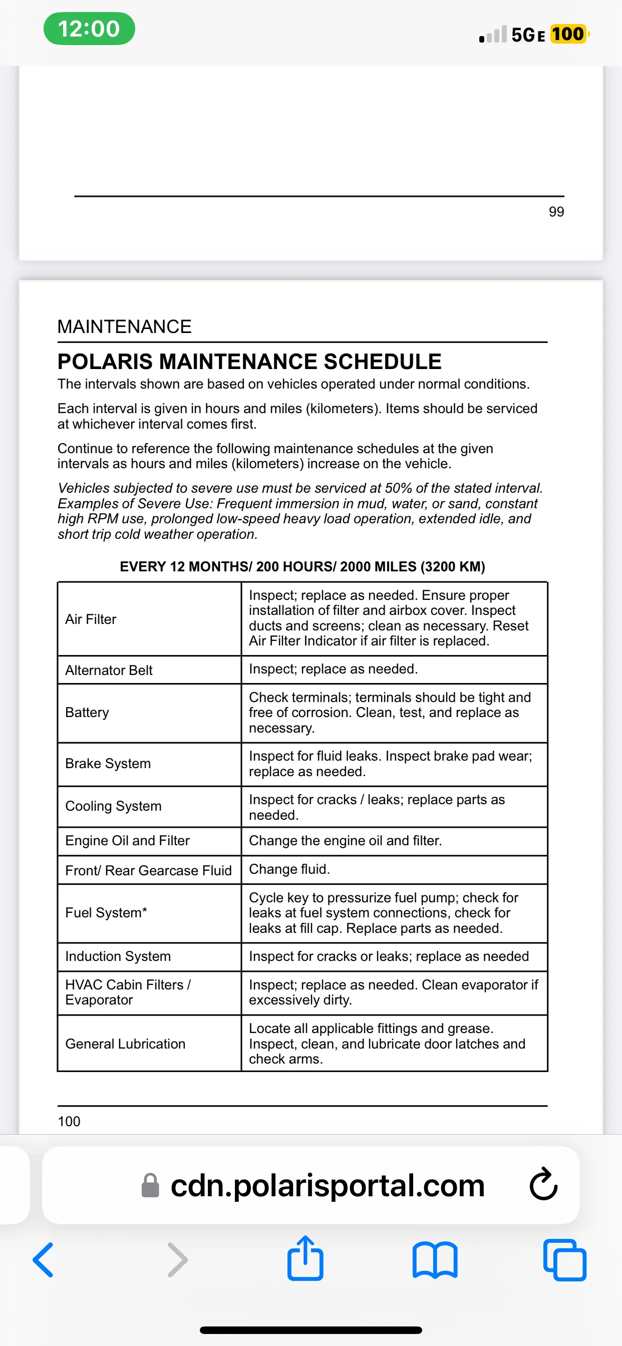

Looking for some guidance. When is the first maintenance ACTUALLY due in the XD1500 to protect MFG warranty. I can find nothing in the owners manual about changing oil at 25/50 hours-/ only checking fluids. I have attached three images here-- one is photo from app which states 25 hours. Other two are from owners manual which states 12 months, 2000 hours or 2000 miles.
Nowhere can I find a legitimate source stating break in service at 25 hours-- even Polaris own information is contradictory. Any guidance is helpful.

There is no need for the 25 hour break in oil change unless you want to. Technically and to follow the maintenance schedule and Polaris recommendations, you don’t need to change the oil until the 200 hour/2000 mile mark. I did have my oil, front and rear diffs changed at around 90 hours/900 miles. Just because that’s what I usually do with all new vehicles. Along with my air filters and plugs.
I did my first service at 800 miles because it was at the dealer for a Ride Command issue. As Mr.C said above 200 hrs. or 2000 miles is the recommended service interval, and I see no reason why that shouldn't be good enough for many of us. Now if you really work this thing you might want to reduce it to whatever you feel comfortable with.
